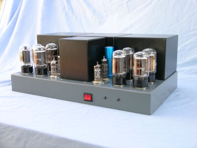

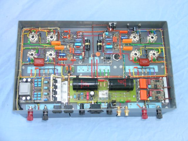

I've been here for a while but never posted something of my own, as far as the "Search" shows. One hesitates in the presence of so much excellent work (lately by Fishandchips), but here are views of one of my larger creations, a 100+100W power amplifier.

Thanks Anatoliy,
You 'scooped' me. I was still going to say: Per amplifier: 4 x 6L6GC, 1 x E182CC, 1 x ECF80, 1/2 x ECC85 (input buffer). Power anodes: 600V, all else: 500V regulated. Common power supply choke input, regulators one to each amplifier. Input 570mVrms. As seen regulators, delayed turn-on and safety circuits all semiconductors (silly to do otherwise - I am not that much tube-fanatic!)

Though it looks nice, I would suggest to think a little bit more of convection and radiation.
PS: ECF80 looks like mine 6F12P, E182CC like mine 6N6P, though I don't use input buffers.
Also, I use in both Pyramid-IV (4x6L6 per channel) and Pyramid-V (2xGU-50 per channel) I use regulated DC for filaments of preamp tubes. And "all else" regulated.

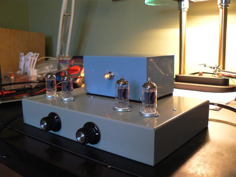

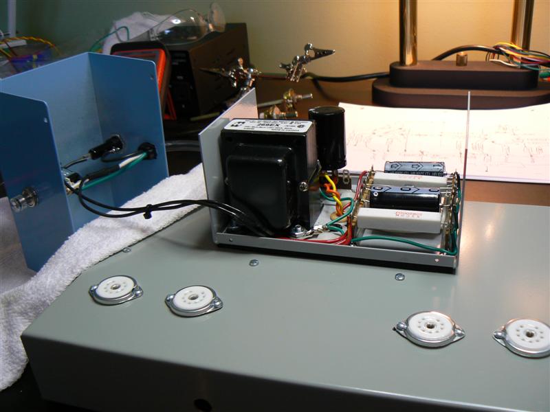

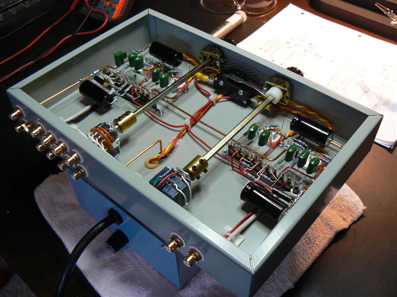

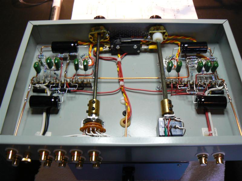

Here is a preamp I just completed. It has a separate PSU mounted on top, It's using all 12AX7's 2 for the phono stage and 2 for the line stage. I put a cam on the volume control that controls the HT so as soon as you start to turn it up the HT come's on. It was fun to build and sounds way better than I expected. I really sounds good.
mark02131 said:Here is a preamp I just completed. It has a separate PSU mounted on top, It's using all 12AX7's 2 for the phono stage and 2 for the line stage. I put a cam on the volume control that controls the HT so as soon as you start to turn it up the HT come's on. It was fun to build and sounds way better than I expected. I really sounds good.
Can you please post a schematic?
