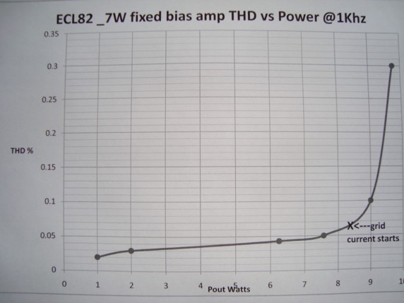

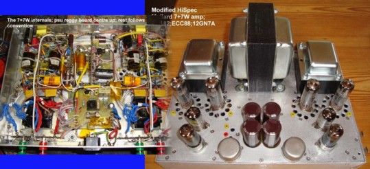

A modified Mullard 7+7W amp as a just completed as an early winter project. By todays standards the original Mullard design is a poor performer, and this one with different phasesplitter and front end tube totally outperforms the original by magnitudes. THD now 0.035% at 1KHz at 7W each channel with -3dB at 50KHz. hum& noise -80dB.
Tube line up,12GN7, ECC88 (sections parallelled as concertina) and ECL82's, the triode section of the pentode dumped.
Since I've got several obscure 12GN7's these TV video pentodes were once up-market 12BY7 replacements and have excellent linearity.
With a B+ of only 270V, this amp offers brilliant easy listening.
The main distortion reduction is in the o/p stage. Fixed bias is used and 43% UL taps instead of 20%. With 20% taps, thd doubles. For those wanting to build this, note the ECL82 pentode grids will require distortionless drive capable of 15+15V rms. This is considerably higher when compared for an EL84.
richy

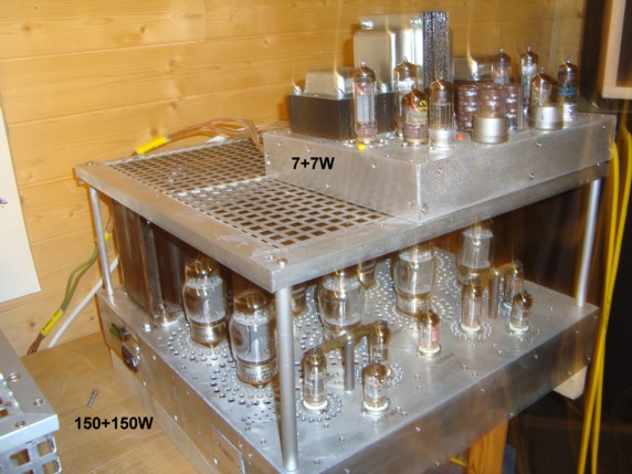

Adamus, I'd bet your'e finding your little (EL84) amp sounds loud,as mine does. Put the 7+7 Watter up on top of the 150+150 main frame amp as shown in pic, these small amps are way more value for money. The log power scale puts the big ones at a massive disadvantage as also the ridiculous weight for an Altlas man. 5kg instead of 65 kg.
The ECL82 pentode is nice and tame to work with, the triode couldn't be more performance miserable, so I dumped this bit...
I expected the sound quality of the 7+7 Watter to be bit' lower than the 150+150W beast; No so.
I can recommend small amps for anyone.

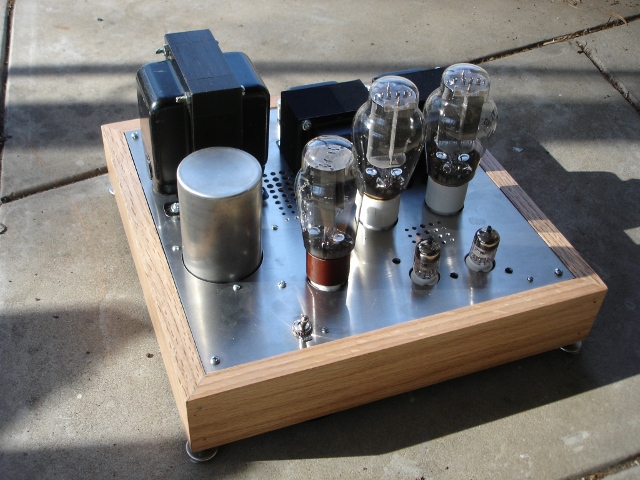

Here is my finally complete tubelab 300b amp. Finished the amp a year ago. Finally got a nice drill press last week, and finished the chassis last night! Turned out better than I had hoped.

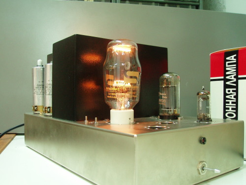

My SV811-3
my SV811-3 DHT SE amp almost ready 😉
more details here : http://sarris.info/main/811a-single-ended-triode-power-amp
costas
costas
Thank you for posting. Looks good!wicked1 said:
Which rectifier tube are you using and when measuring bias (through those holes), are you using some kind of contact plugs?
Also, any pictures of those tubes glowing? 😉
Thanks! I'm so happy with it!
Rectifier is a 5u4g from aes. My hammond power tx just puts out way too much juice. I tried various tweaks to the circuit (smaller input cap, larger choke) and it still didn't bring the voltage down enough. I popped that 5u4g in there and it solved my voltage problem, as well as looking great.
Bias test points. The bare metal holes are screw holes for the bias adjust. The 4 black test points behind the power tubes (you can see 1 and 1/2 of them in that pic) are where I test the bias. I haven't tested it yet since I assembled it. I'm guessing I can just stick the ends of my multi-meter probes in them. There looks to be enough clearance around everything that I wont accidentally make any shorts.
Glowing tubes? Hopefully tonight! I finished the chassis assembly Saturday night, and when I snapped that photo Sunday morning, the wiring wasn't complete. I finished the wiring Sunday night. Had a busy day yesterday, and didn't want to take the chance of the first power up. SO, today. This should be the day for the glowing tube photo.. and I'll snap one of the under side while I'm at it, now that the wiring is complete.
I don't foresee any trouble w/ power up today. I have been using the amp for about a year.. it's just been all spread out on a plank of wood. So, basically just had to reconnect all the tx's in this new chassis.
wicked1 said:I'm guessing I can just stick the ends of my multi-meter probes in them. There looks to be enough clearance around everything that I wont accidentally make any shorts.
A pair of these panel mount plugs per each channel (+ and - test probe for each lead of R18 and R29) will make it much easier.
Those are what I have on my test points! (except round ones, not hex on top)
Look right between the 300b's You can see a small black circle. That's one of the test jacks.
From the position of that photo, you can't really tell those are 3d test jacks and not just holes.

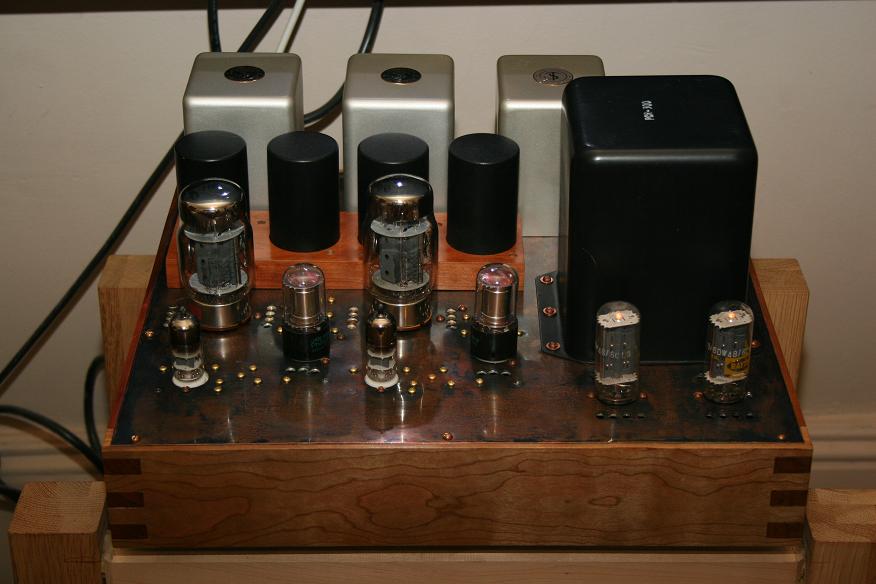

JoshK said:Finally have something to share. My first ever tube amp is complete.
It was actually done a bit over a week ago but couldn't find my camera's battery charger.
Still have a tiny bit of hum, but I think I know why.
Josh,
Looks great. Well thought out layout. Didn't put the rectifier tubes on top of the input stages. 😉 Good going using two damper diodes, a superior setup to the overpriced 5AR4, IMO. I see two VR-tubes. Are they wired in between the KT-88 plate and screen grids so you can run the tube triode mode at decent plate voltages, or is this a G2 regulator and the tube is wired pentode mode?
What is the top deck plate made out of?
Thanks. This is Pete Millett's SE KT88 E-linear amp. I used his layout so I can't take credit. The VR tubes are for the D3A's G2. The KT88's are wired for UL and then plate to plate feedback is done from the UL taps back to the input stage.
The amp sounds great, despite a little residual hum left to track down. I am reasonably certain it is the AC heaters. Couple tricks left to try there.
The top plate is patina'd copper epoxied to a thicker piece of aluminum.
