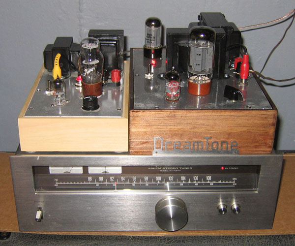

Thanks Bob,
With your comment, I got courage to post what is inside the amp.
The kit included everything from tubes, trannies, chassis to cable ties. The only thing I missed was an assembly instruction. There was only one page of the circuit schematic. On the other hand, I learned a lot about laying out the components according to the circuit diagram.
There was a mistake in shippment of the front panel. I received a new one and for apology the shop sent an input relay circuit for free. The relays seem to protect the amplifier.

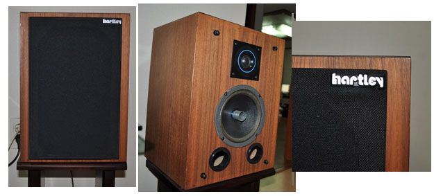

hunim...the speakers in the last picture looks good.What is?
cervelorider...very nice and neat design.Could you post another picture with the back?
Thx.
Thx.
It is a "Hartley Compact Reference"
Dear Felix,
The speakers are by Hartley. Hartley used to make loudspeakers with super woofers. I remember that the membranes were not made of paper. Anyway, my speaker is the smallest model in their product line.
I could not find any information about Hartley loudspeakers in Internet.
I bought it 17 years ago. When I bought the loudspeaker, the ownder of the shop lived in the same apartment that I lived and I had 20% discount. It still sounds nicely. I like the sound resolution of Hartley Compact Reference. Finally the loudspeaker found a new partner. (Matches well wiith the vacuum tube amplifier)

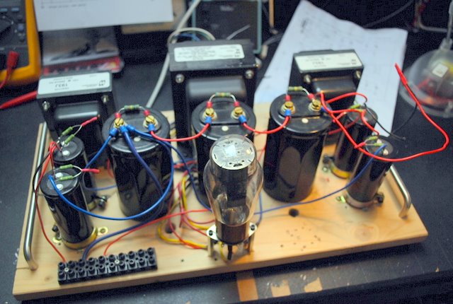

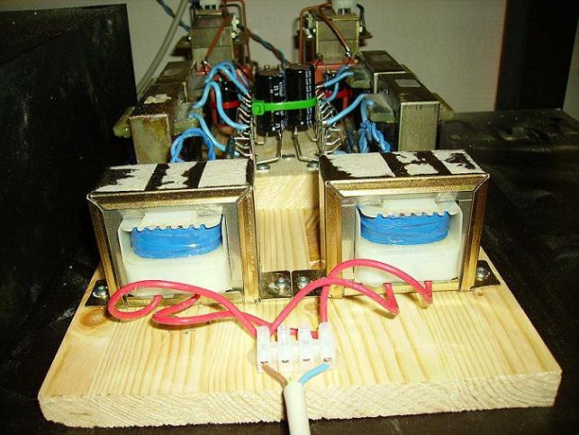

And finally some info on what´s on those breadboards:
25k stepped attenuator
Triode wired E280F input stages with Lundahl plate chokes
Sovtek 6B4G output tubes with Lundahl LL1664/60mA OPTs
LeClanché PiOs for coupling and decoupling
6AU4GTA rectifiers for the output stage HT (CLCLC filtered)
6X5G rectifier for the input stage (CLCRC filtered)
Fixed bias (to avoid cathode decoupling caps)
DC heated input tubes (CRCRC filtered)
DC heated output tubes (LCLCL filtered with 25mH in first and second position, 112mH on output)
100% functionalism, 0% esthetics...

Re: Probably my ugliest amp ever...
looks a bit my power supply for the "big" amp....

Fuling said:As if the monstruosity shown in the previous post wasn´t enough, here´s the LCLCL filament supply:
Boatanchor amp! Respect! Very low WAF, I suppose?

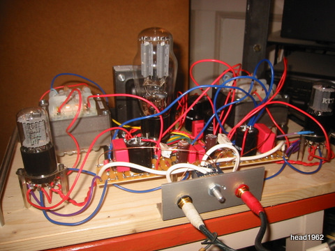

or the very first 6EM7.....
they look a lot better now.

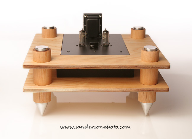

Re: Bricks and Boards as chassis.
Great Ideas, all. I wish I had thought of that. Next project is a tube pre-amp kit that came without any chassis, just the rack mount face plate. I will endeavor to use as much cast off building material as I can ... 😀
(Is there a contest for the ugliest amp?)

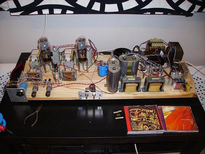

My PP EL34 & ECC85. Penthod, triod and UL modes.
2 channels PS /black box on the left side/- CLCLCRC.
