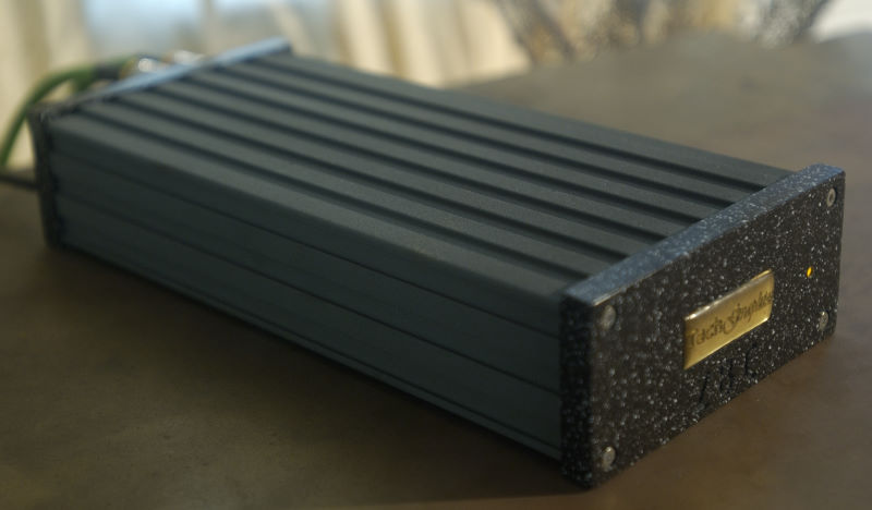

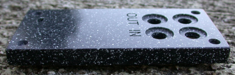

A new tubestage, just to had something to do:
Front and back are CNC-milled from black "stone".
PCB for the powersupply is CNC too.
Tube Philips JAN6189W, resistors Allan Bradley.
The amplifier itself is build so compact that only 10cm of silverwire was used.
And it works fine!!
Kees

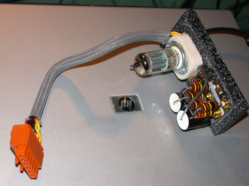

The supply PCB:

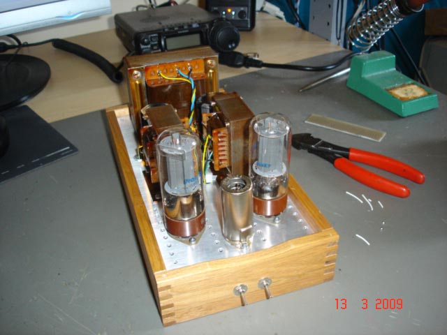

Hallo to all tubebuilders!
This is my first post on diyaudio, and this is my second brand new amplifier!
technical data: SE, UL, 6L6WGB, 250V, total reservoir capacitance 1400uF R-C smoothing filter , 180ohm cathode resistor (for -14V autobias), 2,5K OPT, coupling capacitors MKT, 12AX7 driver, 22K NFB (light), star grounding at the screw of 12AX7 noval socket, wooden box from IKEA (p/n 600.512.99 - 3.00 euros).
possitve impressions: powerfull for domestic use, pleasant, excellent mids, nice lows, nice looking (?), compact size.
negative impressions: some 100Hz noise (choke is necessary for up to 1400uF - at least), strange highs, absolutely dangerous constraction! purelly Electroshocked!

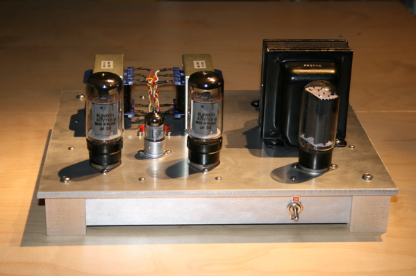

I just finished a SE amp based on Mikael Abdellah's KT88 design.
I am using Sovtek 6L6WXT+ at 60 mA into Edcor GXSE 15-6-5k output
transformers. I added a cathode bias trim for each tube by putting
470 ohms in parallel with a 2W 200 ohm potentiometer. The testpoints
are across 1 ohm to measure the current.
It is selectable between anode and UL, although I have found myself
enjoying the UL more at the moment.
This was made entirely with (cheap) hand tools.
