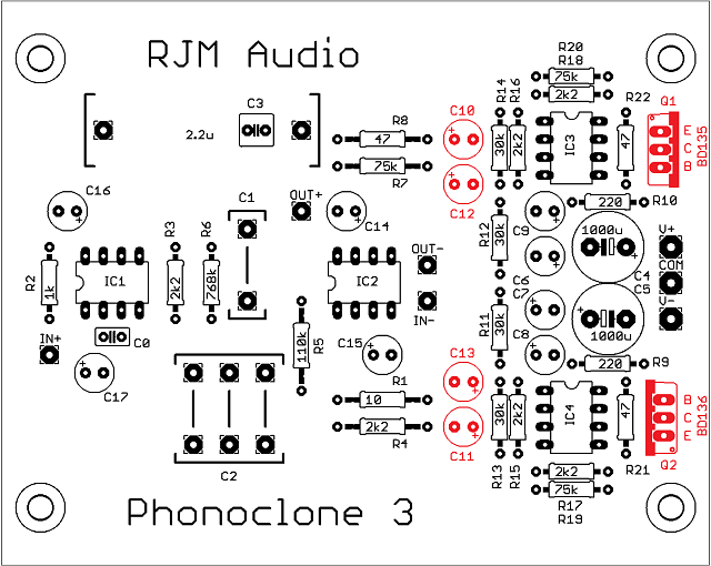

rhys never posted the BOM afaik, despite repeated promises.
Although fran put together the original BOM that rhys based his on in post 99, (http://www.diyaudio.com/forums/showthread.php?postid=1706522#post1706522) there have been quite a few changes made in the parts values since then.
It also doesn't help that the part numbers are not printed on rhys boards.
The best bet is to work from the attached image, and if you could please print that image and send it with the kits so people are reminded of the error on the board layout with the C10-13 and Q1,Q2 shown reversed I'd be very grateful. (the image shows the correct orientation)

Good Day Gents,
I have got my boards up, and appear to be running and generating AC with some signal going through them. I have not hooked up TT yet, as MC cart is still on it's way.
My question is, I am putting these in a single chassis, which I think is large enough to not be an issue with noise. The GND holes dont appear on this PCB (like in construction guide, so I am wondering how to ground the whole thing. Binding post to chassis, and IEC GND to chassis? Or can I run the GND binding post to COM between both diodes, and run another wire there to ground. (This would appear to me to have less loop potential.)
The current shipping phonclone boards don't have the GND "feature" implemented yet. So the connection can be made to any point on the COM wire. In a single chassis build, the COM between both diodes would seem the most sensible. The IEC earth also connects to the chassis, but there are some workarounds with that if you find it causes hum.
