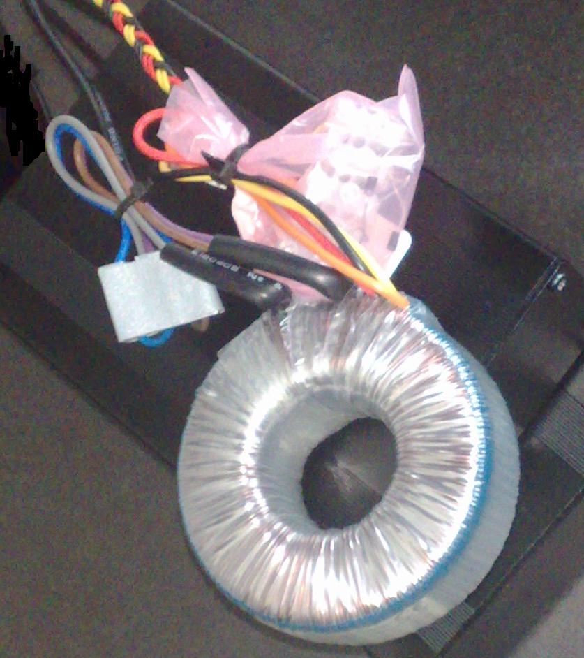

Hello everybody.
This is my first post, please excuse me for my english.
I've completed my PC3 and in this first post I would like to thanks Rjm for the project and all of you for all the informations shared here.
Until this morning everything worked well, and I was thinking to post here the photos and my first impressions about the sound.
But... this morning I've found the PSU very, very hot, with a smell of plastic. Immediately I've disconnected the power but too late: the two toroidal were burned ( the primaries,tested with the multimeter, are in short circuit )!
All the plastic fast-on inside were completly melted!
I really don't understand how this could be happened: I.ve checked all the connections many times:
IEC L -->switch ->primary +
IEC N --> primary -;
The secondaries go to the bridges, all the connections checked for + and -.
I listened for two days without any problem ( no hum, no noise, just a radio in the background , great sound!).
Maybe I've connected the IEC/switch/neon in a wrong way? I've done like this:
IEC+ --> switch out 1
Primary+ --> switch out 2
IEC- -->Primary -
Any idea, advice, explanation before I try with other toroids?
Thank you very much to all.
G.

No fuse on the AC line? That's poor technique.
Still, it's pretty hard to imagine hooking up the power transformer incorrectly and still having the phonoclone work properly so I'm willing to give you the benefit of the doubt and believe you when you say you checked everything.
Perhaps you should post photos anyway. I think it would be instructive. Seeing the area around the power transformer would tell me more about what could have gone wrong.
Possibilties:
- Transformer was damaged / faulty.
- Poor soldering or crossed wires shorted the power rail (V++ or V--) to ground.

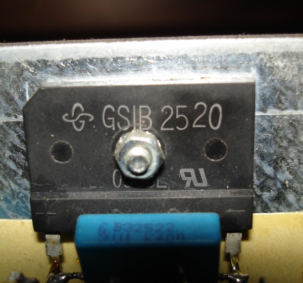

Thanks, Rjm, for the answer.
Well, I'm just a beginner ( this is my third project after another pre-phono and an mc step-up), but the fuse was there: I've used a IEC/fuse/switch (with neon lamp ).
The fuse is still working ( but I've seen that it's a rapid 1A), so the switch.
The toroids were mounted in this way:
- skrew througth the base of the box ( alluminium hammond )
- a sheet of thermal insulation
- the first round metal cover of the transformer with his insulation
- at the top of the toroid the insulation then the second metal cover
- after the bolts, a second sheet of thermal insulation
No contact between the base and the top of the box.
I've soldered the rectifier bridges and the secondary, every contact was covered with a thermal-shrink.
I'll take some photos today.
I don't know if the phonoclone is damaged. How can I test this without connect a power source?
Thank you for the help
Giuseppe

I've taken some photos of the psu and the PC3, trying to show also how the parts had been mounted inside the box, how the primaries connect to the switch and so on.
You'll find also a picture of the procuct I use to insualte.
I hope that someone could explain me what is wrong.
Thank you very much
Giuseppe

some suggestions:
working on assembling a power supply with mains voltage and fuses in the mains power line is responsible work and needs to be done very thoroughly
solder work/skills need to be improved, an altenative may be using screw connections for the power supply assembly
use 1 transformer and 1 rectifier bridge to simplify the assembly of the power supply (there are most likely only very few that could hear the difference in audio performance)
I don't want to be blunt, but safety is very important !!!!

GiusB said:The toroids were mounted in this way:
Giuseppe [/B]
Giuseppe don't use all that isolation and two round metal cover..
1) remove the lower sheet of thermal isolation
(toroid need all of the box metal to remove heat)
2) remove the lower round metal cover
3) remove second sheet of thermal insolation (as 1)
... like this
- the first round insolation
- at the top of the toroid the insolation
- the second metal cover
- the bolts
4) 4xbridge also need a skrew for contact to alluminium in the box for cooling.
because of the very low power usage of the PC3 heat should be no issue inside the power supply housing
In my own PC3 power supply I cannot detect any part that is hotter then the room temperature
I run the PC3 24/7 (until I will be able to have it automaticaly switched by the end amplifier)
I just forget switching it off all the time
The heat issue that caused the malfunction must have a wring/connection issue as cause

I wonder if the ends of the bolts holding the transformers touched the lid of the case when closed? That seems the most likely explanation for what happened.
The photos show a power supply that is cramped but while its not the neatest soldering, it seems otherwise satisfactory.
Note: if going dual mono, either build two identical power supplies ... or use a bigger base than the 1590D.

Ok, I'll do this way. I used the insulation not only for thermal problems but to avoid contacts between the case and the toroids. My fault.
About the screw for the bridges, I really didn't know. Can you please show me how I can do this safety? Thanks.
@rjm:
No, I'm sure because I put a second sheet of insulation between the top and the transformers ( you can see it in the photos ).
You're right, not too space. May be the problem?? I've seen other PSU cramped more than this. Anyway I'll start putting just one transformer in the same case, to see. Thank you.
So, the mystery remain: it worked for two days, and it was cold ( I've touched the psu before go to sleep ). In the morning it was fused. I think that some contacts became instable because of the poor space, but I've re-checked anything and I can't see any fault.
On the other hand it's just no possible that I took two faulty transformers in one shot!

And no, normally you don't get two toroids with fault.. but this fault - I can't see it.
The lower round metal cover: The only I found (as rjm) was that toroids don't like steel/iron 'very close' and all around it - together with the bolt in the center this can works like another 'secondary'.
Normally the Phonoclone not draw lot of power, so if you don't connect the Phonoclone to the PSU, you can check if the PSU warm up without anything connected.
And now One hand in the pocket
Don't ever do this with mains on. Let the PSU run some time, then remove the mains - off and remove cable. With the other hand, you can feel if toroid get very warm or a bridge..
Temp. is after some time between room temperature and your own finger temp.
Attach: Image for bridge. Another type I use, but use it the same way as with toroid - the center and small bolt + nut for yours bridges.
