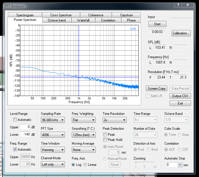

24-96 recording of the phonoclone output noise. It is recorded at unity gain, with the DL103 connected to the input. The phonoclone gain is 58 dB. No, you aren't supposed to listen to it, but feed it into your favorite analysis software to pop out a power spectrum to compare against other phono stages, your build of the phonoclone, etc.

The dB scale of the Fourier power spectrum plugin in Audacity is referenced to 0.05 Vrms = 0 dB
Conventionally it is referenced to 1 V rms = 0 dB.
This means that the dB data in Audacity is shifted up by 26 dB compared to most other software.
Attached is the phonoclone noise data, linked above, plotted using the conventional reference. The measurement threshold is about -120 dB.
The noise at 1 kHz is -103 dB. Input refered, gain = 58 dB, is -161 dB. The datasheet noise for the op27 is -167 dB. That these numbers match, with the measured figure slightly higher, tells us that everything is ticking over as it should.

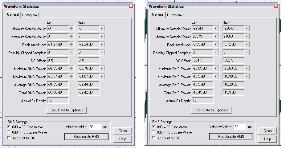

MJL21193 said:What are you using to measure? I have just recently finished a phono preamp of my own design and I've gone through much and many board revisions to reduce noise. I'm using Adobe Audition to do the recording measurements.
Two remarks.
First, to make level referencing easier it is useful to record a commonly available reference signal, like the 300Hz 0dB track of the HFN test record, and then refer the noise floor to it.
The actual measurement is easy to do in Audition. First reduce the sample rate to 44k1, thus limiting the bandwidth to 20kHz (which is standard for measurements). Then select a few seconds of reference track, and do Analyse > Statistics. Note the average RMS over that segment. Then to the same for a segment of noise. The difference between the results is a good measure for the unweighted signal to noise ratio, provided the reference track corresponded to 7cm/s lateral 0dB LP level.
If you want to have it weighted you first have to apply the weighting filter(s) to the noise segment.
Hi Werner,
A good tip, thanks. 🙂
I did this, results attached. First window is with input to the preamp grounded. The second is with a track playing. Record level is unchanged.
Richard and I have been discussing this outside this thread and I don't want to clutter this thread up with my work, so I won't post anymore about mine, but feel free to PM me if you have any comments.
