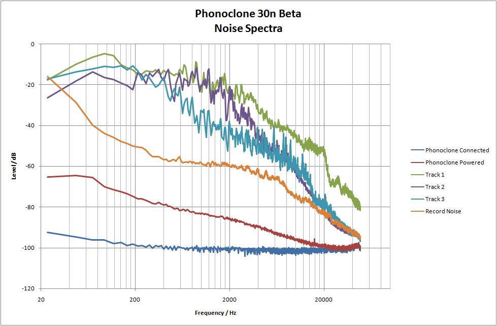

More noise data. It's boring, but I wanted to double check everything.
- Powered, the output noise of the phonoclone is clean and falls into the measurement noise floor above 25 kHz.
- Track 1 is Nights on Broadway. Everywhere on that track measures the same, and I've repeated the measurement on several occasions: high frequency content is 20 dB more than typical. Another track on the same side of the album, labeled Track 2, shows "normal" behavior, with little content above 25 kHz, pretty much just the record noise. Track 3, from another album, confirms this result. Conlclusion: My analog rig is well-behaved at ultrasonic frequencies, Track 1 is an anomaly.
- Record noise varies according to the quality of the record surface, but the result shown is fairly typical for a moderately noisy LP. In every case where I've measured it, it's well above the noise of the phonoclone.

rjm said:More noise data. It's boring, but I wanted to double check everything.
Hi rjm,
Nice work

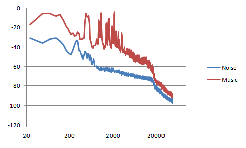

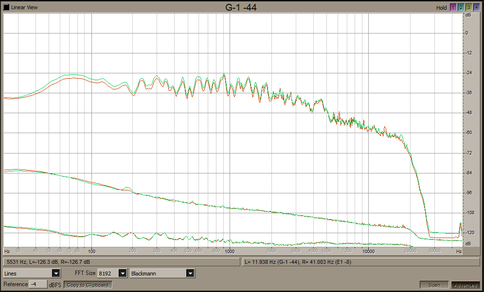

What are you using to measure? I have just recently finished a phono preamp of my own design and I've gone through much and many board revisions to reduce noise. I'm using Adobe Audition to do the recording measurements.
Attached below are the results for mine. The preamp is connected to my computer sound card line in (X-Fi Xtreme). The record level in the Windows volume control panel is set to about 60% for all three tests. Bottom traces are recorded noise with the preamp connected but not powered. Middle traces are with the preamp powered and the inputs shorted.
The top trace is with a record track playing ( "Chiquitita" by ABBA of all things 🙄 ).
I don't have a good reference for these measurements, nothing to compare until I saw yours posted. I'm encouraged to see that I'm on the right track.
