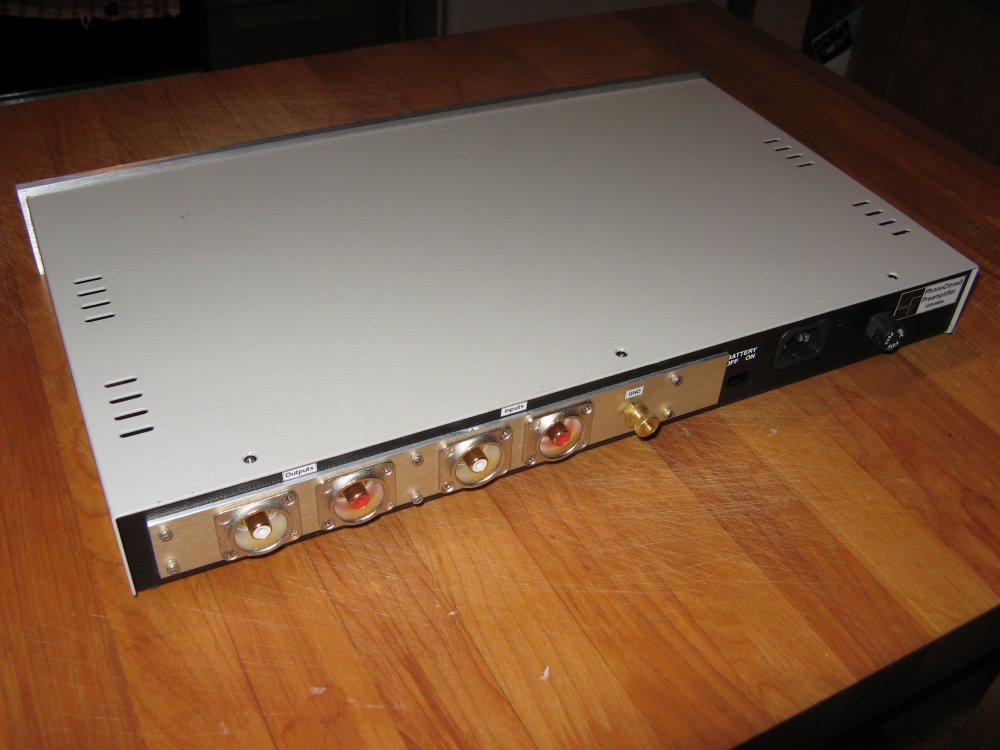

Impressive case Sylvain. The inevitable question: how did you do teh logo on the front panel?

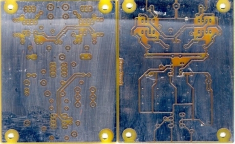

PCBs look great... how are you making these and getting the 2 planes lined up exactly?

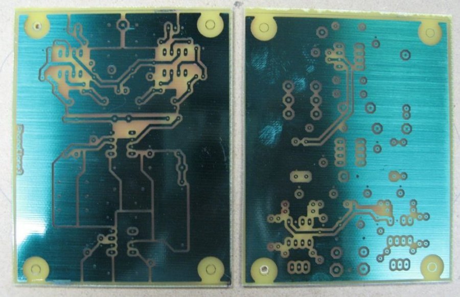

Hi woodturner-fran. Reguarding the PCB, it is really easy. I used presentation transparency sheet where I print the PCB image, top and back. Then I aligned both film layers very precisely and keep them in place using a piece of scotch tape. I insert the PCB material behind the two films and expose both side one after an other. Just devellop and etch it. Voilà instant PCB. IT takes me about one hour to get the complete PCB.
I wrote a two parts article on home made PCB into Bas Horneman DIY magazine. I can send you a copy. The file are big however with a lot of pictures. Or maybe ask Bas for his magazine.
Here the PCB platted, ready for drilling.
