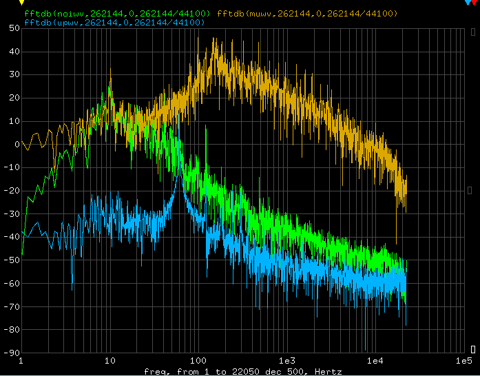

Here's another one, orange is the CSO at full tilt (~27000/32767 peaks),
green is the lead out groove, and blue is the tone arm lifted. Notice the 10Hz tonearn resonance and how there are sidebands with high groove modulation. The 60Hz on the blue is from my "manual" lifter. The LP is an RCA .5 series half speed remaster and the quality is pretty good. BTW the tool is our in-house software.

Thanks Scott. So are we seeing about 55dB average above the groove noise? That's pretty good. And the noise of a blank groove about 20dB higher than idle. Am I reading that right?

I would eyeball about 15dB right at the center of the A-weighting curve more or less. The preamp noise in this case is pure coil resistance based (400 Ohms). Our in house FFT size limit goes beyond even Labview's. I might even be able to do and entire LP side at 44.1/24.

Salas: Very Interesting. Can your FFT-based analyser do a true (ie integrated), 20-20kHz single figure unweighted SNR measurement while the stylus is in the lead out groove or playing a non-modulated test record ? Would be still more interesting. . .
It can, but I have to set it up again. But look at the graphs, its there to extract. Running a -6.7dB peak signal its almost 1V RMS on 2VRMS 0dB chart for good THD on a +12dB track (can play a +16dB track without audible mis-tracking too). At 20Hz, which is worst case given the Riaa shape and phono gain, its jfet head amp's 1/f etc, it reads -76.3dB. Here is your circa 70dB SNR that SY talked about. And it gets progressively much better to the right. Those FFTs had no weighing filter. That 20Hz figure reads the same on the 300Hz groove and on lead out as you can see.

They are all in storage. I though it would be interesting to show a reasonably (very) good sounding vinyl experience vs. a measurement. Yes, the Chicago Symphony Orchestra playing Wagner, lots of kettle drums and horns. The noise on quiet passages is very unobtrusive and here the SNR would be, by measurement, pretty bad. I could give it a try.
If we think that typical, yet dynamic disc can hit +6dB, not +12 to +16dB as the unused heavy virgin vinyl test disc I used, with more surface noise also, then 60dB maybe the average.
