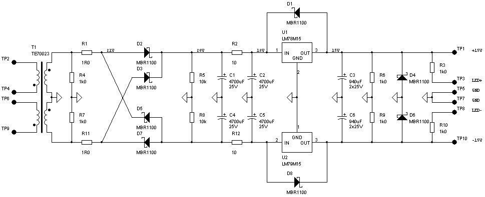

Can some one specify a suitable 15V supply for this project ? Can we use the supply designed for Bugle phono stage (http://www.hagtech.com/pdf/powersupply.pdf) ?

I'm gonna make you work. Look up the current for your opamps, then the current used by the feedback and load resistors for a full rail voltage across them. Add in whatever panel LEDs and such you might have. My guess is it's way less than an amp. Then use the above advice and use the adjustable regulators. They're truly much better. Unless you have some odd discharge risk, you can eliminate the protection diodes in the schematic above. There are a couple power supply utilities you can search for- makes selecting a transformer and such much easier.

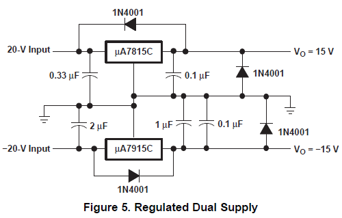

I have found a +/-15V power supply application diagram using TI's uA7815 positive voltage regulators (http://focus.ti.com/lit/ds/symlink/ua7805.pdf). It seems pretty simple with around 1.5A current capability. I am having few of them readily available with me. Please comment.

That's the generic fixed supply you'll find everywhere. It should work fine, but you can do a little better if you're willing to add the few resistors needed to use adjustable regulators. There's no requirement for the + and - to be exactly equal, and you may set the adjustable regs to the same voltage as the fixed regs, but the adjustable parts are usually lower in noise and have better specs, especially if you bypass the adjustment pins with some capacitance.
