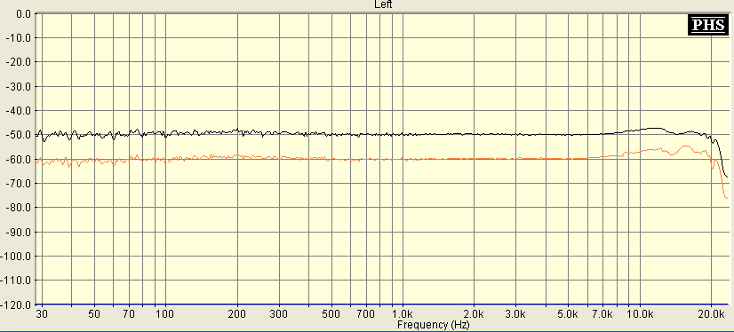

interesting hat they have cut that with a steep 20kHz filter. The pink noise track on the Phönix is more bumpy so there seems no agreement on even a simple pink noise signal.
I asume that they took a signal from a CD ( Image ) to record this. Bad boys !!!!!!
The other expanation whould be that they used a AD-DA chain for sensing the groove width. Even worse !!!!!!

I believe I can further see in your first graph 65dB at 20Hz relative to 1kHz playback peak and 90dB relative to empty groove playback at 1kHz. All in all quite near to my results. Must just be differences in records surface noise. The head amps prove more than adequate, no more noise wars significantly relative after the rock hits the plastic.

48kHz 24bit octave scaled (maybe 1/48 can't remember) for the DL103R on the HFNRR's pink stereo band. They cut it there too, but our measuring card's sampling filter kicks in also.
