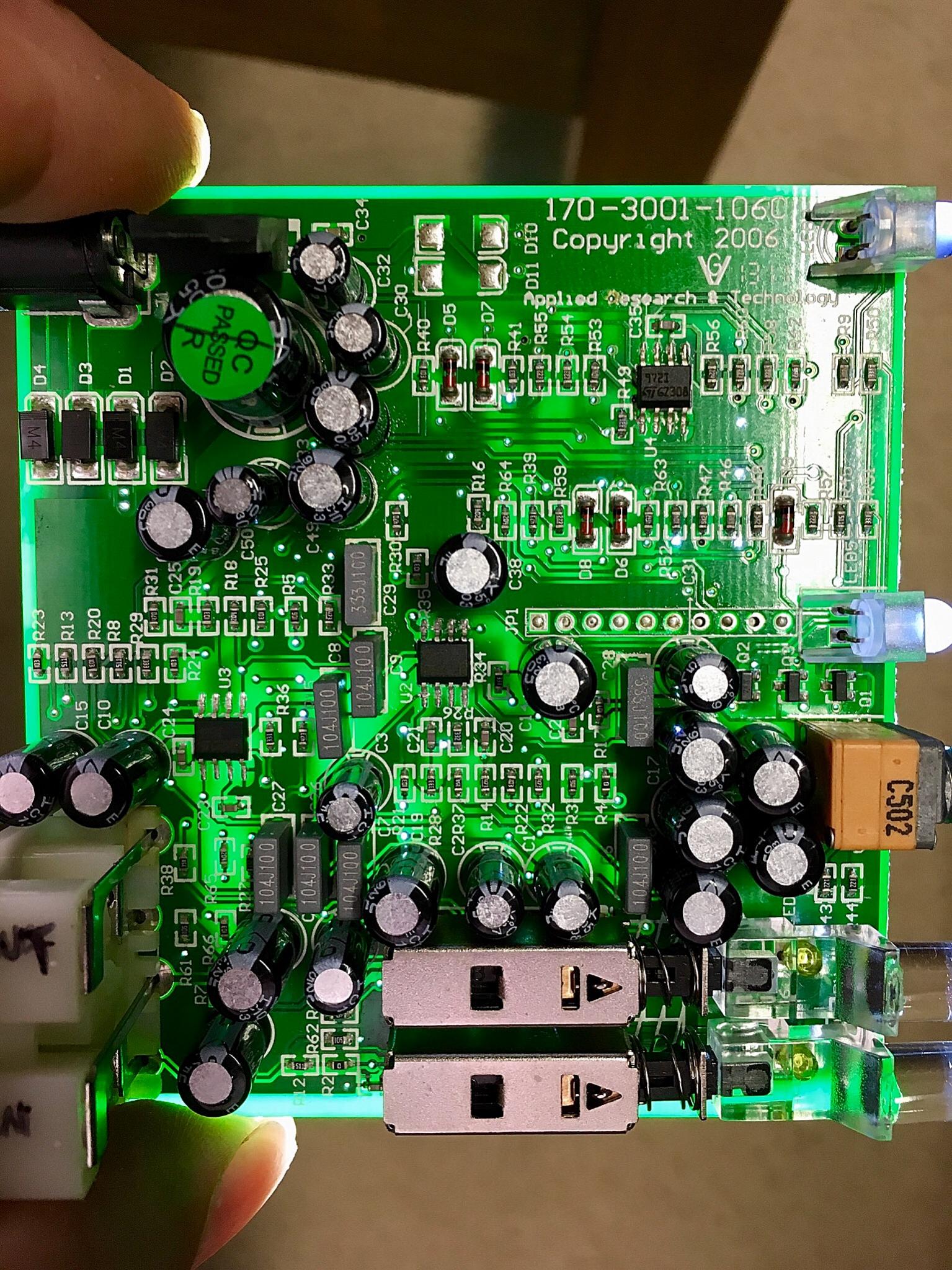

I'm sorry, I have given it a try, but there is too much hidden under components and not enough contrast in the picture to see all traces.
This is a job that has to be done with a multimeter following trace by trace.
But your measurements are showing odd results around U3, just as Mooly already has mentioned,
Most likely cause is that this part is dead. Since the PCB looks well produced and the soldering is also done neatly, chances that another component is the cause seems much smaller.
So when you are able to do the job, you could replace U3 by a TL972.
You can have them from Farnell for less than 1 Euro.

Here is a better image if that helps but I understand it is difficult to trace this board visually.
Reporting the pin 4 voltage is a bit embarrassing if is just at ground potential. I will have to recheck that and see what I was doing wrong.

I cannot find any continuity uity with the power supply ground anywhere on the board other than just before one of the the diodes in the bridge. Where is the ground plane?

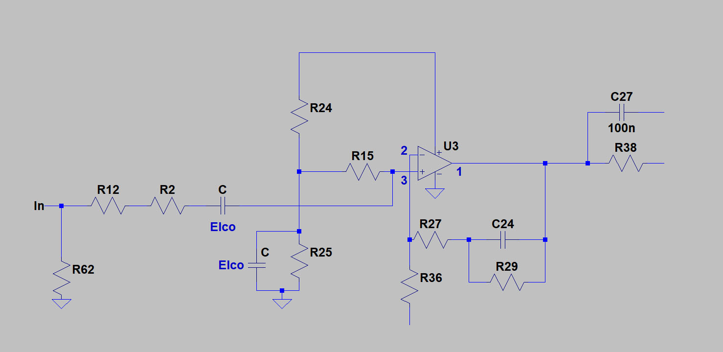

Sorry, but finding it hard to identify any cap-res-cap-gnd circuit coming off pin 2. Difficult probing this board front and back at the same time.
I would normally take Vdd (or Vcc) to be the positive rail. I'm a little puzzled that pin 4 on all the opamps isn't quite at zero although it seems consistent and probably by design (perhaps a ground lift for hum or something).
Your diagram looks electrically correct. The opamp input pins should draw no significant current to pull voltages down. If they do then the opamp is definitely faulty.
Can you see how a leaky cap, the 104J in your diagram, could pull the voltage down.
You can box clever with this to test it with little intervention. You should see 0.0000 volts across the R in series with the cap. If there is DC voltage then the cap is leaky and drawing current.
The ground plane is the large areas of copper print on top and bottom of the board. We would have expected that to connect to the ground part of the input/output sockets.

Didn’t mean to appear completely naive regarding the ground plane but I could not find any continuity to the component legs on the bottom side.

Its always difficult to say without actually having the board on your hand to spin and turn and see from all angles. I would expect the outer part of the sockets to read 'short' to both upper and lower planes. Components soldered to the ground plane may do so out of sight and underneath them.

Pin 2 has to be AC coupled to a ground (or taken to a midpoint voltage)....... so either pin 2 has to be being pulled down (leaky cap) or a duff opamp. Or more bizarre the feedback network having gone high.

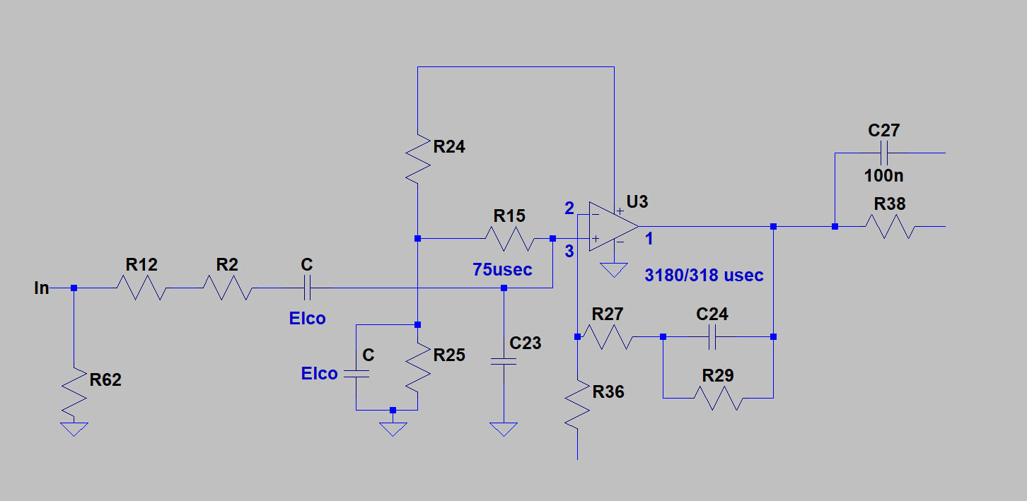

That picture was not the latest version.
Here is the correct one.
