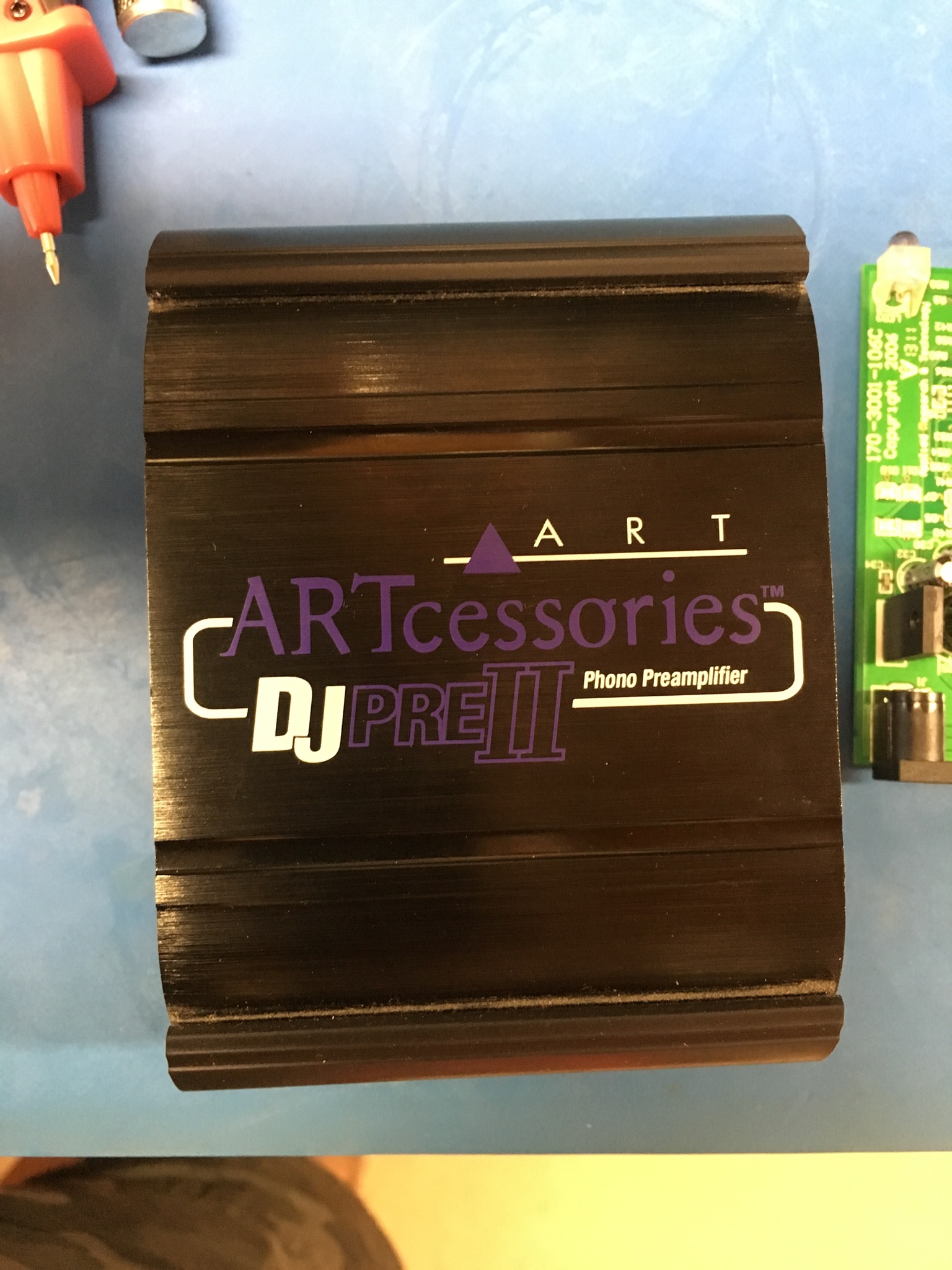

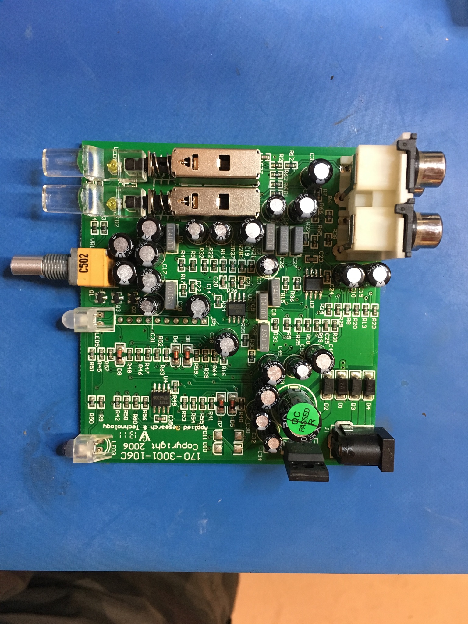

I have a faulty phono amp that has seen little use and been sitting around in a drawer for a year. It is an Art Accessories DJ PREII.
The right channel has stopped working.
When putting a 1khz sine wave through the amp I can see the signal with a scope on the left channel but not the right, just ripple and noise. I cannot see any damage on the board. There is continuity at the phono socket.
The unit runs from a 9v wall wart.
Is there a another strategy to finding the fault, or is there a likely suspect component? I am not familiar with the circuit layout yet.

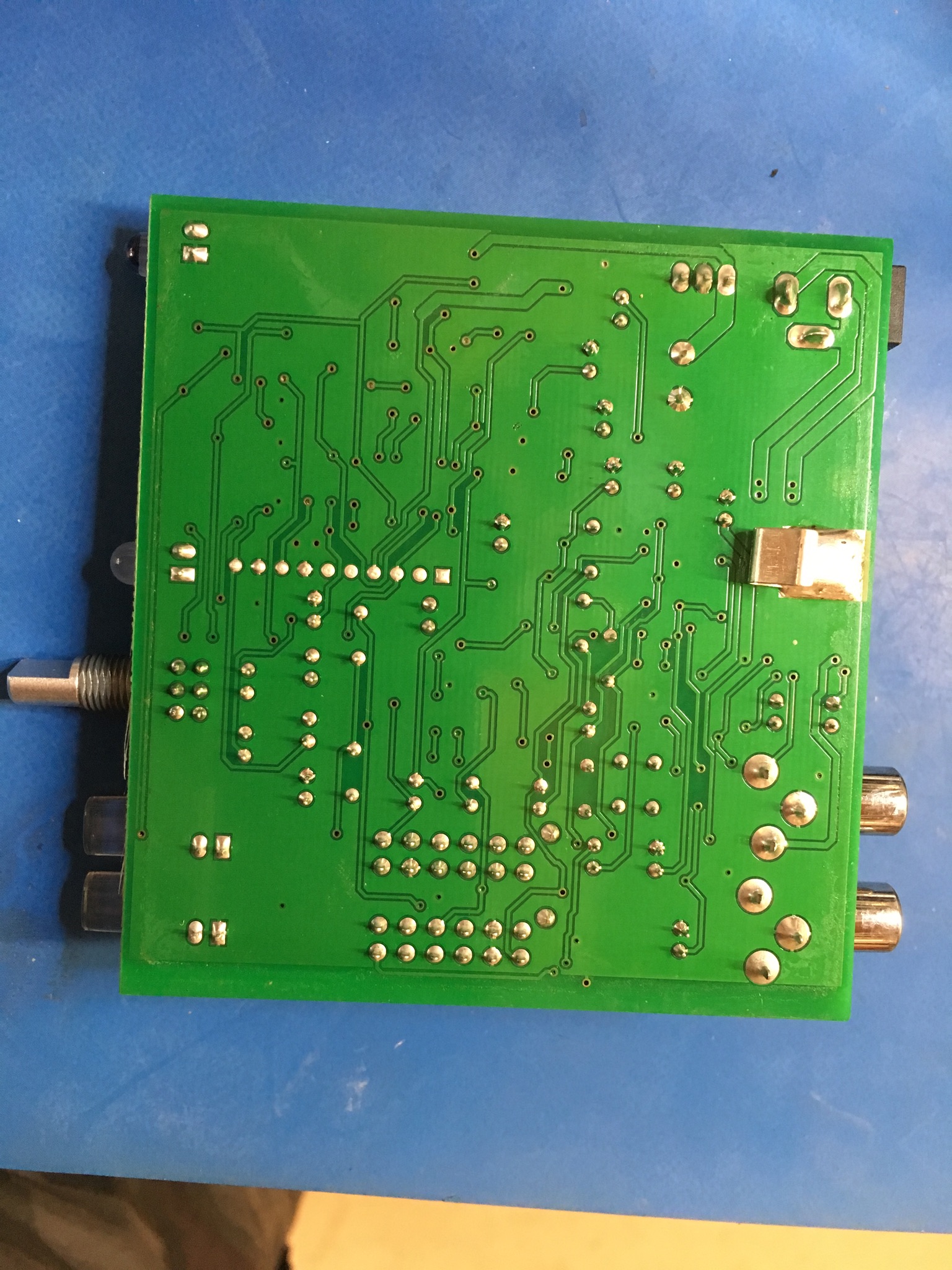

Also I would check the soldering around any 'high thermal mass' components, regulators, switches, phono connectors. From the photo some of them do not look too good. Flow soldered boards with SMT components suffer badly from this problem and they may take several years for faults to develop. Or PM me, send me the board (I'm in Melbourne) and I will try and fix it for you!

I just resoldered all connections in the backside of the board. No change.

The rubber I meant is that shiny rectangular thing You see on the right side of the 3rd photo glued to the PCB. There is a PCB track that goes near the RCA's.
Apologies, the rubber made out of metal! Thought you mean’t the rubber on the case exterior. Am I looking for a broken track to the faulty channel caused by mechanical strain? I am not sure which track you mean. 🙂
I have probed the right channel output (100khz sine wave input) while stressing the board but nothing showed up.
The track I mean is under the edge of the "metal thing" As the "metal thing" is connected to ground and over the track ...

You have lots of Vias (Holes) and one of them could be faulty. I would test them for continuity or perhaps fill them with solder.

The track you mentioned is pretty beefy and I checked continuity - OK.

First check the through hole large components. In particular the input output sockets as they have high thermal mass and are subject to mechanical stress. And that TO220 package which I assume is the regulator, of course if this is disconnected both channels would dead.
If you so see any dodgy SMT soldering set your iron to 260C and just locally retouch the joint.
if you put signal on both inputs, you should see signal (on a scope or small speaker ) on pins 1 and 7 if the chips are dual op amps. pin 6 if they are singles. both channels should be the same amplitude.
where the signal disappears is where a bad component is.
be sure to use a 100uf cap to the small speaker from ground

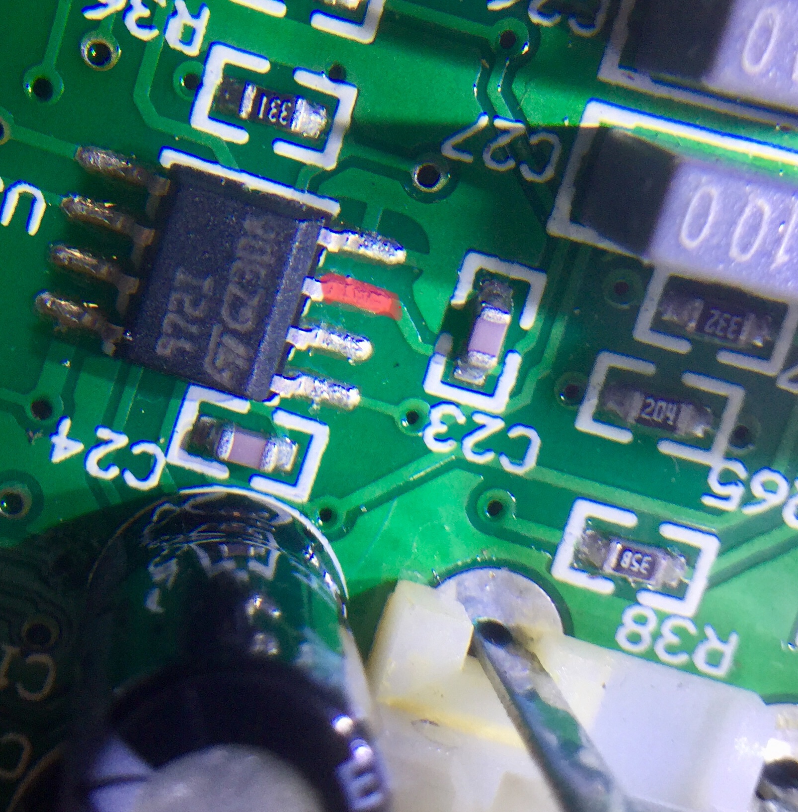

I traced the sinewave (1kHz, 30mA) to this pin but see no signal on any other pin.

There are no markings in the chip to show which is pin 1.

First the left channel: 2.2v sinewave at pins 2, 3,4,6,7,8 (my numbering is from bottom right clockwise). Pin 1 0V, pin 5 4.7v
Right channel: 2.2v sinewave at pin 2. Pin 3, 160mV. Pin 4 and 5, 4.7V. Pin 6,7,8 2.2V. Pin 1 0V.
I have no training and little experience in electronics. Pretty much relying on my high school knowledge from many years ago, and a few years of tinkering.
I have read up on op amps but need help to interpret these results.
I guess it is a TS972ID dual opamp (datasheet for example in https://www.mouser.com/ds/2/389/ts971-957361.pdf ).
Correct numbering is always from bottomleft counterclockwise (that means that the red pin is pin3 - see p.3 of datasheet). This mean that pin 4 (your pin 1) is correct ground and pin 8 (your pin 5) is Vsupply (correctly 4.7 in your measurements). However I see that your measurements show signal on both opamps for left channel and only one channel for right channel (which seems to be clipping unlike the other channel). How do you check inputs/outputs, with a scope? The 2 opamp outputs are pins 1 (your 4) and pins 7 (your 6). Do they show sinewave output?
