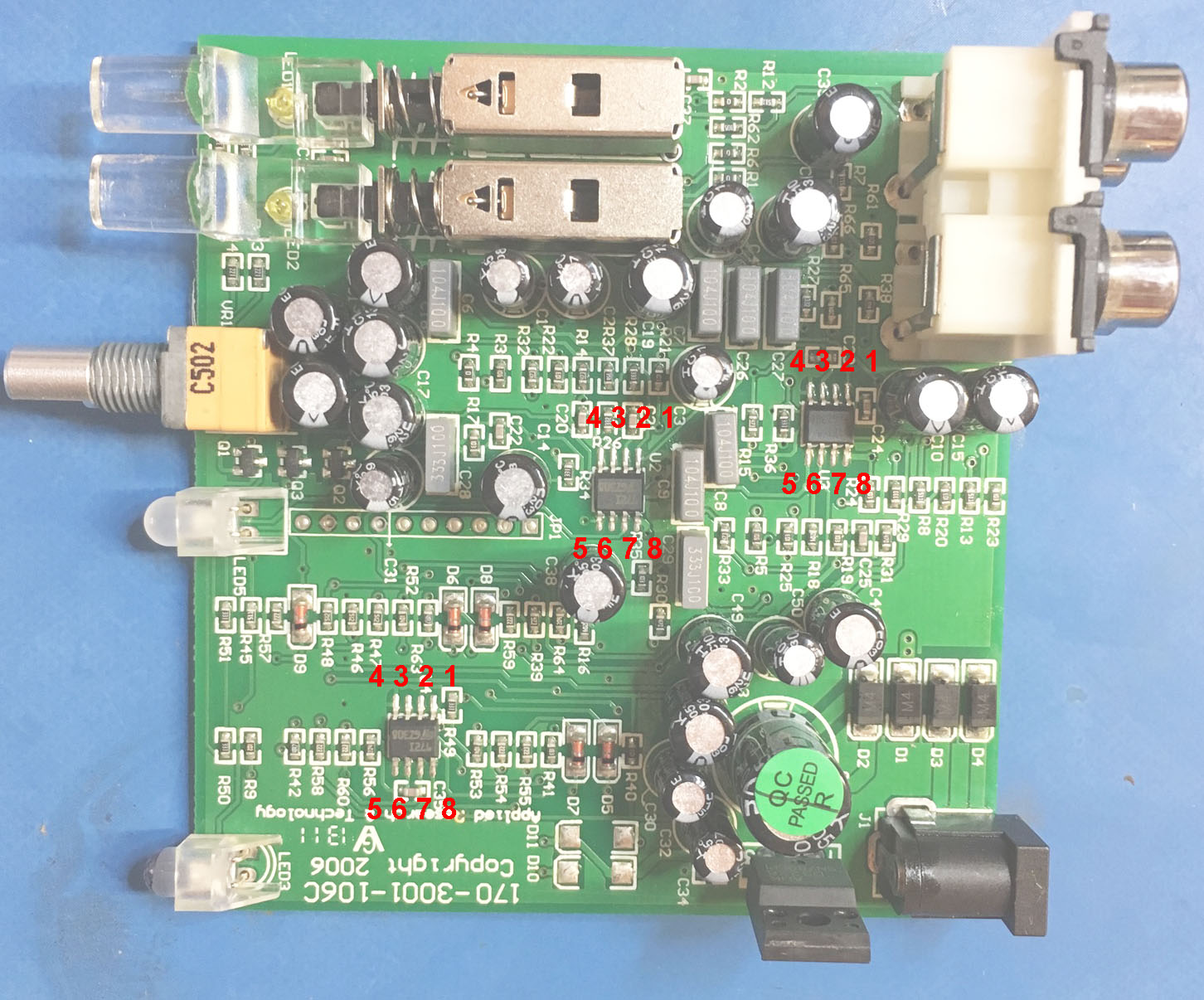

Hi thanks for the reply, can I ask how you identified the op amp just in case I need to replace with identical component?
I am confused about the configuration of the op amps - I have to admit. I assumed there was one for each channel. Are you saying that each op amp is inputting and outputting signal to each speaker?
My scope ground is connected to the back side chassis rubber and I probe each pin with the signal generator inputting to each channel per test, with the output RCA going to a resistive load. The scope dc coupled.

Key things to know at the outset...
What devices are U2,3 and U4
Which device of those is the signal applied to for the right channel.
Assuming U2,3 and 4 are dual opamps, do they share left and right duties per opamp throughout the preamp or are any used exclusively for one channel.
Again, assuming duals, one must be shared if the other two are not.
I have tried to follow your thread, but so far it has been very confusing.
1) That's why I have copied your Image below, now with inserted pin numbers.
That makes that no misunderstanding can exist where you are measuring.
2) From the data you provide it is unclear whether you mean AC or DC.
3) Using a 1KHz signal at the input is O.K. but 80mV is far above the 40mV max that ART specifies, so try to take this back to 14mV
4)Put the gain switch in the 0dB position, gain will now be 37dB, giving 1V output signal from the 14mV input, still below the 1.4V max out that ART specifies.
Now make a list for U2 to U4, specifying for all 8 pin numbers what you measure with the 14mV applied at the input.
Something like
U2: Pin 1: 14mV 1Khz, Pin 2: 5 Volt DC, Pin3: 0V DC, Pin 4: 500mV 1Khz, Pin 5: 100mV AC noise, etc.
U3: .......
U4: ........
With that table at hand will it be possible to help you in a much better way.
Hans

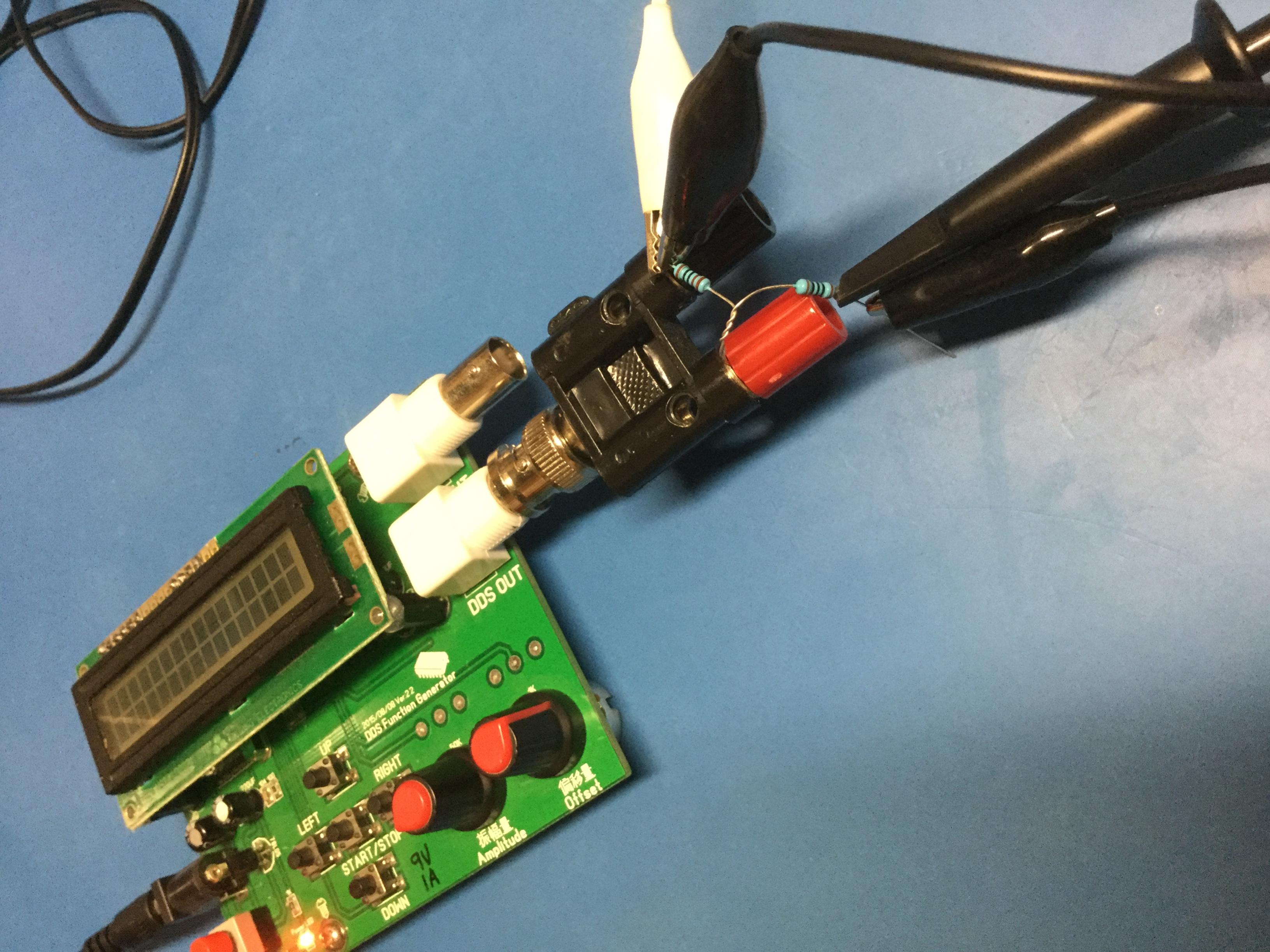

I tried this and a 100/1k voltage divider but don’t see any effect. The signal is very unstable at the lowest output with this cheap eBay signal source and even with the attenuator components, I cannot get anything stable below 100mVpp.
Not sure if I am doing this right. Not even sure if I have suitable equipment.
I think you have the resistors the wrong way around - hence the signal applied to the amplifier is about 0.91 of the signal generator output. The 100ohm resistor should be between the input terminals and the 1kohm resistor between the function generator output and the amplifier input.
Thanks, that is better. Quite jittery but can now hold 40mVpp easily. Should be able to start doing the suggested testing and answering questions tomorrow.
Are you able to identify this component? It is one of the three packages on the PCB. i cannot find anything on the web.
