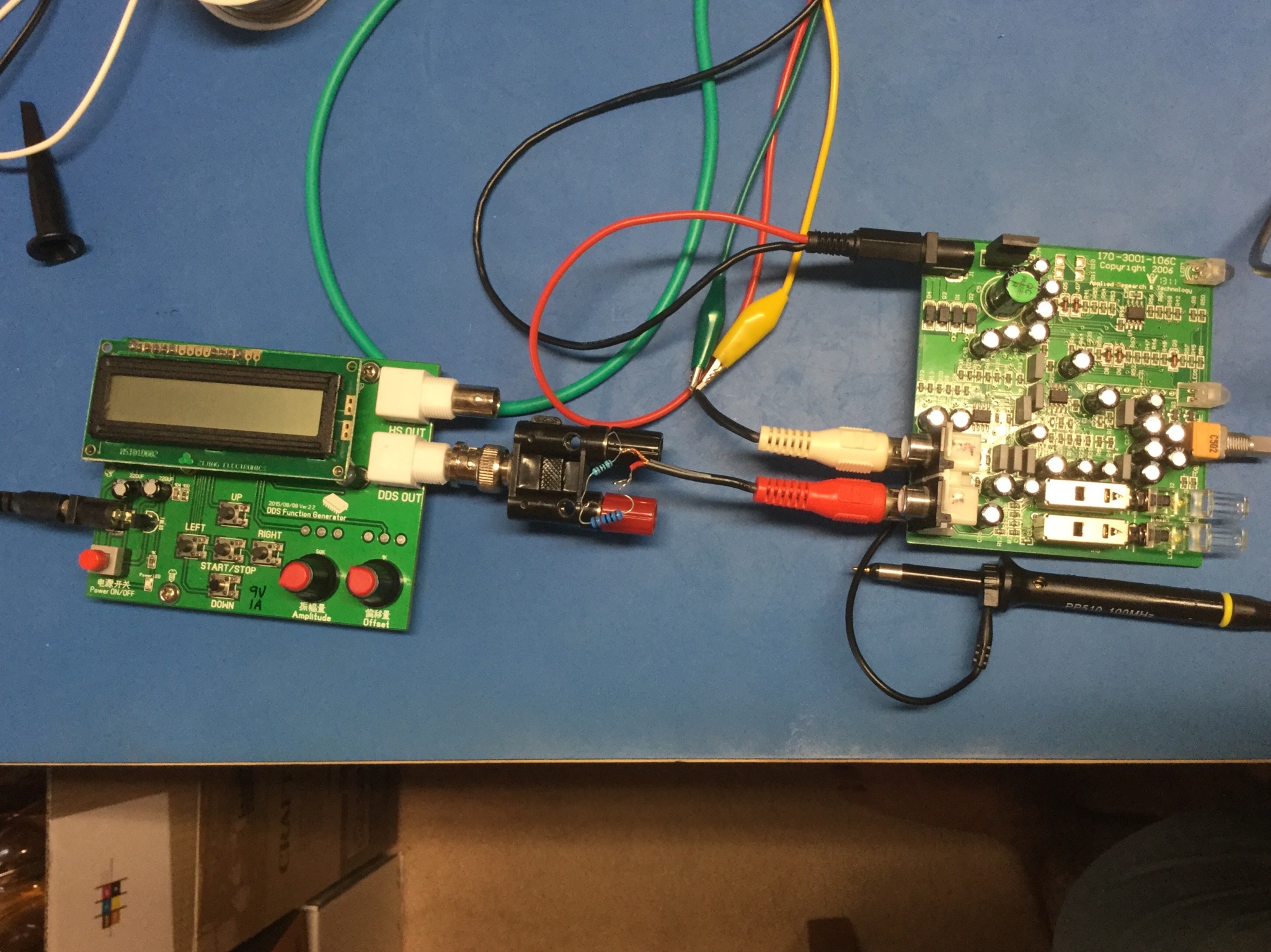

Just so you know how I am testing I have attached a picture. The noise is too much at anything less than 30mV signal. I have shortened all the wiring in an attempt to improve it. Out of shot is a Siglent DSO.

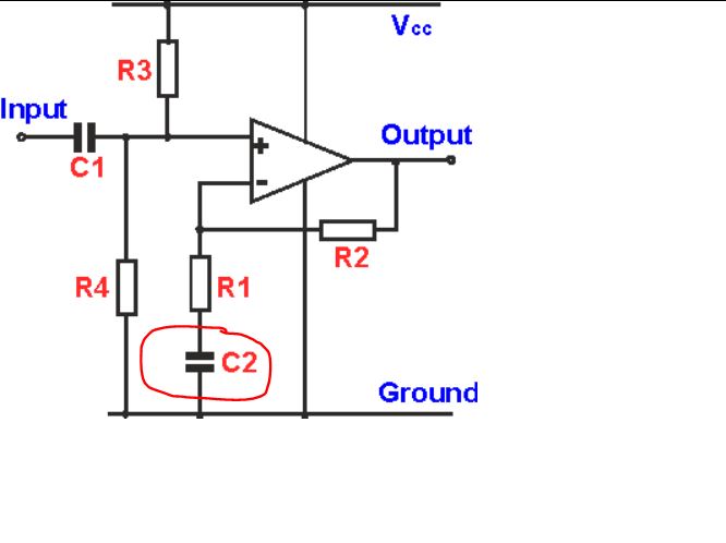

An opamp used in linear mode (such as an amplifier with feedback) will always see the same DC voltage on both inputs. The big question here is whether it is the opamp at fault or the passives around it.
Usually the opamp would be the last suspect and its far more likely to be a component fault around it.
Perhaps some conductivity tests from pin 2 to the surrounding parts would help.
What you are looking for (again assuming all my assumptions are near the mark) would be the equivalent of C2 here.

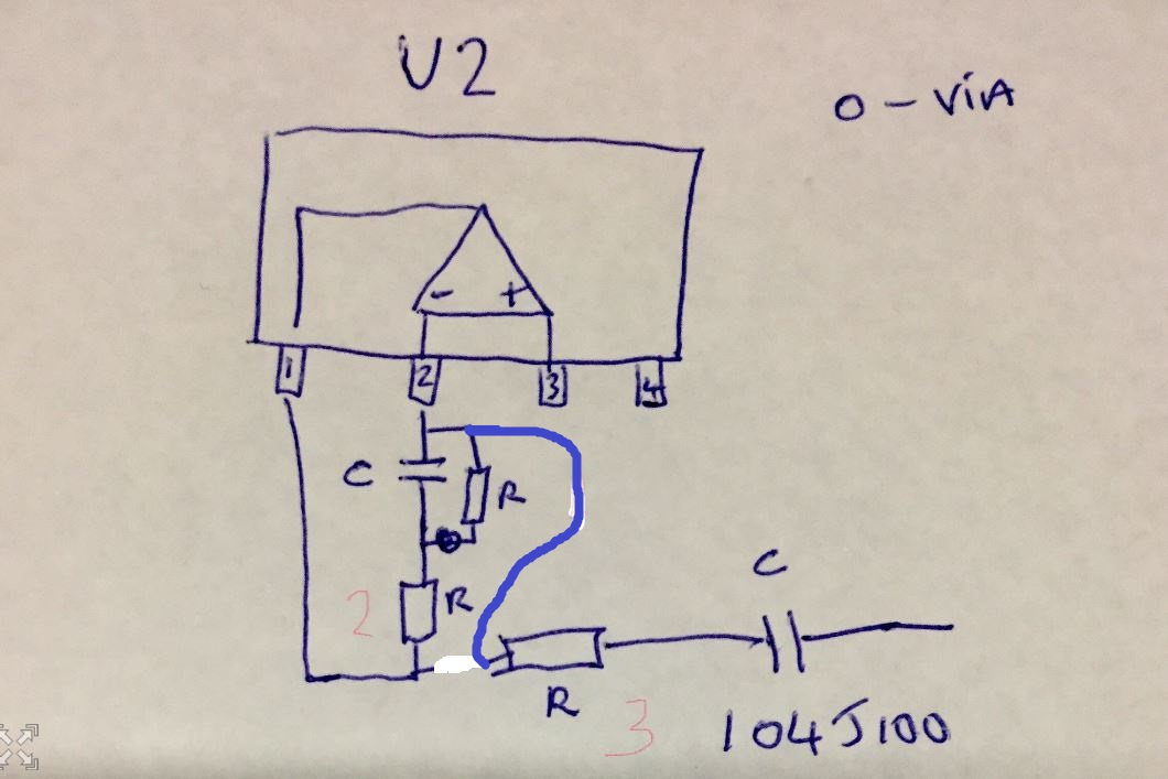

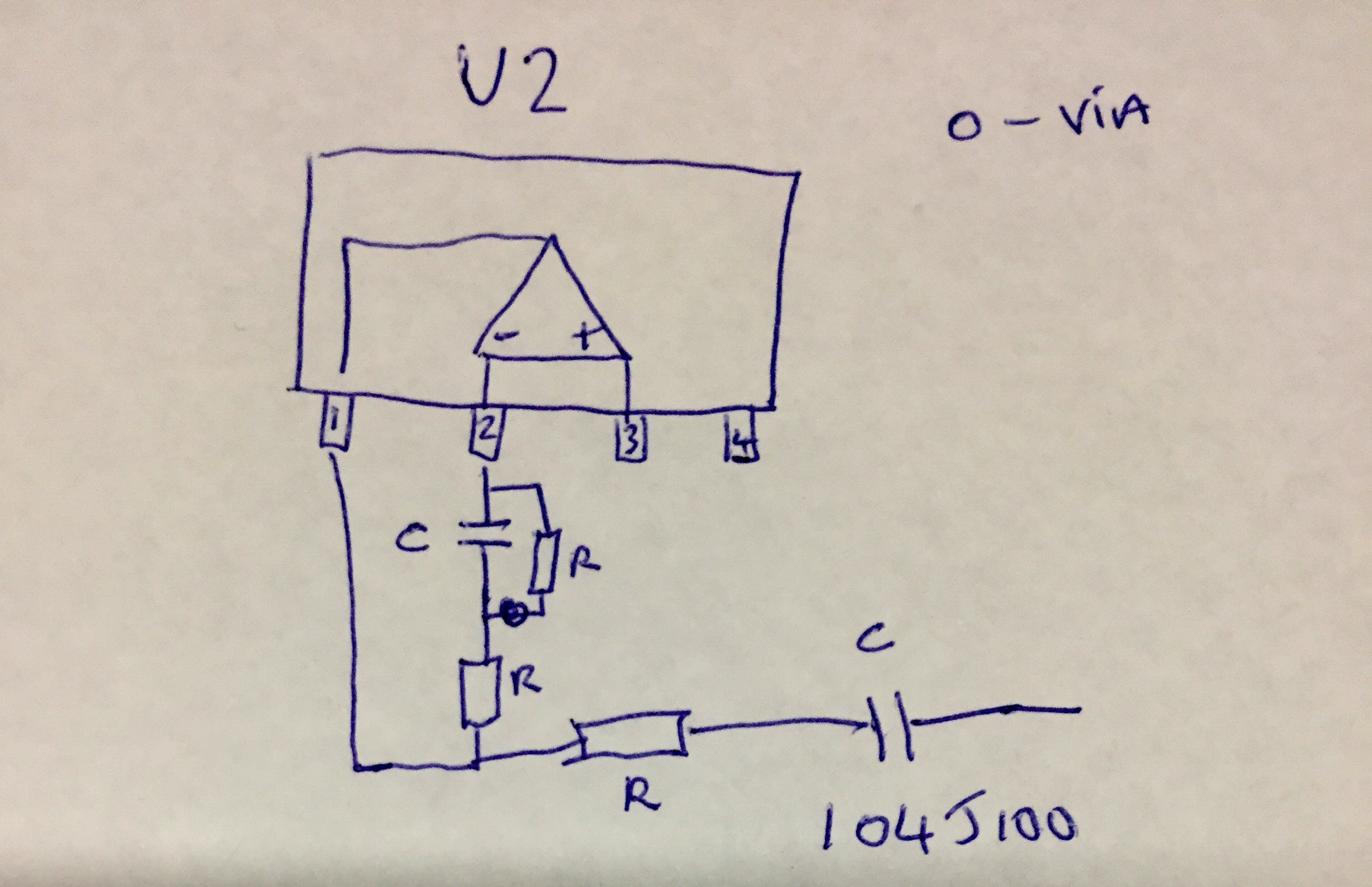

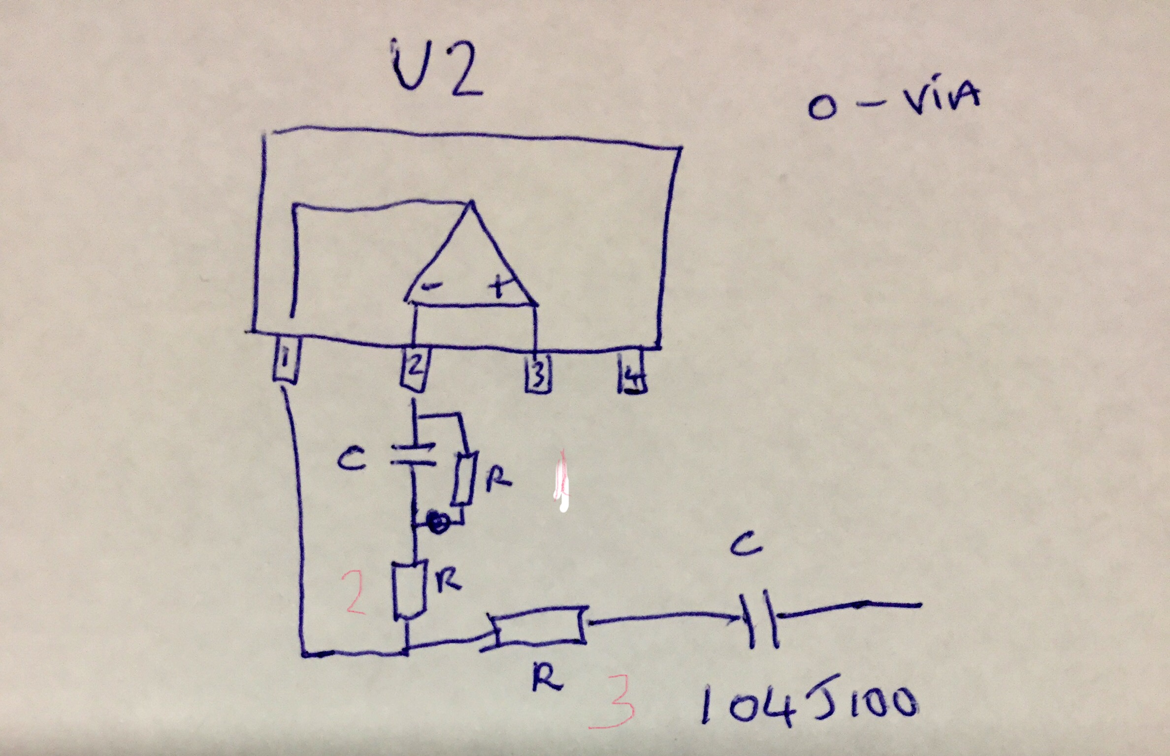

I have tried to draw the connections on U2 as those of U3 are not as easily tracked. I checked visually and by continuity.

I would normally take Vdd (or Vcc) to be the positive rail. I'm a little puzzled that pin 4 on all the opamps isn't quite at zero although it seems consistent and probably by design (perhaps a ground lift for hum or something).
Your diagram looks electrically correct. The opamp input pins should draw no significant current to pull voltages down. If they do then the opamp is definitely faulty.
Can you see how a leaky cap, the 104J in your diagram, could pull the voltage down.
You can box clever with this to test it with little intervention. You should see 0.0000 volts across the R in series with the cap. If there is DC voltage then the cap is leaky and drawing current.

What do you use as your zero point.
Since all OPA have 0.75V at pin4, you are not using the correct GND.
I can clearly see that all pin 4 's are connected to the same GND plane as your In & Output connectors.
What are you using as a scope and what probe do you have ?
