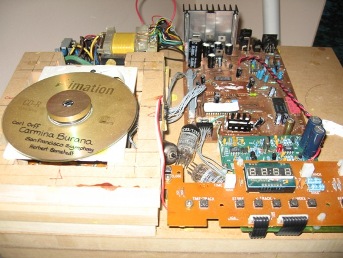

Here is my Philips version, converted into a top loader, I attached a brass disc to the original clamp to hold the disc down. I was experimenting with these a while back but am now playing with 1540 based players that have the CDM1.
That’s a Hagclock between the display and decoder. The valves are just there to keep the digital nastiness at bay 😉 .

Interesting stuff, very cool clamp, I've wondered about the possibility of re-housing the player's internals.
