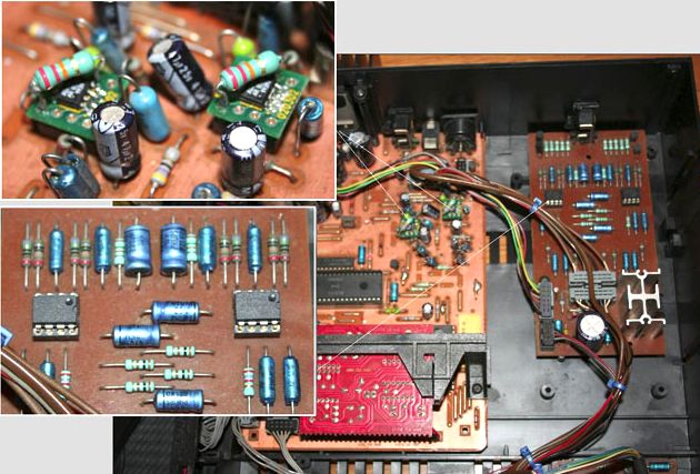

distortion said:here the picture
Thanks, that's interesting - it looks a little different to mine. Why did you change the op-amps on the extra filtered output? Do you ever use it? I chopped it out on mine.

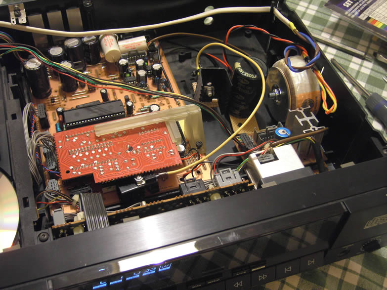

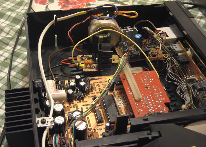

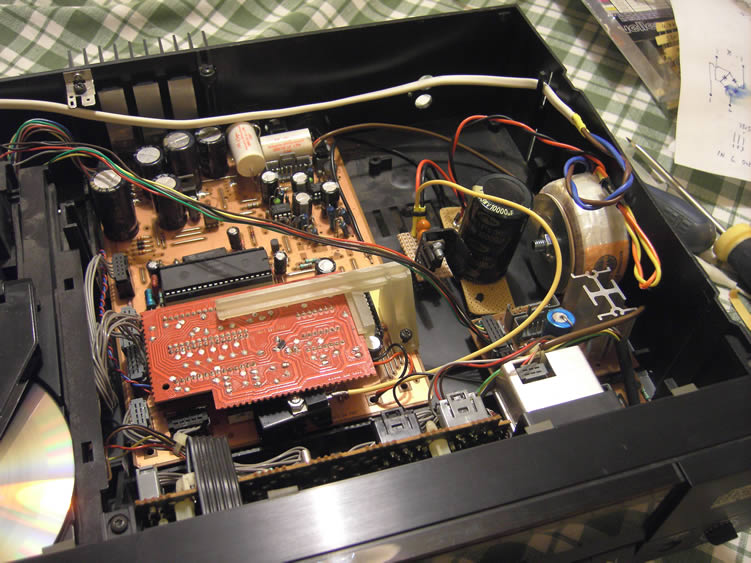

I got mine back up and running this evening. I installed a 30VA toroid, schottky bridge, 10000uF smoother, LM317T pre-regulator (10V drop!), and then a 7805CT for the SAA7220.
I've only listened to some Kate Bush so far but wow, this sounds poor! I hope I didn't damage the chip by overheating the Super Reg.
I think I can see how the reg died - the output device (D-Pak SMT thing) has actually de-soldered itself from the little PCB!!
To cool the 7805 better I've made two improvements - the heatsink is now actually bolted to the reg, and interfaced with thermal goo. Secondly, instead of the existing 12V supply it's being fed from 9.6V, which comes from a new LM317 I put together. The 317 is fed by 20V or so, and it has to be on a pretty large heatsink!!
Each 'sink hurts to touch for more than a few seconds or so.

Here's another angle. You can see I'm using tantalum caps on the LM317. You can also sort of see where I had to slice off a piece of plastic to flush-mount the transformer to the chassis. I also sliced the palm of my hand with my sharp craft knife
This really does sound flat and bland compared to how it was with the super reg. The treble has gone shy and the image seems to have caved in. The ultimate test will be to hear it with a good reg back in place running off the new PSU. For now I'll just use the 7805 and give it a good cooking, see what blows up etc..
Also, crucially, it can come up to full, stable temperature. And, although this is madness-talk, it will need to "settle" for some hours before I can expect the best sound.

Another picture to show how, i put the heatsink outside the case. Less warmth inside.

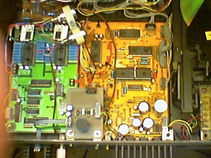

An earlier incarnation of my player, experimenting with nos dac with two 1541's.
