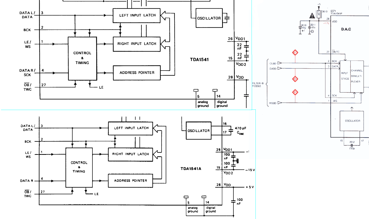

You made me curious about those 2 and 4 pins. I have a TDA1541 and it has the connection between them. I will see if it is working the mod... It would be weird, but not impossible.
And, even if the datasheet for non-A shows internal DEM capacitor, my player has one on the outside too... Wonder why.
In my CD960 (which is almost identical to a Marantz CD94 MKI) the std chip is a non A version.
The board links pins 2&4 and there is a 680pF dem cap.
Interestingly, the only difference between the CD960 and the CD94 is the A chip in the CD94.
My point being, the boards are identical for the A and non A.
I'd definately link pin 4 to GND for an A version (unless its an S version in which case i'd try it on sysclock).
I'd also build the DEM reclock (/4 inverted and non inverted) in place of the DEM cap (infact thats exactly what I've been doing for over a year now!!)

Now I saw what it does - mod replaces the 5.6448MHz clock on pin 4 with the 11.1896MHz one. Maybe a better solution would be to divide by two that signal so it doesn't overclock the internal circuit - with a simple flip-flop. I don't want to fry it.
I don't have the 7220 chip in place but I'm feeding the external clock to 7210 through the 7220 clock out line.
I noticed that on a lot of the old Philips boards the clock out from the 7220 to the 7210 also has a link connection to the pin 2&4 of the 1541 chip. This is generally not connected with a link though.
I decided an experiment was in order and put the link in and removed the normal link to pins 2&4. Result? Silence. I did have continuity between 7220 and 1541.
Anyway I reconnected the original way and it worked again.

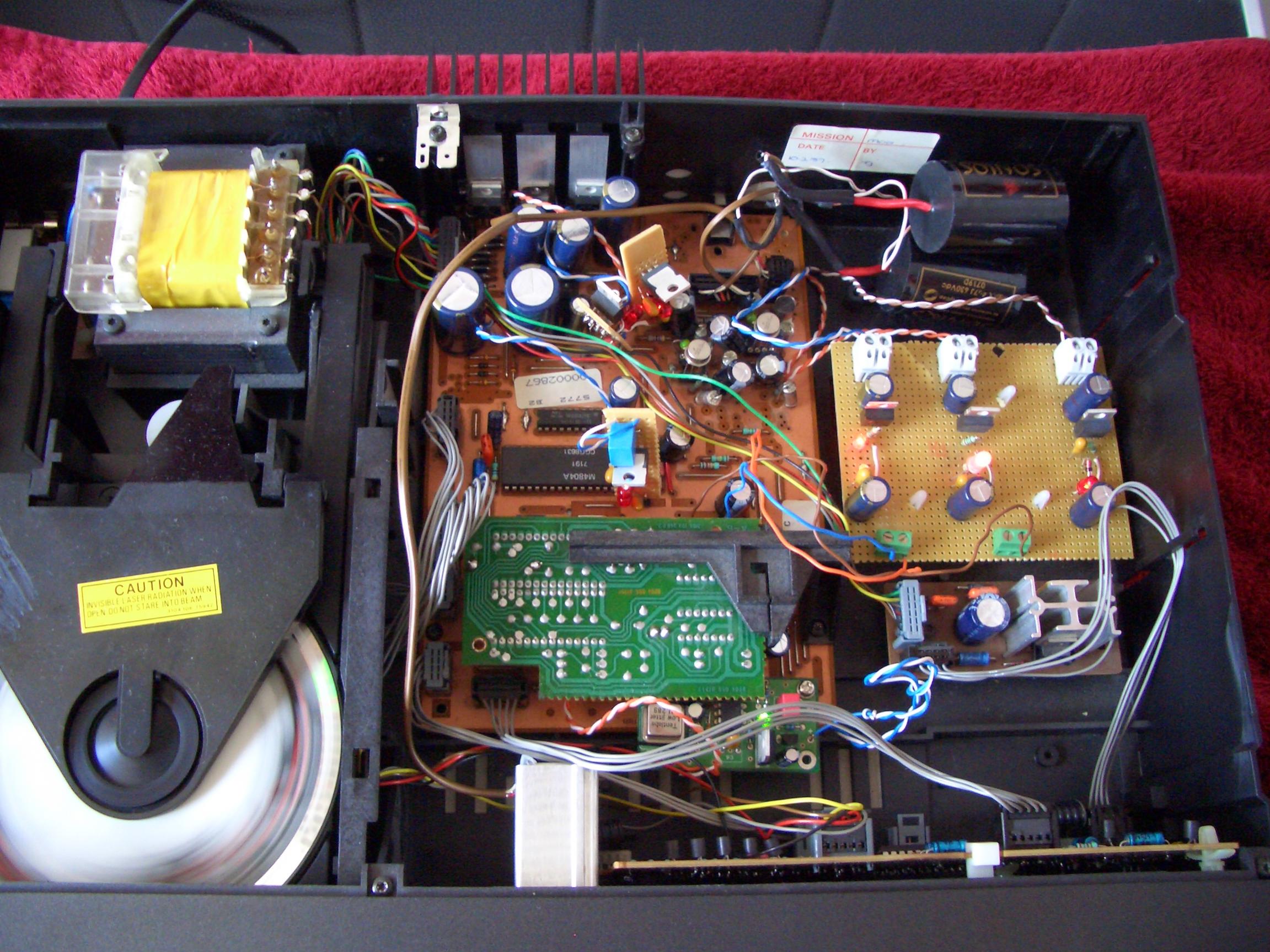

I just recently picked up a Magnavox CDB650 and I would like some guidance on modding it. I plan on using it as a source for my headphones. Specifically, I was wondering if the headphone output's Op-amp (JRC 4556) is worth upgrading, or if I should just save up the $50 or so that I'd need to build a CMoy amp.
Also, note that I'm 16 years old and that I don't have a job or much experience with modding so I probably can't afford the most premium components or do the more complicated mods yet.
Hi All, just digging up an old thread! I have dug my old Philips CD620 (similar to the 650?) out of the loft and plugged it back into my Sansui amp! Suffice to say the CD player is working fine (from what I can hear) but having stumbled across this modification thread, it makes me wonder ho wit could be improved after 20 years. I hope SimontY (diyAudio - View Profile: SimontY) is still around as he seems to have done the most mods on the 650, shame I'm no longer in York as it would have been great to meet and mod together! I now guess I have about 110 pages to read through to understand what is possible and to work out how easy it might be!
Sorry to resurrect: I've upgraded most of the caps on the main board, and sadly it now won't stop spinning when reassembled.
Checked my work, all looks fine. I've done other CDM2 mechs full recap and no problems.
Ideas welcome!
CHeers
Ideas welcome!
CHeers
EDIT: I also realised the display is intermittent, if these problems are connected. I've not recapped that yet.
