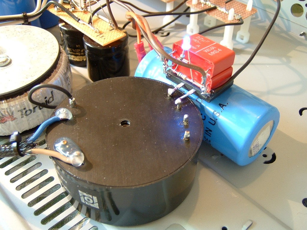

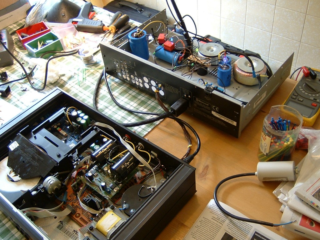

Time for a cheeky modding pic 🙂
The first is my new SAA7220 power supply. The second is the whole player and supplies with a new-old cap being formed ready for the decoder supply. It is singing now but still not smooth enough (NE5534 aren't so hot in this regard!)

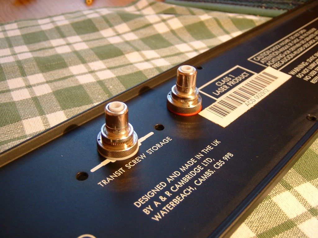

Thanks Matthieu. The RCAs aren't quite in those holes.

ps - got about 100,000uF of capacitance in this CD player now. In itself it's probably not so important but with the multiple transformers and good regs I'm getting some nice chunky bass and top draw dynamic swings.
