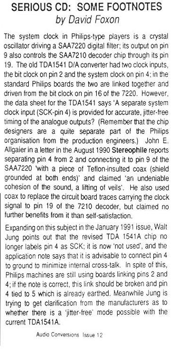

I've tried it with Q and Q_, with the RC 1K/10pF wich works fine with SAA7220 OEM data lines, 100R, always with pins 4 & 2 linked on PCB.
I don't know what I'm missing here but why don't you break that link? That's how I had it running on my CD650 with just the one master-clock. The extra clock feed was certainly nice, it will be the icing on the cake on my Arcam, on which I've just got the Pass D1 output stage running - can't stop listening to music now!!!
Hi Simon,
just don't understand what to do exactly, you've let pin 4 alone ? And fed a /2 at pin 2?
Matthieu
Matthieu
I think you break the link between pins 2 & 4 and connect 4 to ground. Then feed the clock to pin 2.
Actually, I didn't ground anything, but I cut the trace between pins 2 and 4, then fed a clock signal (11.2Mhz) to pin 2.
Simon, I'm pretty sure Pin 2 should have bck which is 11.2MHz / 2. I'm surprised it works with a full 11.2MHz.

TDA 1541 A
Pin2 BCK works with 11,2.. but more jitter and hotter chip. Better take a divider after clock.
Pin4 it doesn't matter what you do with in multiplexed Mode. Internaly pin 4 is connected to nothing and has only in simultanous mode function as DATA R input.
TDA 1541 non A
There you can feed pin4 with BCK (connect pin2) or better with BCK *2. While no OS BCK is 2,8.. (BCK *2 = 5,6.. for pin4) and with OS it is 5,6.. (BCK*2 = 11,2.. for pin4)
Maybe your TDA is heat death Malefoda
TDA 1541 non A
TDA 1541 A
Very interesting. Well then, perhaps I connected pin 4 only then! I know it didn't work with 11.2Mhz fed to 2 & 4 together. I can't remember now.

Than you do nothing else than cut the trace between 2 and 4 and it plays? You have that N1 TDA? Is it different from TDA A?..it didn't work with 11.2Mhz fed to 2 & 4 together
TDA A don't care what you do with pin4 while i2s (pin27 is connected with +5v). You can cut the trace between 2 und 4. Do this by non A and it stops function.
The other different between A and non A is that A has no DEM Cap inside. That gives possibility to synchrone shift with clock.
Hearing a difference by feeding pin4 different on TDA A is nonsens like hearing a difference by clocking the DEM pin16 and 17 at TDA non A
For example cutting pin 16 or 17 from extern DEM Cup without getting distortions is like cutting trace between 2 and 4 the safest way to indentify a relabed non A that on wondrous now a crown carries.
You have the non A and 2/4 is connect together?
QUOTE]
Thats your opinion, the truth is no one really knows what effect it may or may not have unless they try it.
Many have reported that pin4 connected to gnd gave gains and I have pin4 connected to syslck on my S2. It may be that both of these connection (which do nothing according to the datasheet) effect the substrate (stabilise) other operations on the chip.
Not wanting to open this can of worms again, just pointing out that its opinion, not fact!!!!!😎
