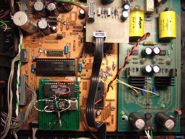

Hi folks. This one's really for the beginners who may be lurking, wondering about the location of these important parts.
The heatsink on the lower regulator is needed because the digital filter (SAA7220) draws a lot of current.
Brent installed the C1 and its reg for me, very neatly! I did the rest 😎

Yeah, it's fun and I like to see them "grow up" and finally sound "good". The only trouble is knowing this won't be my "last" CD player ever so how much do I spend on it? Funds are not limitless, but I can recycle parts I suppose!
I've not seen many CD650s on the 'net so I might be able to strive for "best CD650 in the world"... after installing some power supplies, more regulators and losing the dirty old output sockets.
I would also like to look at alternative output stages (easy ones, not tubes!), but I'm not about to design a circuit.
Simon

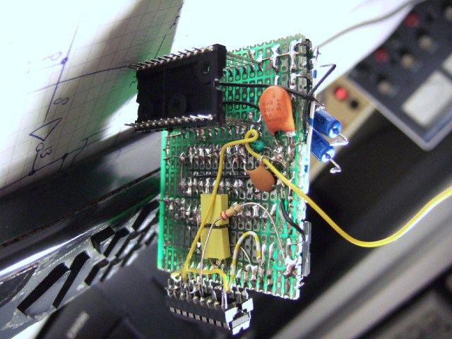

Indeed, but the cheaper cd40 version. Only this is modded a bit, pooge AD811. Hence the cooling. No more 5534 😉
