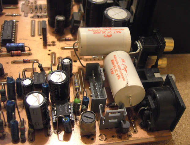

Evening folks,
I've been at it. I've just done the following:
* Glued 3 wooden cones to chassis
* Stuck bitumen damping on lid
* Changed main PSU diodes to schottky (+removed bypass SMDs)
* Changed op-amps for turned pin sockets & LM4562 op-amps
* Changed (x4) opa decouplers for 220/35 Rubycon ZA
* Reinstated DC blocking caps (Mundorf MKP 3.3uF)
* Bypassed output resistors and muting (no loud noises!)
I'll state the obvious about sonics - totally opened the sound up, and it has got a touch brighter sounding. I'll comment more when I've let it warm up and settle down.
I'd say it's approaching "high-end" already. Some proper regulators and a new clock should get us somewhere very pleasing. I have some Sercal S Powers and Audiocom Super Regulators to drop in.
I took some pics if anyone's interested.
Simon
Ok, here's a pic of the output area. The caps are self-explanatory. This shot shows one original NE5532 and one new LM4562... and old Nichicon caps vs new Rubycon ZA 220/35.
Simon
- That's possibly you still on a high after the excitement of hearing your latest mods, BUT, after the CD63 I was also surprised how well TDA1514a sounds with so few mods.
My DAC (I think) sounds great, and its just made on stripboard, which surprises me. I doubt I'd get as promising results from scratchbuilding an SM5842 DAC on stripboard.
Nice mods.
How do you like the sound of the LM4562?

Hi Phil,
Yep, I posted soon after doing mods so was very excited (never done so much at once and had a player still work before). Perhaps I'm confusing "high end" for "makes music" 😉
The high-end detail retrieval and clarity are still nowhere to be seen, but what did we expect after £30+ of parts swaps and mechanical tweeks?
I'll see if I can afford a clock shortly and, if not, I'll at least get the SAA chip regulated separately.
Once again though, the sound is wonderful. It's not shut in and dull like the stock player, but provides a pleasing and informative account of the recording. Top end detail is the main thing slightly lacking now.
But keep in mind my reference point is a Marantz CD63KI with about £400 spent on it (6 low noise regulators, extra supplies, discrete output section, two clocks etc.) With some of those parts fed into this I suspect it could start to approach the same detail and clarity of that machine, but with more character and bass (1541 sound).
Simon

Thanks 😎
I love the 4562, as much as anyone can love an op-amp. Compared to my also-favoured OPA2134 or OPA627BP the sound is more open and detailed. I have A-B'd a player using 4562 against one using a discrete FET stage and the 4562 had the same sonic character, essentially. It didn't have the same bass-weight or dynamics and you can pick which player is which (blindly I might add) from these traits alone. As for graph-boy rubbish like NE5532, the harsh and nasty OPA2604 or gritty LM6172 - it smokes 'em! (tests done as pre-amp and output of CD63KI)
