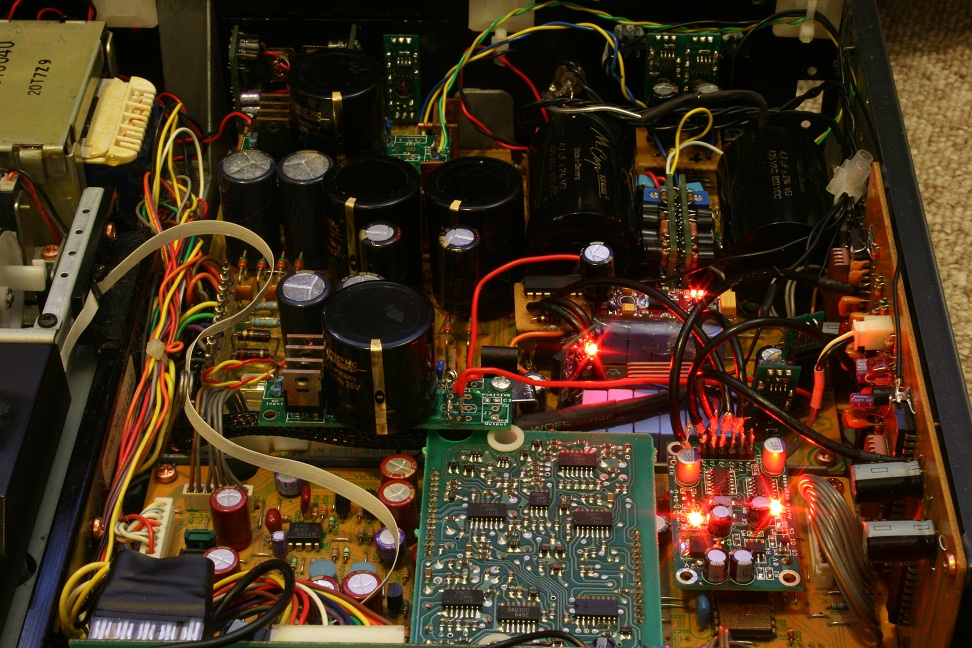

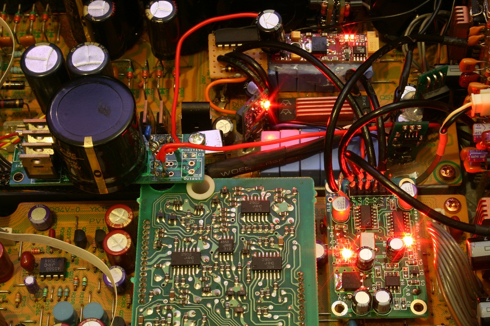

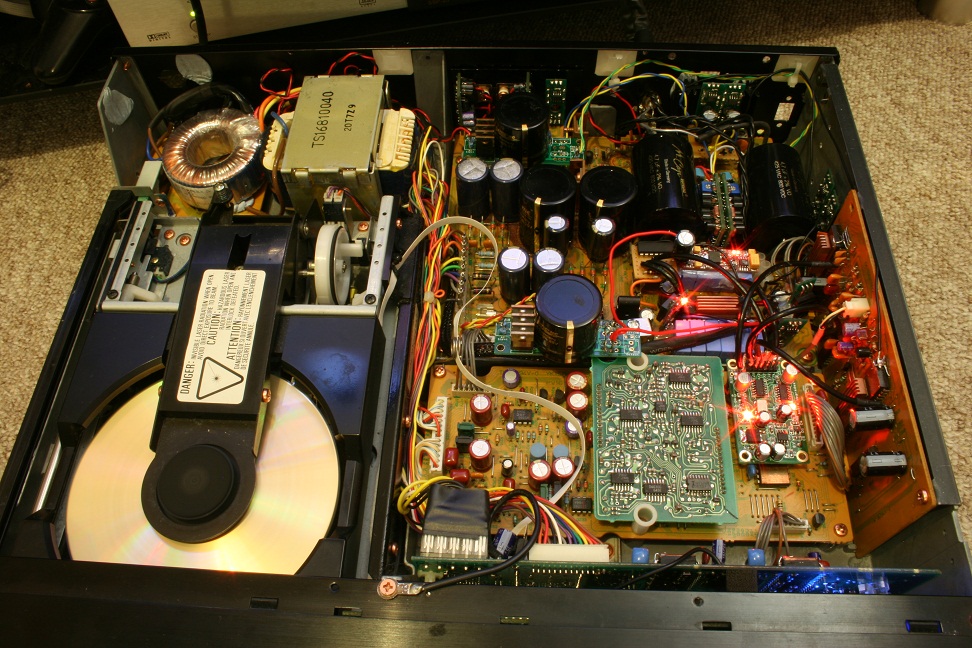

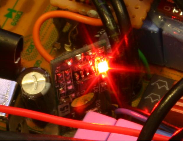

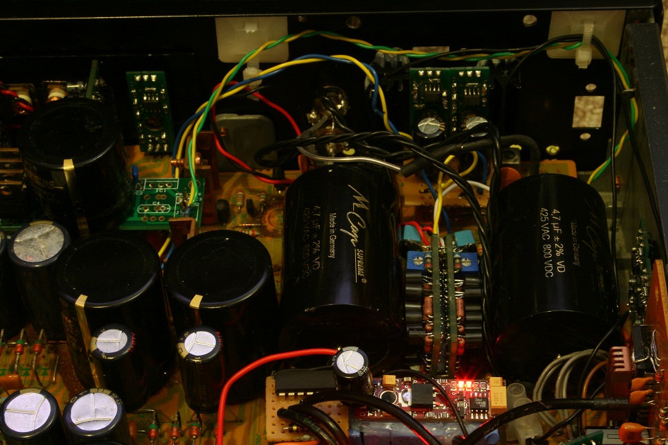

Hi Guys,
I've done a bit of housekeeping in the player this weekend! Tidied a few cables, mounted regs direct onto the board etc. I also replaced audiocom2 regulators with SPowers on the -5v and -15v. As luck would have it, I've ended up with one of the new SPowers on the -15v(got an LED now!). This brings the SPower total to 8! I've still got an Audiocom2 on the DEM reclock board, and 2 QPowers on the +/-12v for the servo and laser. I think this is the next area i'll look at. Although the 5v for this area is SPower, there is no seperation.
There is no 2 ways about it, those SPowers are awesome! I wasn't expecting much of a difference but the background has dropped away again and the soundstage is so accurate.
Took some pictures too! used the tripod and no flash just to get the LED's in!😀
Ian
Ian
