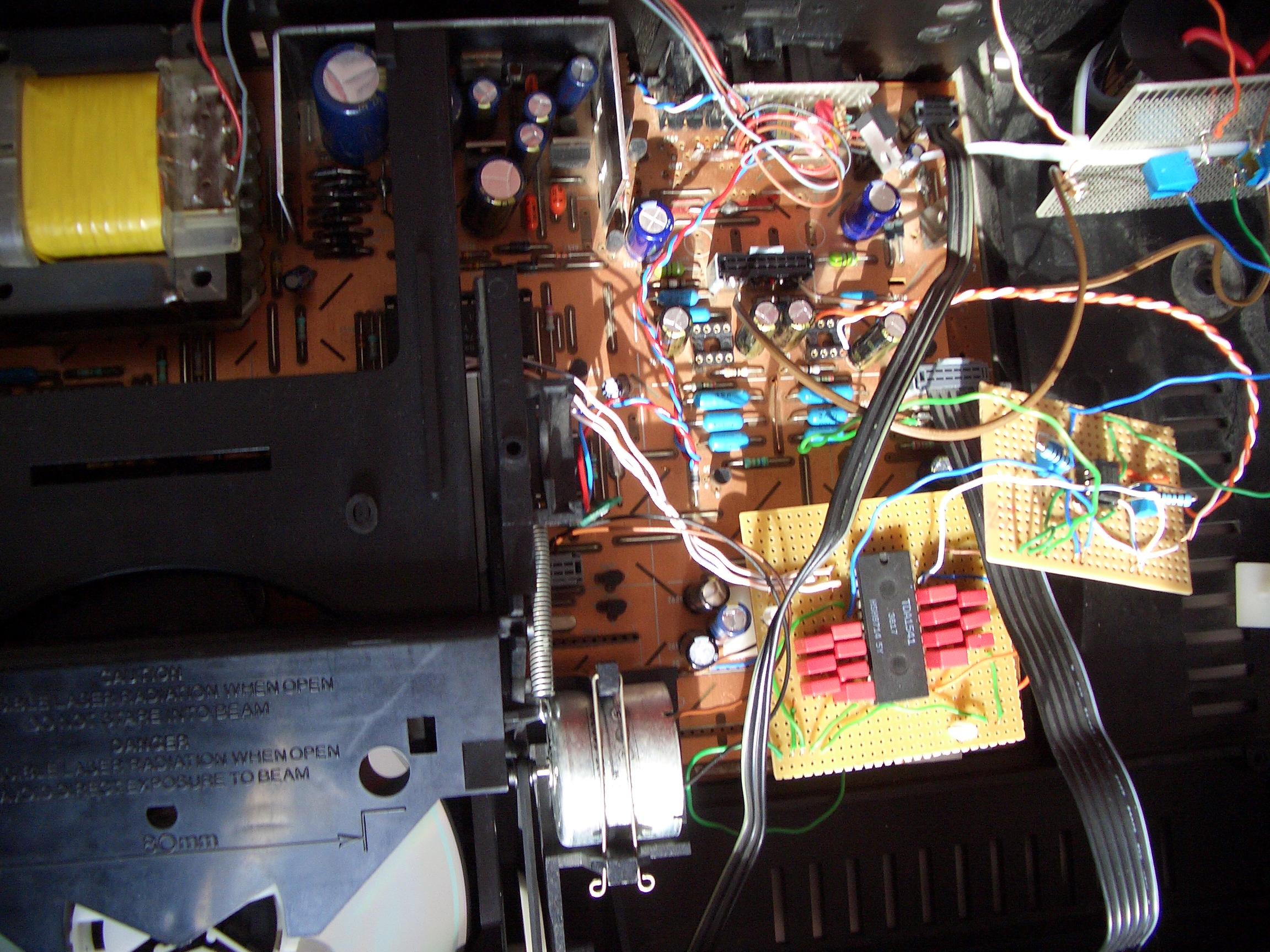

Just in the middle of doing a single opamp set-up myself albeit with ordinary opamps at present. Just wanted to see if it would work. 🙂
Also lifted the 1541 to a seperate board to fit bigger/better decoupling caps. This on a Philips 373/473.
Hopefully it will all work when it goes back together.

Partial success only at this stage.
Getting short periods of promising music interspersed with a lot of hum, noise, silence. Need to check all the grounds to the various new sections, I think they're the main cause of the problem.
I also seem to be getting a lot of DC on the output occasionally, even though I've got output caps fitted.
I'm planning to have another go this weekend.
Regards
Pete

got the earths sorted now. It's sounding quite good. Seems to be a much more noticable stereo effect than I'm used to on my CD67.
All needs tidying up/redoing with proper connections,maybe some new regs but I'll leave it like this for a while, make sure it's working properly first/
Pete
