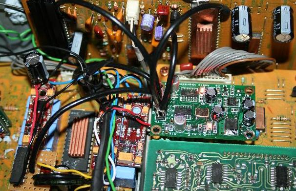

I fitted a C2 from audioupgrades today.
I'm lost for words and its only been in about 5 hours!
Appart from the multiple outputs allowing for easy clock distribution at x1, /2 & /4 (sysclock, bitclock, and DEM clocking).......
Appart from looking absolutely amaizing with uber cool leds (we all like shiney things) for constant current........
Appart from the ultra low noise SPower regulator built in to the clock...........
It sound absolutely awesome! The sound has definately changed. The blacks are blacker and the whites are whiter. The seperation is to beheld. The sound has become smoother and more refined (to the point that I put the rubbish opamps back into my amp to make sure it was the clock making the difference!).
There is an openness and accuracy to the sound and its sooo sooo easy to listen to. The harsh edge I'd created (without realising) in chasing detail from this TDA has been tamed with no loss of resolution. Its an altogether fuller sound with all the weight you could need. I cannot fault it in any way!
I'm not sure if this design has evolved based on theory or testing but I have to say, I'd never have said that a clock could make this sort of change to the smoothness of the sound.

rowemeister said:
Thanks Ian
The clock evolved with theory but ultimatly was tested using my ears and adjustments were made where necessary :smash:
Was it a Trichord clock 4 it replaced?
cheers
Brent
Indeed! It was a Trichord Clock 4 and a a D1 to give me /2 for bitclock and DEM.
The clock distribution has remained unchanged i.e. individual feeds to the 2 SAA's, 2 to the TDA and 1 to the DEM which inturn feeds another 2 to the TDA (I think that makes sense!).
I left the player on repeat all night to help with burn in! I've not had a listen yet but I will very soon!
Top Top Top product Brent absolutely awesome sound, great flexibility and above all it represents outstanding value for money. I can't recommend it highly enough!
