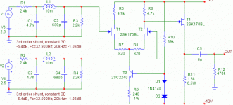

About your DEM cap - I suggest you try a simple styrene here and fasten it down to the pcb - big improment.
Where? pins 15&16?
I've got 680p on the pcb as std and Simon's just added 470p. Are you saying a styrene cap in an improvement over whats already there?
Ian
dem is on pin 16-17

This 470pF styrene is for the 1541A chip, not sure about the other 1541 ("not A") version - this is just an interem improvement until you get the final DEM 352kHz reclocking thing going (the base capacitor value then decreases to about 68nF - see the EC Design info on the Ultimate NOS dac thread)
I use the styrenes here too, with rather good results, but a bit ugly with standing on end. [old Rifa pfe216 NOS - big things]
And if you want to do something even more ugly (!), add a 4nF styrene plus 0.15R (in series) across these as RC snubber network to dampen latching current pulse.
Curiously, the decoupling caps aren't all the same (pins 9 and 11 have twice the capacitance) and the pin 13 has the 10uF poly cap rather than an 15uF electro [as per Torben] - just a small thing.
And I think that there are a number of the small smd bipass caps all over the underneath that should also be upgraded to pp - I think you may as well get used to dismantling the pcb as there's quite a few things to do under there!

James,
Thanks for the tips. What do you think about PPS caps?
e.g. http://uk.farnell.com/panasonic/ecpu1c105ma5/capacitor-1uf-16v/dp/9694315?_requestid=272663
The price is good and I think they're physically small enough.. and 1uF is a nice size, it seems (I've been reading).
I'd also replace some of the other decoupling with these under the PCB.
Removing the board was fine originally, but now I have large output caps and regs that are soldered to the groundplane, with wires feeding those from separate psus, it's not a good idea to take the board out. Cutting an access panel away underneath might be an idea. I really don't care about the chassis, I'm thinking of binning it completely soon anyway.
Simon

Simon,
Thanks for the cct and info - rather different again!
About those caps - I don't have any first hand experience with the SMD variety but their specs seem to be not very impressive. It's not the larger capacity (except pin 12) but the type of cap that makes the difference and the better caps don't seem to come in smd as they're much larger build.
Can you drill some holes thru the pads and mount caps on the component side? or hang them below with the base cutout and tack them onto the pads?
Bit messy, I know, but with a bit of careful sleeving and stacking, you could fit some of those white axial Mundorf "audiophiler" 0.1uF PP caps under there. They came up quite well - not as clean or clear as the styrenes, but still quite okay, and manageable size.
When I tried the 0.47uF Wima mkp-10 all over the chip, i didn't get any real improvement over the 0.22uF except for pin 13 - different, but not better "IMO" (in my old and doubtful opinion!)
Sorry I can't be more helpful
The old Rotels have more room in them for mods but otherwise basically same cct. (the 855 and 955s) and NOS comes up better. I've made so many changes that the pads and thin tracks have long gone and back to direct wiring! My old DDAC board is in the same sorry state but went out on a loan and never returned!

Interesting, jameshillj.
Don't get me wrong, I'm often the first to agree that capacitor type is often crucial, however I'm not so sure its the most important point with this application.
From what I've understood while researching this, from various threads and datasheets, the type is nice of course but, the size seems important for those on at least pins 12 and 18, maybe 11 and 19 (although I haven't tried 11&19), and the most important point is close proximity to the chip. Sometimes, I feel if the special caps are big enough so that they end up too far from the TDA1541A, then it sort of defeats the object.
I'd worry about cutting holes in PCBs when I could do the same with some smaller caps instead.
Mind you, I'm a right one to talk! I've only ever heard my TDA1541A with polyester decoupling caps (half of them tediously placed under the board to get as close to the chip as possible). Maybe cap type is more important than I realise?
