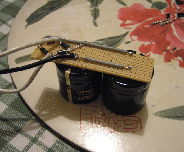

I've just wired up a wee psu for this. I don't know how it will fit, may have to be a bit bodgy to be honest.... till it moves over to the plywood sheet. Those diodes are 1A/100V schottky and the caps are Mundorf M-Lytic HC 15000uF / 25V. I found a little transformer for it - a toroid of I'd say ~30VA. This is all in preparation for those sexy discrete op-amps it'll get treated to later :devilr:

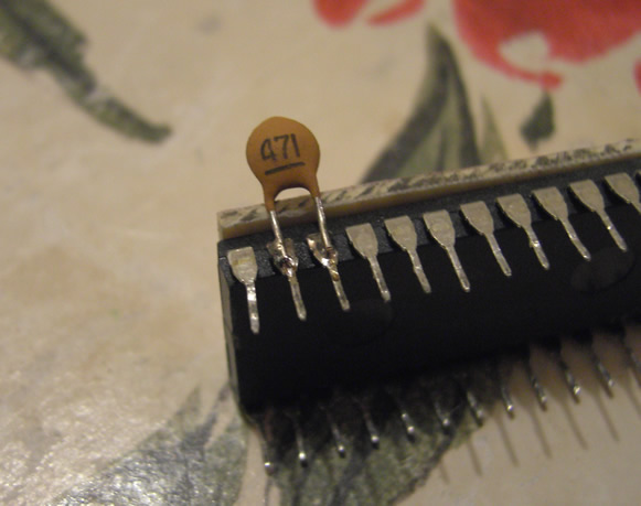

Thought i'd check first. The Schema says its got 680p accross 16&17. I checked the board and its already there. Looks like I've already got the quick win!

Glad the 470pF cap worked Simon (I have read that some manufacturers use 680pF as well)!
It should reduce distortion when crossing (if I recall) over the zero point, so essentially would lower the noise floor - as you seem to have detected.
I can't remember what type of cap I use its neither cheap nor expensive, probably the best type as its for an oscillator.

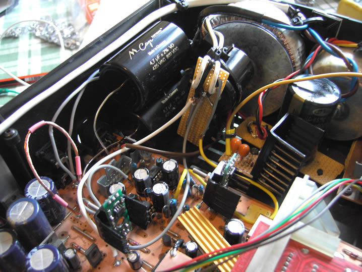

I've just finished my output stage power supply upgrade - it took me a good few hours, it was tough and fiddly. After blowing a plug fuse and the internal fuse (one by soldering a transformer in when the unit was plugged in - oops, the other by a mysterious short on the +15V output, where it meets the left channel op-amp - still not sure why). Anyway, that didn't damage anything as the 200mA fuse was obviously very eager to blow. I've dropped a 600mA one in there as that's all I could find. I think given the two additional power supplies it's not a stupidly over-rated fuse, but I'll swap it for smaller later (need to make an order for some).
And here's my safety tip for the day: don't install transformers when the unit's plugged in, because with a figure of 8 plug, either wire could be live and therefore not necessarily switched out of circuit by the main switch. Thankfully I didn't get a shock, just a firework when the soldering iron touched the power wire... and a charred finger :att'n:
Anyway, it probably sounds worse than it is - but it's a warning to keen modders. You must always take extra care and don't work on plugged-in equipment.
Furthermore it makes me think our consumer unit could use some upgrades (to MCBs) as nothing blew except the 3A fuse in the mains lead... I digress, back to the mods now, just having a nice little listen to some JJ Cale & Eric Clapton.
Simon
This is sounding rather nice. A very big upgrade, if a bit less than the HUGE one I expected. The LM4562 aren't exactly sensitive to supply noise, after all.
I'm hearing a more open sound, with more genuine detail retrieval, cleaner treble, firmer and deeper bass and bigger dynamics. A few subtler instruments have been brought to the fore, which is always a nice thing to have happen. The low-level spatial cues / decays (which were aided by the 470pF cap) are much more audible, which gives the player a more 3D feel.
Certainly some of the weak areas of the player are much improved by this PSU upgrade. I think the 47ohm resistors in series with the +-15V rails were not helping! The original -15V rail is (I think) dedicated to just the DAC now. I should short out that local psu resistor really, though I think it's just 4.7R...

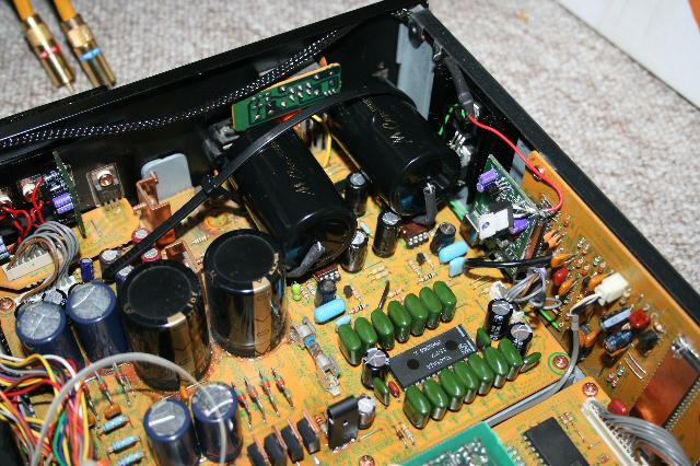

Here's a more distant shot. You can see I've now sadly used up all the available space for extra transformers etc. I'd say the player's quite modified now and nearing excellence. It isn't there yet though. I might take it to Sercal tomorrow to see how much it's closed the gap on the modified CD17KI...

Hehe, well it's hard to say compared to the CD63 because that was decomissioned a while ago. But I have a good memory of how it sounded when it was with me. It was still clearer and more precise in the frequency extremes. It had more detail, but presented it in a rather impersonal way. The detail/transparency gap is closing fast, though, and I think with S-Powers all round on the DAC, Burson discrete op-amps and some DEM reclocking it will be leagues ahead of where it is now... and automatically leagues ahead of my old CD63KI - which was treated to two clocks, something like 6 low noise regulators, and a lovely discrete output stage.
Well this has 5 nice regs now and will in the next couple of months get those Bursons, so that will be the time to compare one player to the other. As it is, this one isn't quite as "treated".
I've not heard the CD17KI at home but I can say for certain it's loads more detailed, with deeper bass and a better tonal palette and hugely more enveloping sound-staging. Not many CD63s come close in ANY respect, and at the same time it manages to have tone and bass, the likes of which only really Brent's CD63 does (and I'm not sure his really has the lovely tone I crave).
Very hard to say what the best mod was, but it could be the 5V Super Regulator on the DAC. The 5V reg and PSU on the digital filter was also immensely important.
Probably the most important mod for making the sound fully musical and sweet has been the silver-over-pure copper RCA jacks in combination with Mundorf Supreme output caps. You just don't get that silky sweet warm sound easily without good passive parts... but perhaps it would be an eye-opener to hear your DAC with purely good industrial parts - at this stage I don't know. I do *think* good parts vs good design & layout affect the sound in very different ways, the former in the sweetness and tone perhaps most and the latter in detail retrieval and soundstaging etc.
