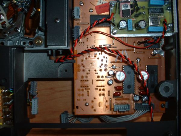

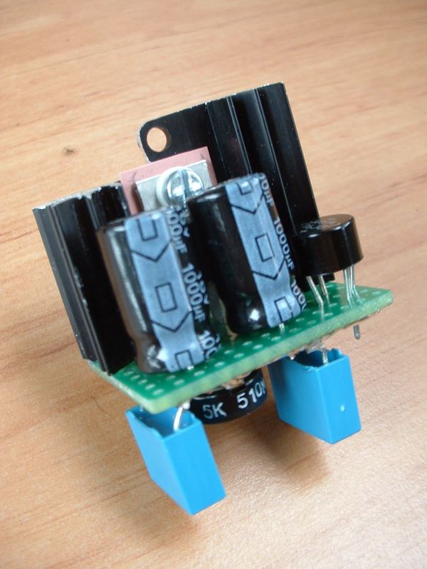

I used 47mF/160V caps as I was expecting 100V, not 150. Bit tight this way but at least it keeps the supply small. The red wire is the V-out. It is slightly boxed (alu) because it is close to outputs and the decoder/servo boards.
The decoder board is now empty where the opamps etc were. I hope to have just enough space for the tubes, caps and more caps...... and let's not forget the 6.3V supply.

Why do you think that is necessary to add the regulator? Not enough head-room? I expect the tube circuit to draw about 1W (two time about 5mA at 100V) max.
Would someting like a 24reg and 100V zeners do the trick? But would that not require extra caps (space again)?

Exactly what I had in mind. The extra caps do not need to be huge - 47uF again

Could I put a dummy load on the supply to simulate the power consumption and so see what voltage drop I can expect before I install the reg? I expect the tube-circuit will draw somewhere between 5 and 10mA per channel so perhaps a 20Kohm/5W to see what happens? Or will this do bang again?
I'm asking because I'm afraid that if I set the output to high (150V) then there will be not enough "room" for the reg and when I set the output too low (at 100V) there will be too much dissipation in the reg.
So perhaps the question is : how do I find out what the best value for the zener is?

Try without the reg. to start.
It may be necessary to revise the power supply if too much hum.

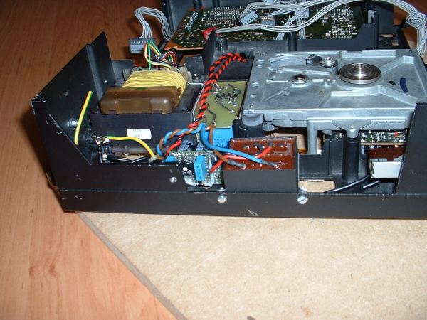

JeroenR said:Deforrestation........ room for the tubes.
where is the heater Tx?
Andy
Andy
It's the black block in front of the cdm.
Good luck !
Do we call the fire brigade now or later ?
Andy

Are the tracks too close? Shouldn't I put the tx's parallel?

New to this as I am I really spent some time thinking and rethinking what I did wrong.
And... it works. I can regulate with the pot to 6.3V. Still have to try with load though.
