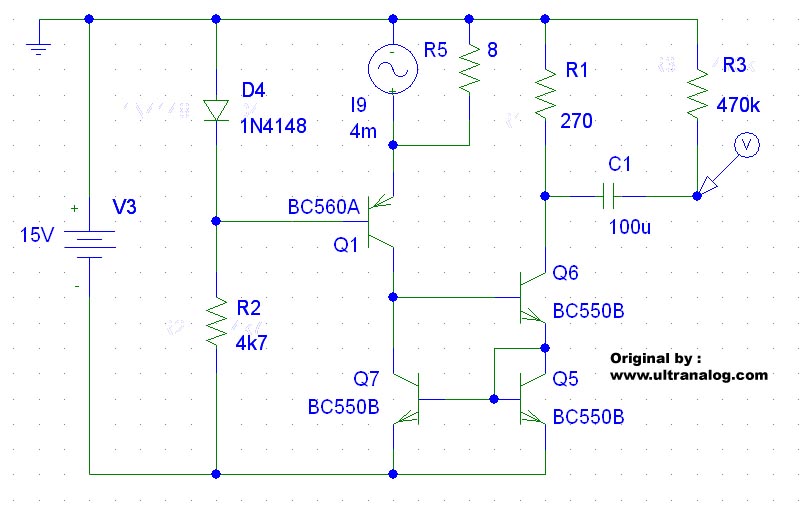

Because i got a lot of emails about the 4 transistor I/V solution i used in my cd104 i have made a screen dump of my Orcad design.
Note that it runs on -15 Volt and the output is the Voltage probe. The AC current source is the DAC of course. And the original design is by www.ultranalog.com
Let me know the results if you build it 🙂
Hi MidiMaze,
Looks nice and simple (discrete components !!)
Do you use it with the tda1540p in NOS ?
Do you use it without any (lowpass) filtering ?
Do you know how much (mili)amps it takes from the 15 volts ?
Thanks for answering.
Best regards
Onno

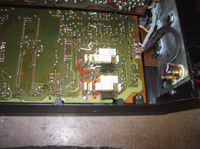

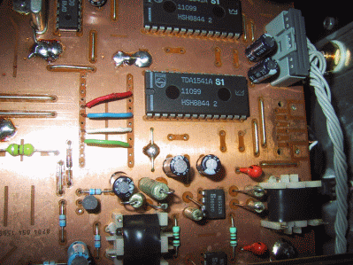

CD104 Tweaks
CD104 - NOS - with two TDA1541A
I tweaked now two CD104's ( I have 5 of them)
One with expensive decoupler condensators. (0.1 MF)
One with cheap ones from an old 386 mamma pc board
I still have to find out wich one sounds the best.
I tried to put the TDA's in balance with no succes.
Now in place of the old left channel TDA1540 is sitting a TDA 1541a with left and right channel data inputs and analog right and left channel outputs parallelled.
OC the same for right channel.
(the two other lines (LE, BCK)are paralled to both TDA's and pin
27 is low -5 v (simultaneous op)
In the I/V stages the 1.8 k resistors are parallelled with 2k2.
Changed the 22 mf output decouplers to 10 mf tantaliums.
On the power unit a 7905 is added. On heathsink)
The 9718 is replaced by a 7915.
All regulaters ( 7924 and 7915) are moved to the heathsink.
(OC the SAA 7030 is removed -NOS)
On the SAA7000 pin 16 has to stay low (16 bit)
IMHO result is nicer rounder more dynamic more vinyl etc sound compare to non tweaked non nos an tweaked nos + tda 1540p's.
This modification is easy to to.
FI no new PBC is needed etc.
Now I gonna rebuild the next CD104 and try out different I/V stages FI the one MidMaze posted and the nuvistor suggestion from Alastair E.
Attached some foto's in this and next post.
PS 1
Connection jumper wires on the SAA7030 place are NOT the
the same as original NOS + 1540p tweak.
Pin connections from SAA7000 to TDA1541a's
SAA 7000 TDA1541a left ch TDA 1541a Right ch
13 (data L) --> 3+4 (Data L R) (TDA L)
15 (dataR) --> 3+4 (Data L R) (TDA R)
14 (CLF) --> 2 (BCK) 2 (BCK)
12 (STR1) --> 1 (LE) 1 (LE)
----------------- 6+25 ----> I/V L
----------------- 6+25 ----> I/V R
16 (low= Grd) ....pin 27 conected to pin 25 -5 volt
PS 2 I believe a extern clock does not give any plus
The original clock signal from the Saa7000 goes direct to
the TDA's and the built in clock on the SAA 7000 is perfect !!
I connected the house of the xtal with a wire to the ground
(Do it quick on the xtal otherwise it is exit)
I put the Servo PBC in a slanting position with to standoff's to get it about 2 cm more away from the decoder board on the site where the TDA decoupler condensators are sitting.
Onno
I am using it in OS mode, i have had to much mathematics to understand why i shouldn't use NOS.... (i don't want any OS / NOS discussion here)
The filtering is done with the 100u cap and 470k resistor, this will give a nice first order fall-off.
I have no idea how much current it will drain from the -15 volt, but in my player it runs fine without running hot or resulting in a voltage drop.
Thanks MIdMaze for answering.
I really do not see how this 100 MF cap (100 micro farad !!!) and the 470 k resistor works as a nice first order fall-off
that in the view of the resistor of 270 ohm.
(How many db down what frequency ?)
I think the 100 MF cap is only a dc decoupler cap
The output impedance is IMHO not more than 300 or 400 Ohm.
Pse explain with mathematics.
Thanks in advance and regards
Onno
