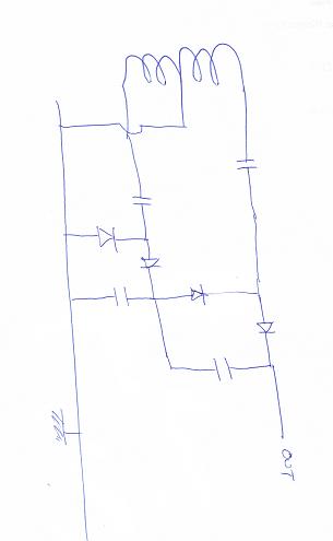

On www.triodedick.com I found an article on a mu-stage. This mu-stage would be an improvement over the above mentioned circuit. Interesting is that the second triode could be replaced by a MOSFET. Not sure about the size of these MOSFETs but this could mean a smaller (size/volume) circuit with just one twin-triode and two MOSFETs. From the transformer we could get 100V through voltage doubling of the 50V output, perhaps this would be enough. Started reading John F. Rider again as I could not even find the load in this mu-stage thing.......

I will first try Thorsten and next the mu-stage. After reading John F. Rider I can now sort of design a SE-stage, understand the Thorsten circuit but am in the dark about the mu-stage. Why is there a 1K resistor between plate V1 and grid V2 in the circuit on TriodeDick's site? Is that not the opposite of the function of a mu-stage as the signal on grid of V2 will be less with the 1K? Well... questions like that.

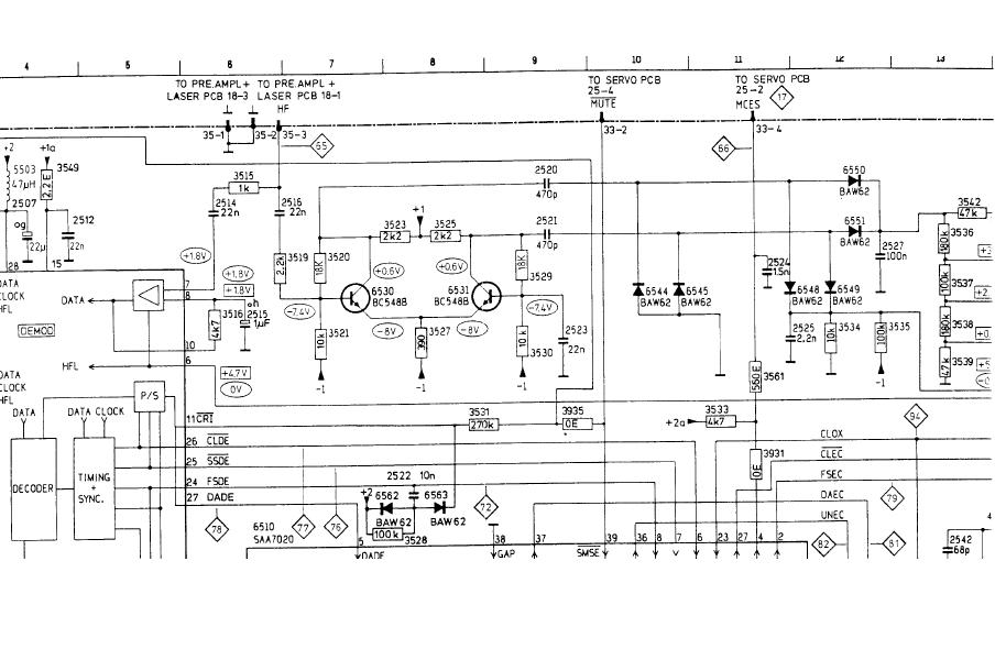

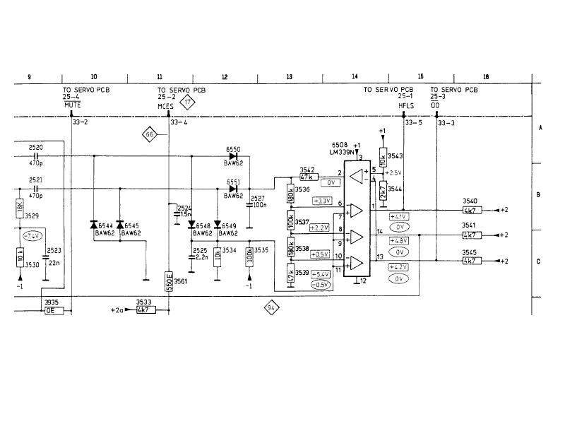

I'm trying to remove as much components as I can from the decoder board. The data from the laser seems to be split into two routes, one goes to the saa7010 through resistor 3515 and the other to a discrete circuit through cap 2516. Would anyone know what this discrete circuit is doing? Can I disable it?

poynton said:
No.... if you have the manual, refer to page 6-1-a, the block diagram.
The extra bit of circuit is the drop out detector and provides signal to the motor stop control, track detector anddecoder amongst others.

I have the manual and indeed see the "drop-out hf level detector" block. Would you know what it does? What is a drop-out?

A drop out is an unreadable part on the cd.
The dropout detector sends signals to enable tracking to continue over the fault and also starts the interpolation etc. If the drop out is too long, it stops the motor.
It is connected to the error light [indirectly] a feature dropped on later cdps as it frightened customers !

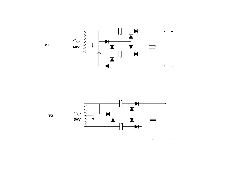

I created a powersupply for the tube I/V but have some trouble. The circuit is attached. The input is the 50V supply (55V measured unloaded) from the CD104 transformer. When the ground from the voltage doubler output is "hanging free" I measure 148V with no load so I guess the voltage doubler is working. But when I attach the groung/minus from the output of the voltage doubler to the ground/centertap from the 50V supply (which is used as groung in the player) then the transformer starts ..... well.... buzzing, snirping, an almost melting sound. Not good I think.🙁
What am I doing wrong????

Ok, another try...
I attached another circuit (V2). Would that be better?

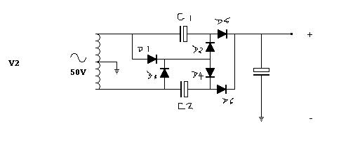

Hi.
The problem is obvious.
The centre tap of the 50v AC windings [+-25v] is GROUND.
The output of the voltage doubler is floating around this point ie. +-74v wrt ground.
So, you CANNOT connect either side of the voltage doubler to GROUND as you are shorting out half your supply !!!! Hence the buzzing ! :hot:
D1 and D2 short C1
D3 and D4 short C2
D2/D5 and D4/D6 are in parallel and act as a single diode
Andy

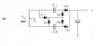

This may work ........
Hi.
This may work...
But I have not tested it....
I don't know what the ripple would be like.
It also requires another cap across the output ?
Both halves are working as full wave doublers.
The output of 1 is sat on the output of the other.
I dont think it will go BANG !
