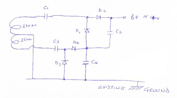

Re: Re: Re: Re: Re: A Better Idea ?
Hi.
I think you are a little confused.
On the diagram below,
C1, C2, D1, D2 form a voltage doubler
C3, C4, D3, D4 form a second doubler
The voltage at the junction of D4, C4 is 25vAC doubled [ approx. 70v ]
The voltage from the other doubler will also be approx 70v.
Hence the voltage at the output will be approx. 140v [peak off load ]. This is measured between the existing ground and the junction of D2 and C2 [B+ in the diagram ].
The ground is the existing ground in the cd-player. It is not floating!
Refering now to the M-F circuit.
Ground is ground !!!!
The circuit has a B+ rail and a B- rail plus ground.
[ think op-amp power supply ]
Please post your proposed tube circuit and I will try to explain with pictures.
Andy

Re: Re: Re: Re: Re: Re: A Better Idea ?
Hi Andy,
Had some more time to look at the diagrams. I now see the errors in the first (wrong earth, shorting caps, that was silly). Attached are two diagrams, yours (V2) and the symetrical (V1). If I understand you correctly V1 will give 100V and V2 will give 140V. What will now give the most stable voltage (least ripple)? Also, in V2 the last cap C2 is connected to C4. Is this needed, could it be connected directly to earth?
What I meant by the virtual earth; the tube circuit sees from plate to tube-earth let's say 40V because plate is at 20V and tube-earth is at -20V and of course the tube-earth is not connected to the real earth. (or am I understanding the X10 diagram incorrectly?)
In the meantime I'm going to build V2 as I have more trust in your design then in mine (understatement).🙂
About the tube circuit, I posted the thorsten design somewhere in this thread. I would be a fool to think I could improve with my knowledge hence the copy. Also in this thread I suggested a value for the R-C between DAC and tube-stage. I will update the diagram this weekend with values and repost. The kathode resistors will be a (hopefully educated) guess though as I have trouble getting tube data for voltages around 50V.
So, off to buy some caps for the powersupply and in the meantime enjoy the jazz-festival this weekend.😀
I'll post the results later.
Thanks for the help/education so far,
Jeroen

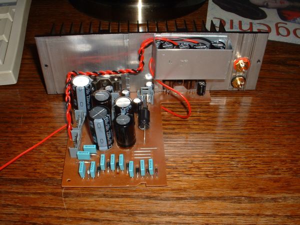

Re: Re: Re: This may work ........
Hi Andy,
It works.🙂
I measured 151.8V on the output.
The place of the supply looks a bit strange but there is the constant struggle for space inside the 104.
Saw today a CD104 offered on Marktplaats (Dutch EBay) for 100 EURO!!! I should be carefull with my 104, replacements are getting expensive I guess.
I will update the tube diagram in a few days and post.
Jeroen
poynton said:
Hi.
So what happened?
Andy
Hi Andy,
It works.🙂
Jeroen
Re: Re: Re: Re: This may work ........
Hi.
Is that the 150v supply on the heatsink ??
looks good if it is .
Andy

Jeroen
Hi.
Andy
Re: Re: Re: Re: Re: This may work ........
Yep, That's the one.
I used 47mF/160V caps as I was expecting 100V, not 150. Bit tight this way but at least it keeps the supply small. The red wire is the V-out. It is slightly boxed (alu) because it is close to outputs and the decoder/servo boards.
The decoder board is now empty where the opamps etc were. I hope to have just enough space for the tubes, caps and more caps...... and let's not forget the 6.3V supply.
poynton said:
Hi.
Andy
