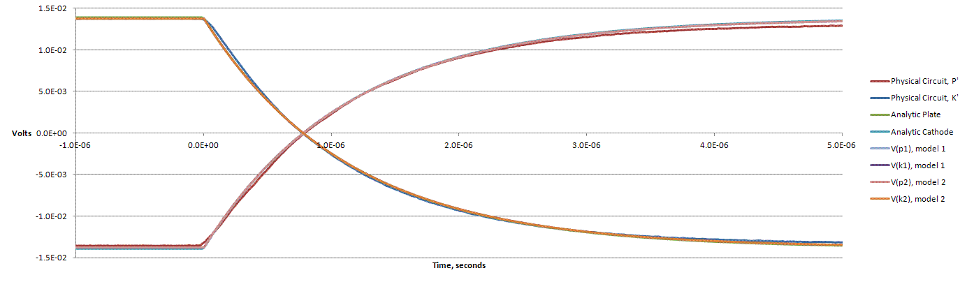

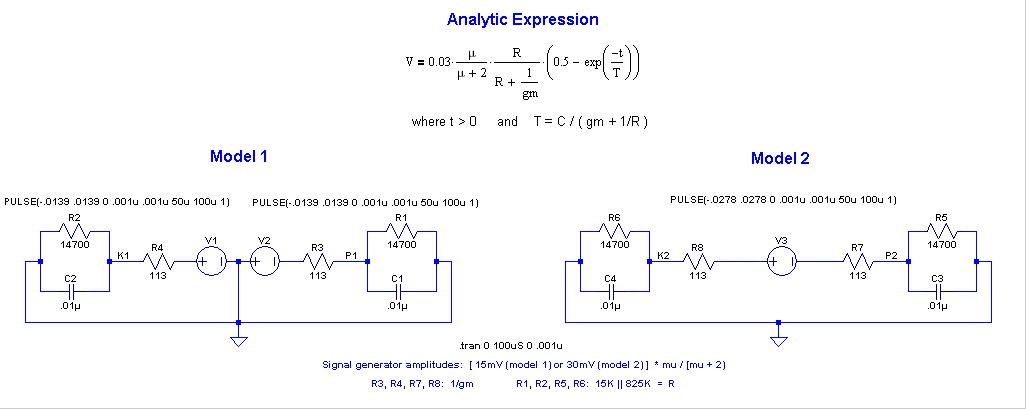

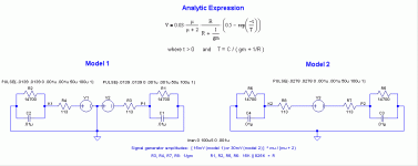

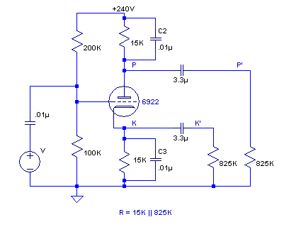

I built the following familiar circuit and drove its grid with a square wave having a 30mV step:
I also measured the parameters gm ( 8.83mS ) and µ ( 27.6 ) of the triode under the circuit’s operating conditions. I used them in the following analytic expression and models, all of which were developed to predict the plate and cathode voltages of the physical circuit:
The outputs of the circuit, expression, and models appear in the following graph:
Clearly, the all-around agreement is excellent, validating the expression’s and the models’ voltage predictions. Not so much so with the models’ predictions of the low frequency P and K to ground impedances Zpg and Zkg though – in fact, they contradict one another, with values of approximately 1/gm for Model 1 and R/2 for Model 2. Obviously, at least one of the models gets it wrong. And since that one got the voltages right, we have proof that getting the voltages right does not ensure doing so with the impedances. Therefore, there is no reason to believe that either one of them gets it right. So what to do?

Because there has been some controversy regarding the Thevenin theorem in this thread, I’ve turned to the folks who arguably are the ultimate authorities on this matter: The Institute of Electrical and Electronics Engineers. They publish The new IEEE standard dictionary of electrical and electronics terms. In it can be found the following:
Certainly the Cathodyne can be considered to be a linear network, and among its several “any two terminals” are the plate and ground. When we apply Kirchoff’s laws and Thevenin, it’s trivial to derive
Thevenin’s Theorem. States that the current that will flow through an impedance Z’, when connected to any two terminals of a linear network between which there previously existed a voltage E and an impedance Z, is equal to the voltage E divided by the sum of Z and Z’.
Here we have a simple method by which we can determine the impedance between “any two terminals of a linear network between which there previously existed a voltage E and an impedance Z”.
Zpg = [ Rk· (1+µ) + µ/gm ] || Rp
If instead we choose the cathode and ground as the terminal pair, we get
Zkg = Rk || [ (µ/gm +Rp)/(1+µ) ]
Finally, for the plate and cathode, the result is
Zpk = 2/gm / [1 + 2/µ + 1/(gm·R’)] ≈ 2/gm, where R’ = Rp = Rk
There are several take-aways from this:
1. Mr. T. deals with two nodes, not three (P and ground for instance, not P, K and ground);
2. There is no need to keep a balanced circuit balanced while measuring its impedances, and
3. Zpg and Zkg are quite different indeed. In particular, Zkg is just north of 1/gm, while Zpg ≈ Rp >> 1/gm.
And that’s all that needs to be said on the matter.2. There is no need to keep a balanced circuit balanced while measuring its impedances, and
