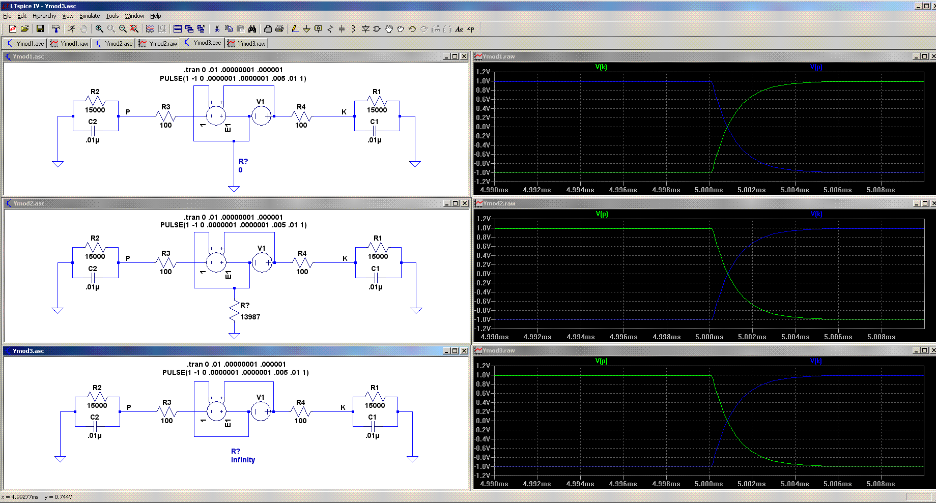

If we are to evaluate models, which have no physical reality, we can't use bench tests. Our only choices are circuit analysis and simulations. And I'd much rather see you argue with a simulation than with my analysis.
So look below. I've taken your model (R? = 0) and two variations thereof (R? = 13987 and R? = infinity) and simulated the conditions of the bench test you published in your article. The results are identical to one another and in accord with those of your test. There is nothing "wrong" with any of them.
Your choice of R? = 0 is completely arbitrary. Any value from zero to infinity works. Zpg and Zkg are determined in part by R?. This means that they are not determined by your model or by any tests in your article. The article presents no evidence that they equal 1/gm.
I’m guessing that you were surprised to discover that there is indeed a plethora of models with the same topology as yours which gets the voltages and time constant of a balanced Cathodyne right, but is hopelessly self-contradictory when it comes to the plate and cathode to ground impedances Zpg and Zkg.
Perhaps you’ll claim that your model best represents how a Cathodyne really works. If so, please consider this. Even a cursory examination of a triode reveals that its only paths to ground are indirect and through the P and K terminals – there is no hidden ground lurking within a triode. And the simulations and the bench test have proven that any short to ground is completely non-functional, and cannot be part of “how a Cathodyne really works”. If any model is “best”, it is probably Burkhart Vogels’s, which has no path to ground. But I don’t think either one of us would use his model to determine Zpg or Zpk.
I believe it is time to stipulate that these models are useless for determining Zpg and Zkg. Don’t you agree?
