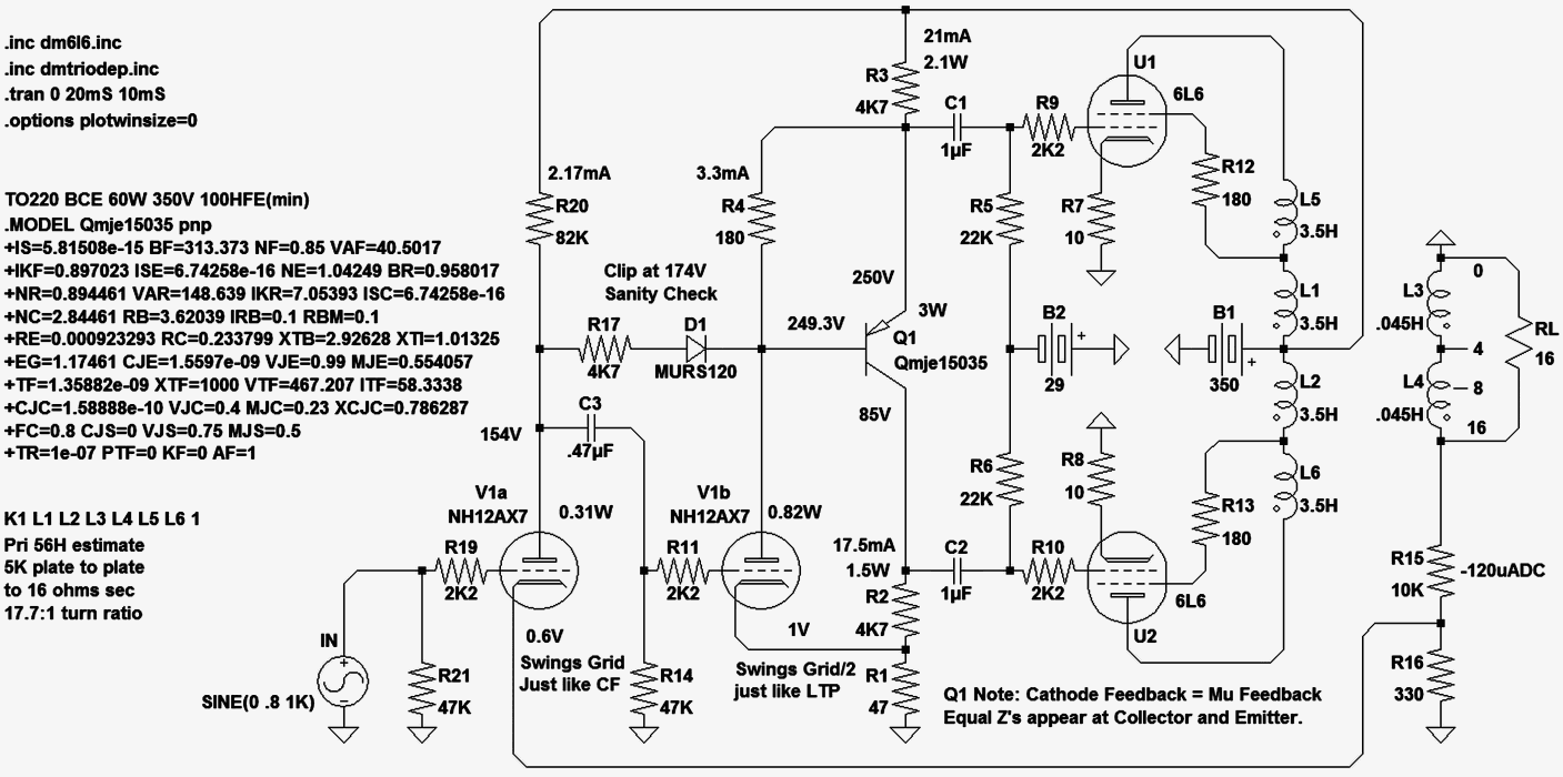

Even if you design cathodyne with truly equal impedance split,
provable by driving unequal loads... It matters NOTHING once
you close the global loop. Both impedances are forced equal
anyway, so the entire ordeal of matching them in the open
loop state becomes a silly wasted effort.

Fortunately, the loads generally seen by phase splitters do not vary dynamically! The LTP is far from immune to load imbalance.
They actually do vary drammatically when grid currents of output tubes can't be anymore neglected in respect to currents through resistors in anode and cathode of Concertina. That's why (particularly) my Pyramid that we measured a little bit in your laboratory contained LTP after Concertina.
They actually do vary drammatically when grid currents of output tubes can't be anymore neglected...
The distortion that this causes is alone the reason that tubes with grid current need cathode or source followers to drive them. But most tubes that draw grid current (not counting defective tubes!) are the sort that need a HV drive, like DHTs, where a cathodyne is unsuitable for driving them directly due to swing requirements.
