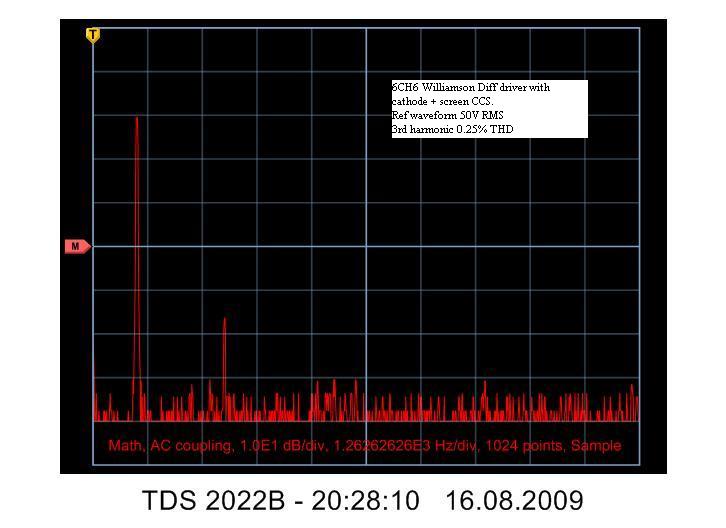

For interest, following the concertina, if a Williamson diff is used with a small amount of regenerative feedback from the split cathode resistor to the grids with a CCS to ground, the diff driver offers perfect capacitive balance for the concertina, proof is the near cancelling of the 2nd harmonic see trace....this only occurs with near matched tubes but illustrates how excellent this combination is.
This is also true for p-p output stages. One point on which there have been some errors in standard texts is the issue of class A versus class AB/B p-p output stages- it makes no difference, the load presented to the cathodyne is still equal.
