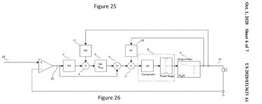

Feedback in class D amplifiers cannot be compared to feedback in linear amplifiers. It serves different purposes.
In a modern selfoscillating class D amp, the feedback loop is causing the oscillation needed for it to function at all.
The known feedback technologies until recently was 4 types:
Pre filter feedback (New Class D by end user choise)
Post filter feedback (Hypex, Purifi)
Pre - and post filter feedback (ICE Power) Twin Loop
Pre - and post filter feedback combined with a tap in the middle of the filter (TC Electronics) Tripple Loop
There might be even more vendors in some of the groups.
Open loop class D is very rare, as they are clocked at a fixed frequency, resulting in high amplitude noise, in addition the PSRR is 0 dB, and this we do not like.

One can have a lot of loop gain with multi-order feedback loops, in a Class D amplifier & have a pretty good sounding amplifier, like Purifi.
The F-word or, why there is no such thing as too much feedback, by Bruno Putzeys: https://linearaudio.net/sites/linearaudio.net/files/volume1bp.pdf

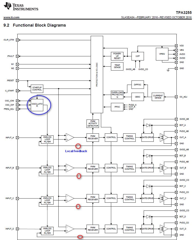

You cannot use a little local feedback in class D amplifiers.
You have to understand the way a modern selfoscillating amplifier works, to suggest different feedback schemes.
There has to be a global feedback loop, to make at oscillate, or it will be very silent and very boaring in the long run
A little local feedback suits linear amplifiers, but is not at all feasible in class D amps, which are only processing the signal at frequencies way beyond the audioband.
The TI TPA3255 amplifier ICs use a driven PWM control (not self oscillating), but there is a local oscillator that drives the PWM modulator. It uses some local feedback inside the IC. This is a limitation of these designs since it hard to get very much global feed back to include the inductor. This leads to higher distortion levels, than is possible with self oscillating Class D amplifiers with a lot of loop gain and large amount of global feedback (as used on Hypex & Purifi).
This App note adds a very limited global feedback, which improves distortion, but not by much in some regions of operation....TPA324x and TPA325x Post-Filter Feedback: https://www.ti.com/lit/pdf/slaa788
The large amount of global feedback in the Hypex & Purifi designs helps reduce the magnetic hystresis distortion of the output inductor, which is hard to do with the TPA3255 amplifiers.
Blog - PURIFI
Blog - PURIFI

I didn't say use little feeback in Class-D. I was referring to putting everything but the kitchen sink under a feed back loop to fix problem, saying it not good to use it as a band-aid fix for problems that have other way of fixing them.
Cheers George
