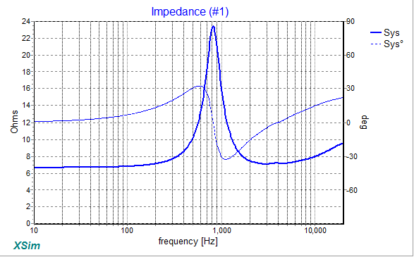

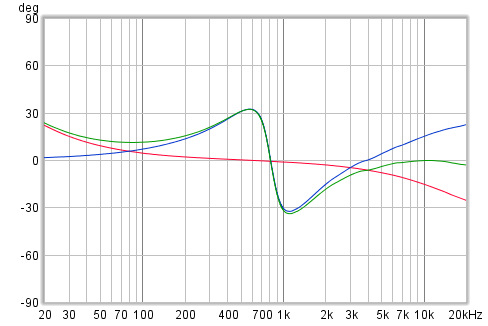

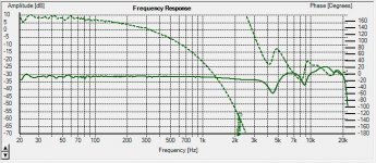

Phase shift distortion can sometimes be good for something 🙂 here is a documented example where power amp phaseshift kind of of repair the phase lag in a tweeter.
Below is impedance graph for a Monacor DT254 tweeter, we can see inherent inductance L(e) get the impedance to rise at VHF and so we get a rising phase lag as frq goes up seen isolated on phase curve at VHF.
attachment.php
Now in a REW overlay below we can take the Emotiva amp red phase trace you claim bad because its > -6º @20kHz and times it to the blue phase trace for above tweeter and wupti we get improved phase performance close to zero degree at VHF in the green trace. Think only culprit for example can be if L(e) is not always a stable (non linear) number when voice coil moves more or less to full stroke for outward and inward directions, transducers using advanced motors often have better numbers for a more stable L(e).
attachment.php

...look at amplitude response trace its really not smooth in it starts a rise and probably explode in a ugly huge overshoot and its that enourmous minimum phase distortion (PEQ like HF boost) that help phase trace stay at zero degree.

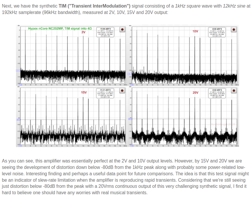

Interesting finding and perhaps a useful data point for future comparisons.
Slew rate induced distortion in the output inductor. The 12KHz rides on top of the 1KHz. When the 1KHz is positive then the setting voltage available to the 12KHz signal is reduced whilst the resetting voltage is increased. As a result the 12KHz signal is subject to a gain variation and you get distortion products. Same for all signals and same for single tones. Do not @ me.

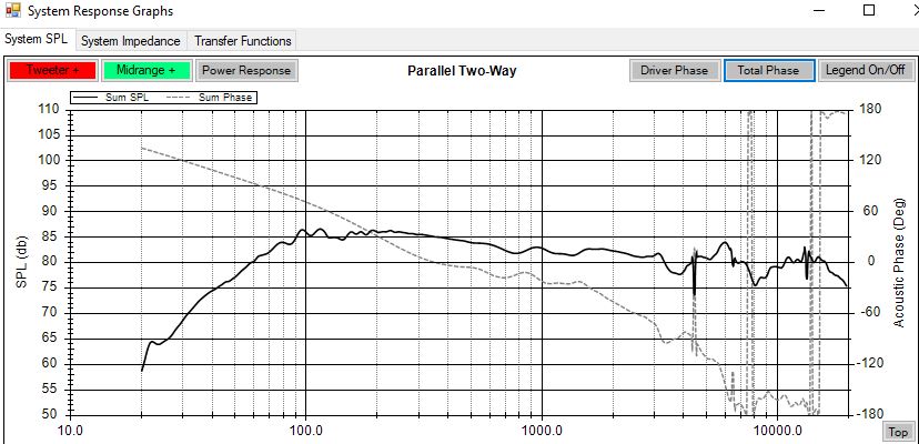

2) I have a 1st order cap-for-tweeter and coil-for-woofer set in a car door. Here is concept:

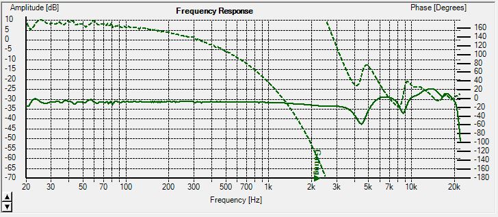

https://www.diyaudio.com/forums/attachment.php?attachmentid=910046&stc=1&d=1610254598
And here is reality, mic between front headrests, woofers in back on another channel:
https://www.diyaudio.com/forums/attachment.php?attachmentid=910047&stc=1&d=1610254915
It sounds great, surprising given the enclosure is a steel door. It even has some fair imaging. But the phase curve is unexpected, it reminds me of a 12dB/Octave 2nd order CO. Would the Kenwood output low pass filter have anything to do with that, or does it work out of human hearing frequency range?
Thanks!
Paul
OK, listening honeymoon is over. A completely neutral piano recording sounds like the piano was made partially out of car door sheet metal. At high volumes certain piano and woodwind notes ring. It is possible that the phase flip is because the tweeter is too close, which can't be helped. Overall, it is tuned and I am satisfied with the SQ, and I won't tear into the Kenwood head unit. (Although there is a lot of room!)

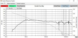

In addition to possible AES-17 filter usage, there is also DUT latency to consider. Frequency-independent effects can confuse folks evaluating phase response graphs where the test conditions were unknown. (A proper test setup is not as straightforward as it might seem.)
The NC400 has approximately 10uS input-to-output latency. This CAN NOT be ignored during objective measurements and MUST be taken into account in the test setup when performing differential measurements to evaluate phase response.
Two plots attached:
A plot of the phase response of my Hypex NC500 amplifier from input to output. (27db voltage gain removed for clarity.)
Note the 75 degree "phase shift" at 20khz. However, that is NOT the true phase response of the amplifier.
A plot with a 10uS pure delay added into the reference channel of the differential measurement to eliminate the latency of the amplifier from the measurement. This yields the TRUE phase response of the NC500 amplifier.
Dave.
This is correct, but it doesn´t seem that anyone noticed that much 😀
But do you know for certain, that the group delay in the nCore500OEM is constant throughout the audioband?
