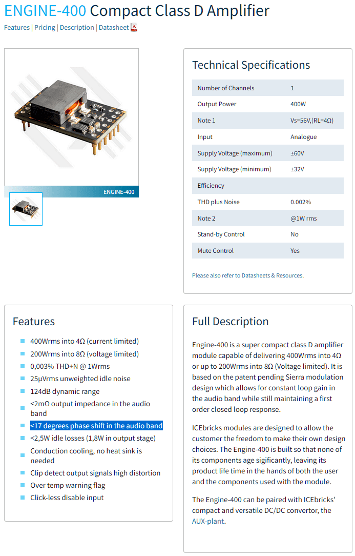

Icebrick IcePower Engine-400
https://icepower.dk/products/amplifier-power-modules/icebricks/

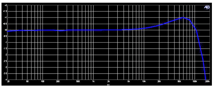

"-3 dB at 100 kHz giving very low phase shift at 20 kHz."
If that's what the low order switching noise output filter is doing.

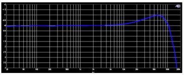

I'd hate to see what kind of switching noise is on the 10khz square wave from the output of this amp, bet it looks like a buzz-saw with no resemblance to a 10k square wave. Probably much worse than this top pic.
Cheers George

If you saw a linear amp with this on it's square wave you' say it was broken, you get over it.
I've seen still working but "blued" Wilson tweeter voice coils because of this over time as he used to leave them on, I changed the diagram's for the customer with original new ones and they sounded great again, no need to tell you he flicked those D monoblocks that got "good" reviews on Stereophile, and went back to linear. And no the D's had no dc on the output or anything weird save for the switching noise oscillation
Yes, a linear amp with such an RF residual is broken (or being forced to drive a not so wisely chosen load). But that is a different story and doesn't mean that class-d amps are defective from the beginning.
The RF residual shown in your second last post would have a power of 15 Miliwatts into 8 Ohms approximately. Taking the tweeter's Le into account it would be even less. A decent tweeter shouldn't have any problems with even stronger residuals than that.
Regards
Charles
"A decent tweeter shouldn't have any problems with even stronger residuals than that."
Well these did, those voice coils were nice a blue from heat, he was also the type to leave the amps on 24/7, and that RF residual may have been higher because the -3db point of his amps were a bit higher than those Anthem Statement M1's above Screenshot-2021-08-02-214358 — ImgBB .

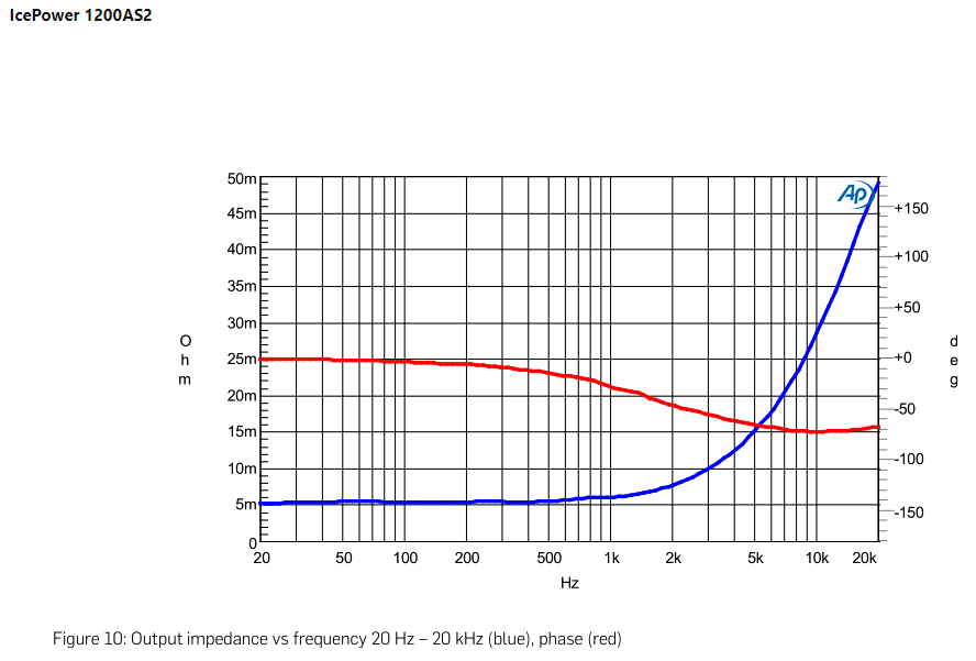

Phase shift in class D amplifiers. How it affects the sound?​
In the ICEPOWER 1200 case of 70' phase shift, it would be "almost like" reversing the phase on both your speakers' tweeters, and I'm sure you'd hear that.
That's why I was all for the flagship Technics SE-R1 that had 3 x higher switching frequency at 1.5mhz!!, that takes the output filter (cause of the phase shift) up 3 x higher also, then the phase shift is also 3 x higher away from the audio band.
Cheers George

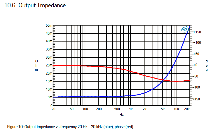

That's a frequency response plot of mag an phase of output impedance, not gain ;-)
No-one here I believe said it was of gain, just phase shift (red trace) and output impedance (blue trace).
Cheers George
Wrong again, it's the frequency response of complex-valued output impedance: output impedance magnitude (blue) and output impedance phase (red), a standard Bode plot.
Completely irrelevant for what is discussed here.
EDIT: I see ICEpower did not label it correctly but it's clear what it is (no-one would ever plot output impedance magnitude and transfer function phase in one and the same plot).
The full graph including the heading Output Impedance indicates this:
