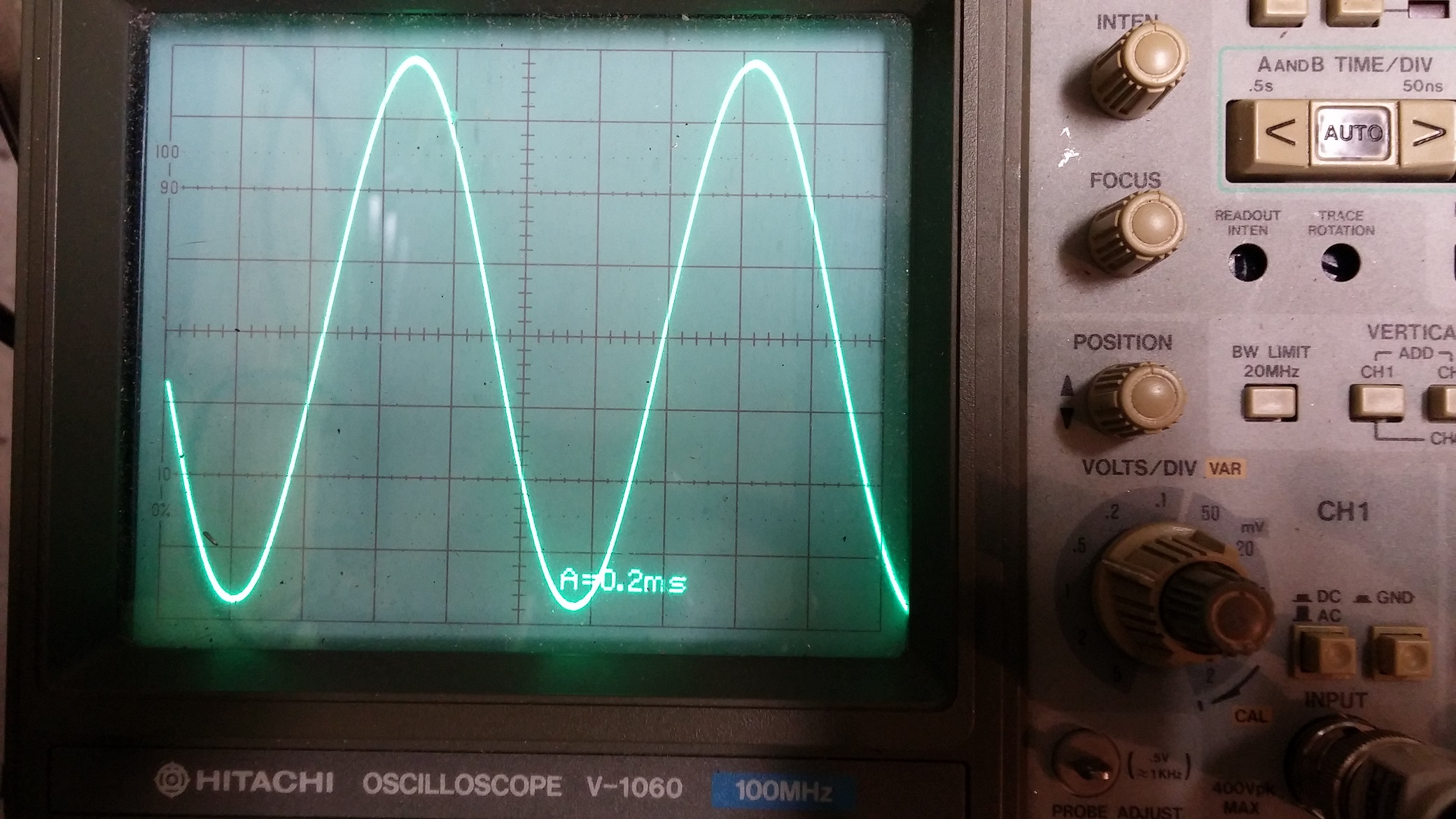

I only had a few minutes to work on the amp last night. I tried switching the silpads to mica and grease for the drivers (outputs are removed) and the oscillation improved a small amount, but is still present.
I did a bunch of testing tonight, all was done with only the drivers in and no outputs. One change I made that greatly reduced the amount of background noise "hash" riding on the L channel signal was adding Wima MKP .01uF bypass caps to the -/+ rails on the control pcb. I put them across the traces down low on the board where the Gnd, + & - signal traces run side by side. After adding these caps the L ch output is now nearly as clean as the R channel. I still see a slightly higher amount of higher freq ripple riding on the sine wave for the L ch if I get down to the .1V range on the scope. This ripple is probably 1mhz in freq and appears to be the same intensity throughout the whole 360 degree cycle. I do not see this same high freq ripple on the R ch. The level of this ripple remains the same regrdless of the input signal level. So if I bring the amp output up to say > 2Vpp this ripple is imperceptible, but my OCD says the channels don't match and it drives me nutzzzz.
I'll probably try installing an output transistor in each bank tomorrow night and see how the signal looks when running through the outputs.

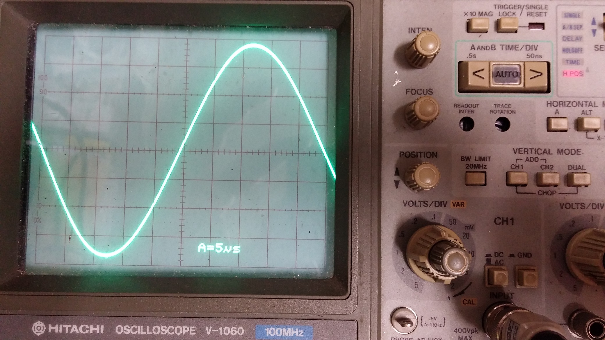

Took some pictures of the output waveforms, this is once again with the drivers only, no outputs. I included both L and R signals for comparison. One is about .8Vpp (20Khz sine) and the other is about 4Vpp (1Khz sine). If you hover over the thumbnail the description of the pic will be in the name. So about 50mv of 1.5Mhz noise riding on the L channel signal.

It took me the better part of two nights and half of today, but I finally figured out where the L-ch high freq oscillation was coming from. It ended up being R3 in the L channel ground circuit. That is supposed to be a 56r resistor, but it was measuring 6k. After replacing that bad resistor the L-ch is as clean as the R-ch. I included a pic of the scope with the same 20khz sine at about .8vpp that displayed the oscillation in my previous post.
Now that the ground resistor issue has been corrected, there is not a hint of oscillation. DC offset is now even lower than it was as a Quasi-Comp. Both channels are about 5 - 7mv. I rebiased the outputs and I played the amp through my 4 ohm bookshelf speakers for about an hour. The amp appears to be very quiet, no thumps or noises at power on/off.

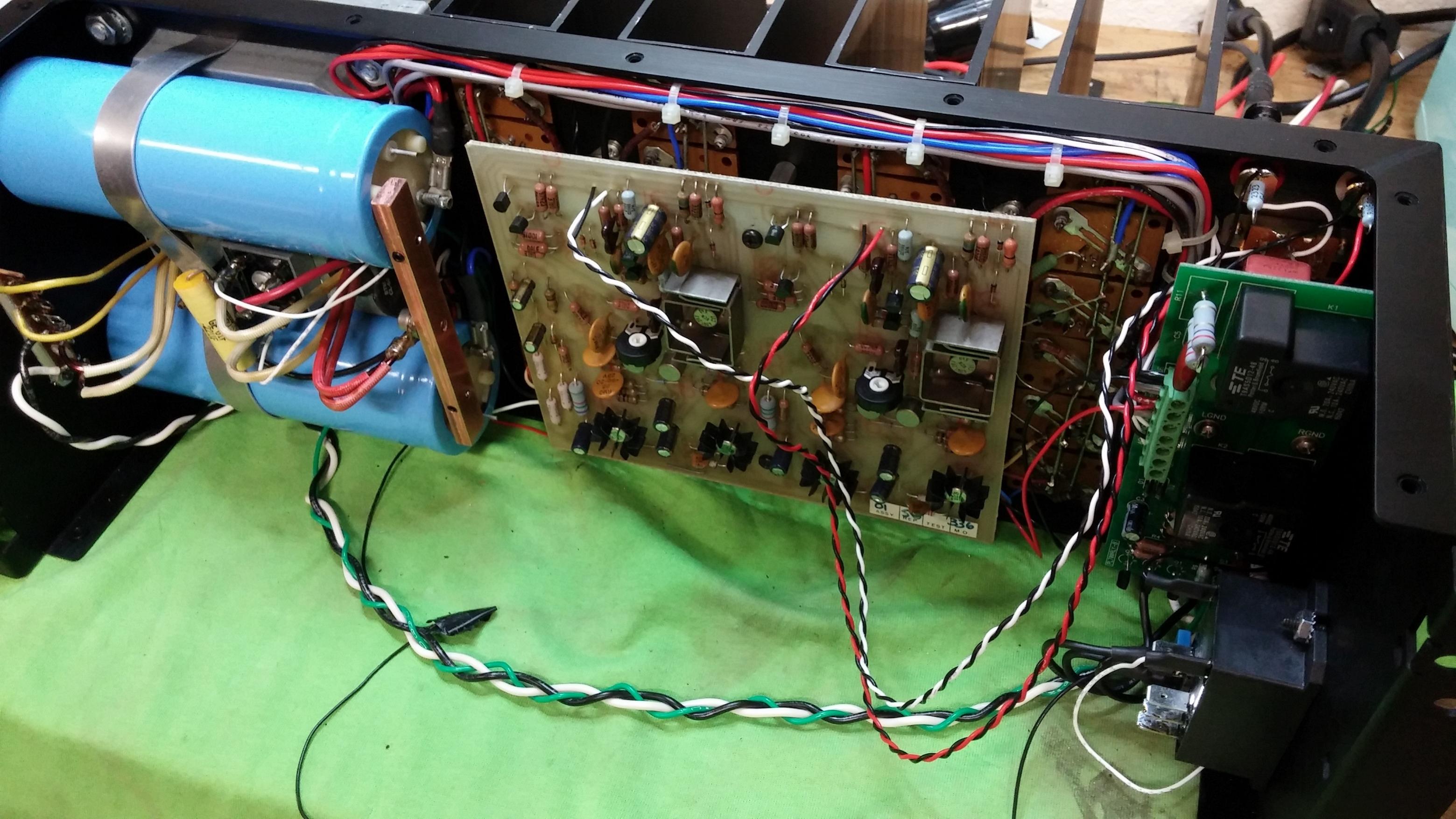

After I finished with the listening test I installed the wattsabundant speaker protect relay pcb. I tested it and it drops out with 40VAC RMS at 6Hz, and about 2Hz when I drop the output to 30VAC rms.
I have a question for you guys that have converted these to Full Comp. What have you found to be a good bias setting? I tried 10mv Vre (which are .33r), but it appears that is going to be too high based on the temp of the heat sinks after about 30 min of playing into a 4 ohm speaker.

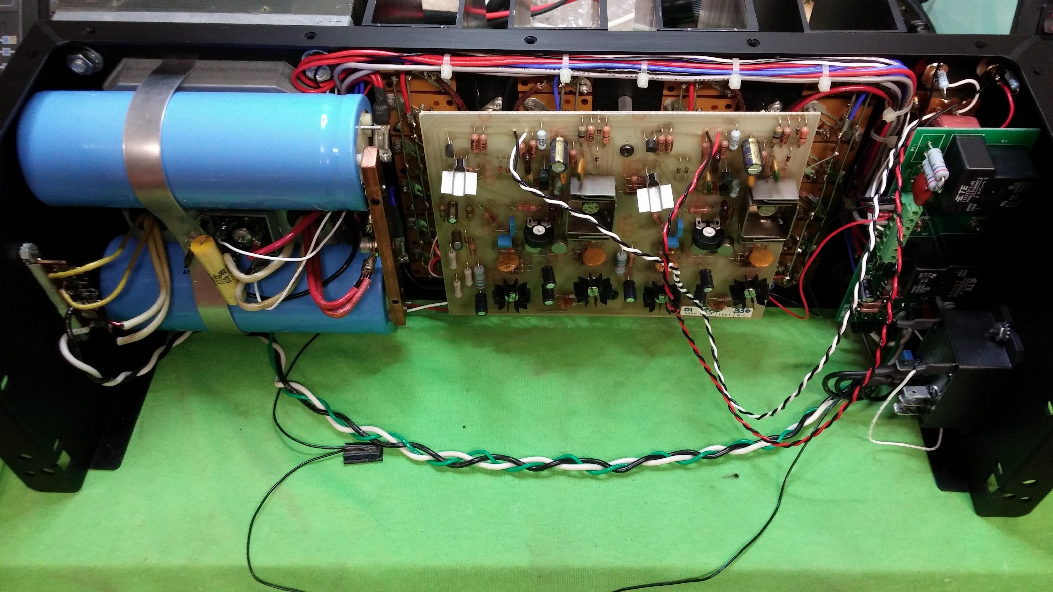

Anyway, I'm just buttoning things up now. I included a picture of the amp as it sits now with the relay pcb installed.

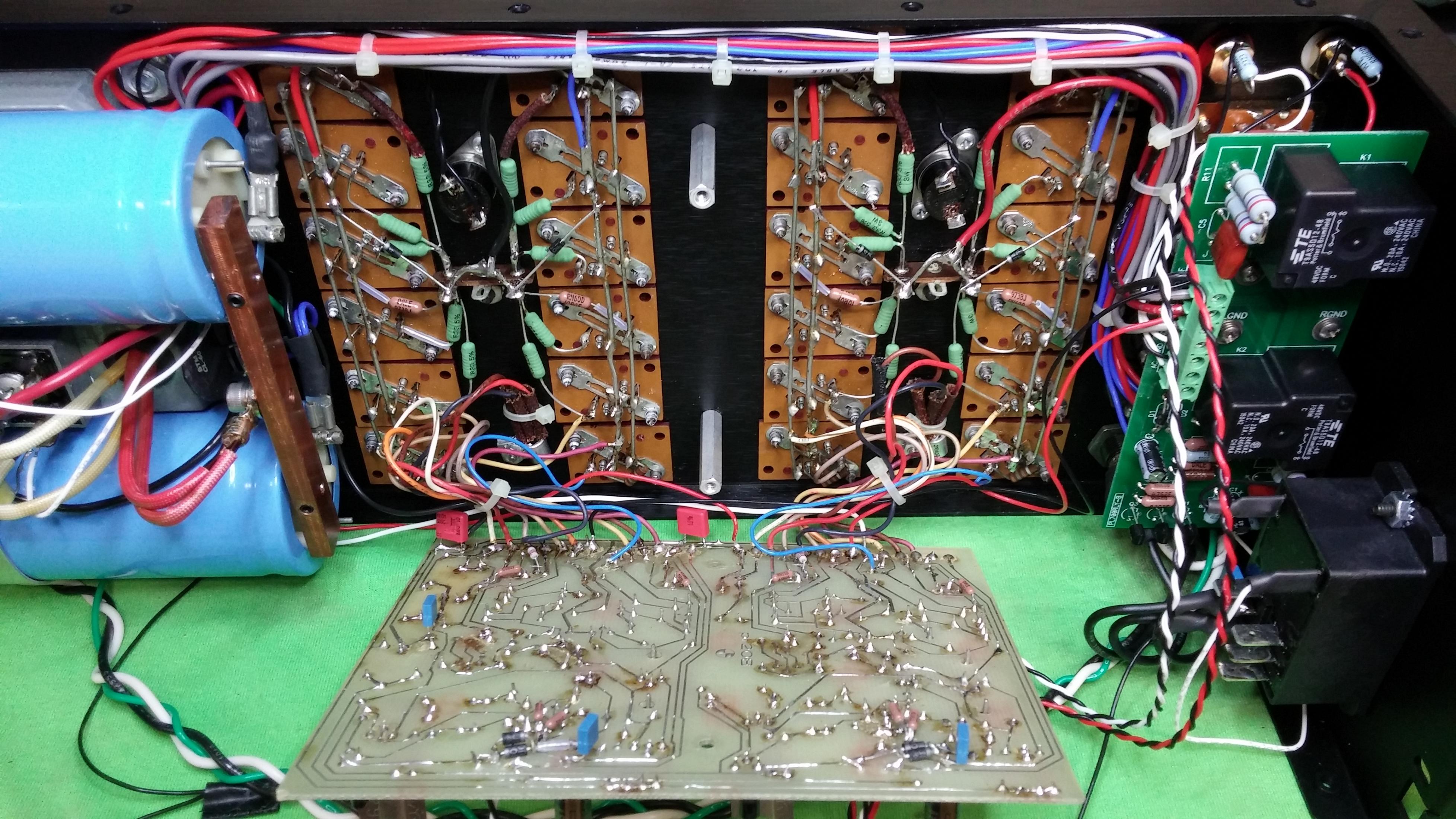

I finished up the amp tonight. Boy this was a big project! I knew it would be, I just didn't expect the learning curve to be so high. I've still got to put the face plate on, but I finished up a couple of hours of driving it at 100W rms into a dummy load at various frequencies. It looks like 425mv of bias should be just about right.
A summarized list of the changes I did to the control pcb is as follows.
> Installed MPSA 18 input diff pair (Q1/Q2) in place of TIS97's
> Installed emitter degen resistors on Q1/Q2, I used 100 ohm as the larger values recommended by Steve Mantz exacerbate DC offset if the pairs aren't extremely well matched.
> Installed MPSA 92 for the Q3/Q4 pair in place of 2N5401/MPSA93 pair
> Replaced most of the front end resistors with RN60D metal films.
> Replaced C22/C23 with larger 4.7uF electrolytics
> C22 bypassed with .1uF/100V film
> Replaced C6 with 220uF bypassed with .1uF film and anti-parallel diodes to minimize chances of rail latch-up.
> Replaced all other electrolytics with Panasonic FC's of the same value.
> Pos & Neg rail bypassed with .01uF/250v WIMA MKP's
> Installed 2N5088's (recommended by Joe at White Oak) in place of the 2N3403 bias temp control transistors.
> Rebuilt the bias network to match the later PL36 control pcb.
> Installed 2N3440/2N5415 in place of the Q10/Q7 (40327 & 4033)
> Added 60r 1/8W base stopper resistors to Q7/Q10
> Added 2.2r 1/2W base stopper resistors to Q11/Q12
> Replaced C1 & C7 with silvered mica caps (recommended by THD+N)
> Moved signal input to the top of the control board right at the input pair.
> Moved feedback pickup points to the relay protect pcb.
I did not need to add base stopper resistors to the output transistors. This was recommended by Steve Mantz to eliminate oscillation, but was not needed on this amp.
In addition I rerouted all high level signal wiring and grounds to the top of the chassis. This left only the control pcb low level wiring at the bottom to hopefully minimize noise pickup. I also rebuilt the grounding to a more modern topology with the main chassis ground and circuit common star ground isolated by a 10 ohm NTC thermistor.
I attached a few more pictures of the amp and rebuilt back plane.
