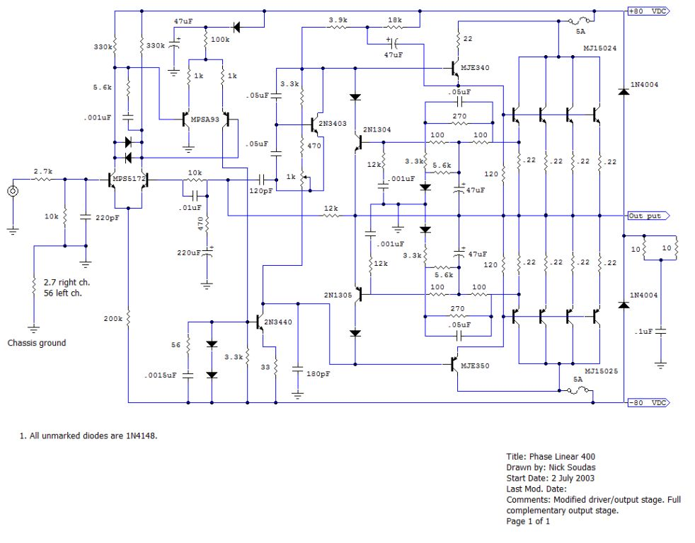

....I modified an original 400 in the following manner (and it seems to be running and sounding great. Measurements have confirmed it is stable and distortion is very low):
1. Changed the output stage from a triple Darlington to a standard emitter follower full comp stage.
2. Deleted the RCA410 driver transistors.
3. Rewired RCA410 driver transistor sockets to accept another output device.
4. Outputs - MJ15024/25, drivers - 2SA1306B/2SC3298B (Just happen to have a bunch of these)
5. Modified bias circuitry.
6. Bias is set for about 20mA thru each output device.
7. Protection circuit was not modified. I was going to tweak it but never got around to it. It still appears to work, but I have not recalculated its protection limits.
The distortion (nominal - 0.03% I think, maybe lower. It's been 12 years since I did the mod) is now flat across the frequency spectrum at 1 Watt and does not rise after 1kHz like the original circuit. Heat sink gets slightly warm while sitting with no music signal. Power output is the same as the original into 8 Ohm loads. 4 Ohm is slightly higher.
The sound is definitely different. Much smoother and more "transparent" if I were to choose an audiophile adjective.
Do you have a schematic of the changes?

Here are the schematics from the PL service bulletin for conversion to full comp.
View attachment Phase Linear 400II_700II Full Comp_Page 2.PDF
View attachment Phase Linear 400II_700II Full Comp_Page 3.PDF
View attachment Phase Linear 400II_700II Full Comp_Page 4.PDF

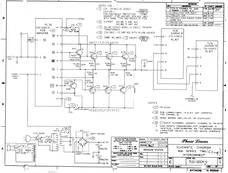

There are errors on the supplied schematics. I don't know if they were intentional (Doubt it), but the errors have caused a lot of confusion for DIYers.
The positive drive / rail connections are correct for both 400II an 700II conversions.
The errors are in the negative drive / rail connections - 3 / 17 / 28 and 29 are the connections in question referring to the driver circuit schematic (Marked as Page 2 here in the forum listing).
Referring to the 400II output stage schematic (Page 3)
1. Connection 3 and 17 should go to the fused side of the negative power supply rail which is not shown correctly. Shown, 3 and 17 go to the base of Q108 which is incorrect.
2. Connection 28 and 29 should go to the base of Q108.

Nick, Thanks for the additional info and schematics on your modded PL amp. It looks interesting. I like the added low impedance drive capability you worked into the output stage. I wish you were more local I'd like to give it a listen. Just in case someone wanted to see the proper connections on the factory PL full comp amp. I used MS paint to correct the errors on PG3 of the PL400II full comp factory schematics that Nick posted previously. This would of course apply to the PL700 as well.

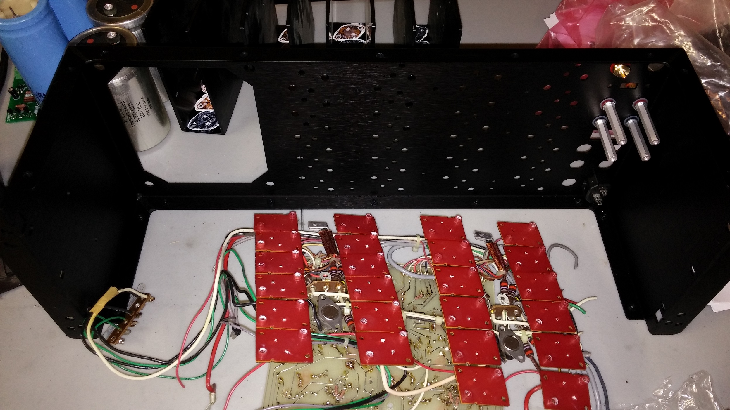

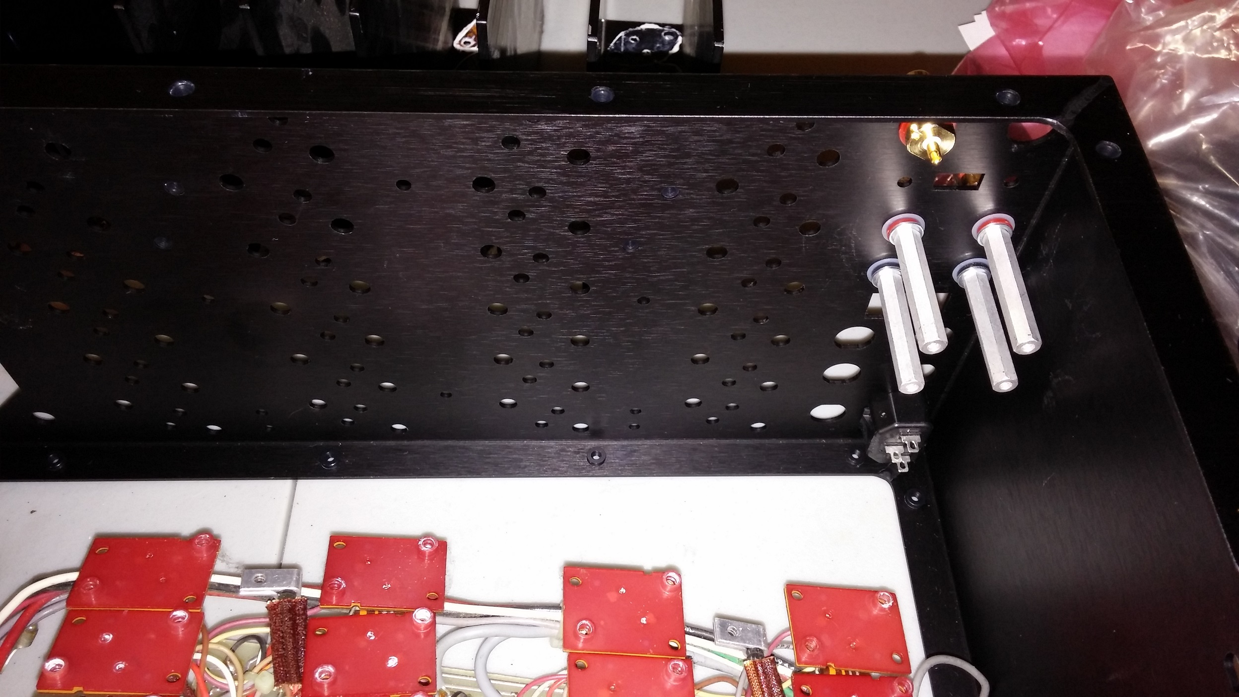

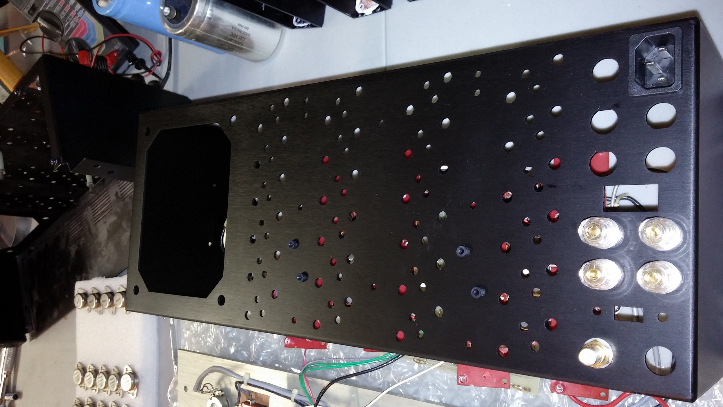

Here are a few pics of the new White Oak PL700 chassis before I begin building it up. As you can see the new binding posts are in and one of the Vampire RCA's I'll be using. The chassis is all aluminum with boxed & welded corners as well as threaded inserts for the covers and temp switches.

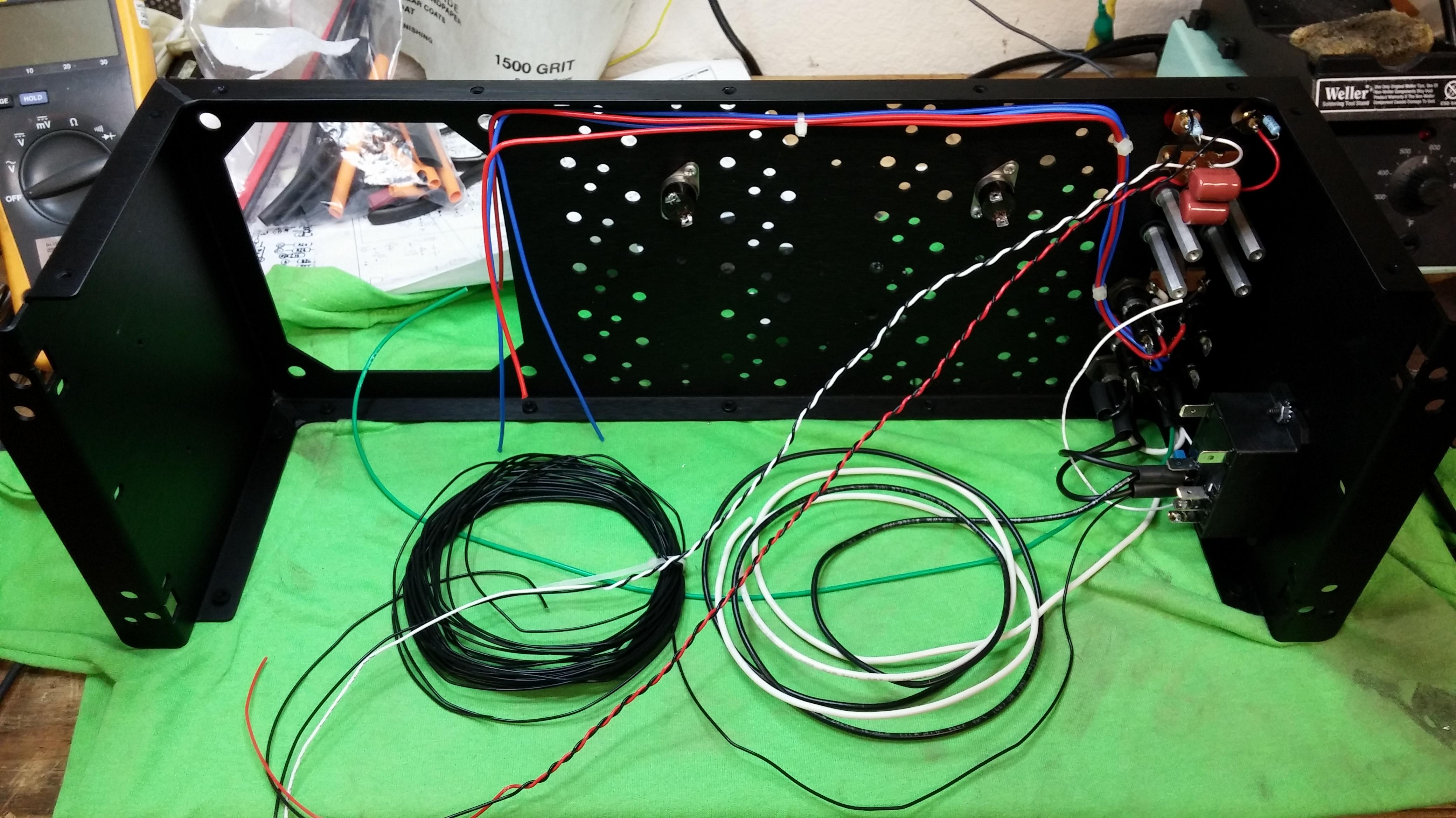

Making a bit of progress on this PL700 refurb and full comp conversion. I have the wiring just about completed and will be starting on the backplane soon. I installed a new slide switch for the DC/Capacitively Coupled selector. I found that mouser PN 10SS002-EV is an exact replacement and its only a little over $1. Its actually nicer in that it has a threaded mounting plate and doesn't need backing nuts like the original. The original coupling caps were also replaced with 2.2uF Panasonic metallized polypro's. The large relay (30A contacts) will be the new power contactor replacing the original undersized microswitch. I'll be wiring the temp switches into the relay coil circuit so it'll still shut down in the event of an over temp.
