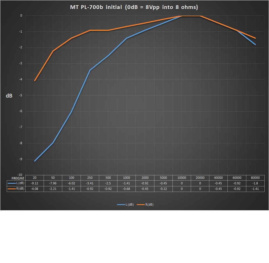

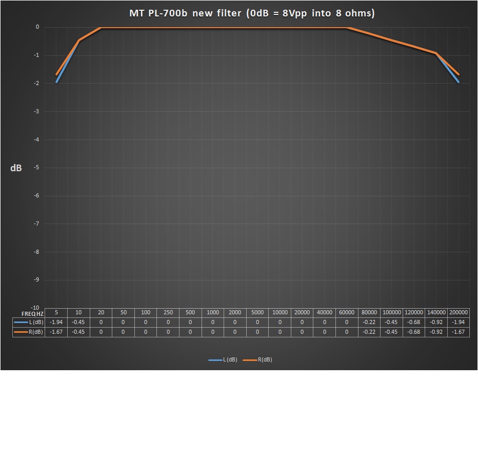

Actually depending on how bad the feedback caps are, you just might notice a big difference. See the attached L & R channel freq response plot of the amp I tested before I started the upgrade work on it.

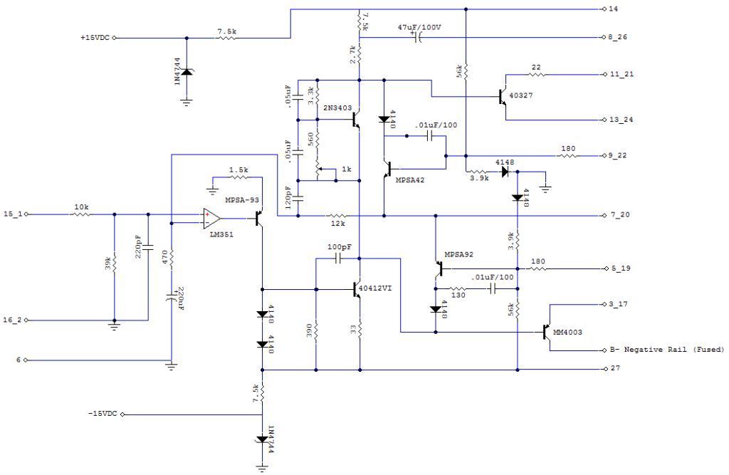

Attached are the PCB and driver/output stage schematics showing the modifications. I also changed the original Miller capacitor (100pF) to 39pF which extends the bandwidth up to 100kHz. The amp appears to be stable so far. I also had to change R106 from 680 Ohm to 560 Ohm to get slightly more bias voltage out of the Vbe circuit.

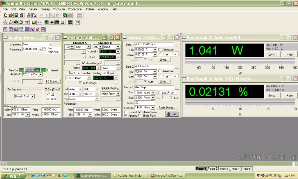

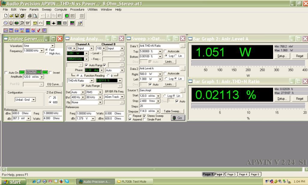

Overall, THD+N is down across the frequency spectrum and it appears to be more linear. The rise beginning at 1kHz in the original circuit is now gone. The modified circuit THD+N at 20kHz, 1 Watt is only 0.06% (Left) and 0.08% (Right).
700B Full Comp_Mod_Frequency Response vs THD+N vs Amplitude_DIY.jpg104.1 KB · Views: 155

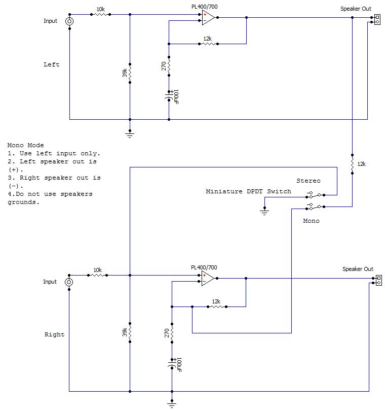

A 400/700 original series or series two can be bridged. There are various methods available to bridge an amp.
The easiest way (in a general way and not applicable to all amp designs) is to tap off of the (+) output from one channel (let's say the left) and tie this connection through a resistor (same value as used in the feedback loop) to the right channel (-) input. The "normal" right input is not used.
This is not the optimal way (DC offset is affected some, depending on amp design) to bridge an amp, but it does work and it is practically free to implement.
See attached image.

Every amplifier with feedback has a dominant pole. That makes the amp have 90 degrees phase shift in feedback at unity gain. You can't add other poles (capacitors) to the design and expect stability. The dominant pole in the Phase Linear 700B is C10, 180pF. If you add another 100pF across that cap, oscillations will go away. I can't remember what I added to my amp 30 years ago. Carver should have placed the cap between base and collector of Q5 in parallel with that transistor's internal Miller capacitor. That way a high hfe transistor would be compensated by more negative feedback. The dominant pole usually is associated with the high gain stage of an amp, and in the 700B, that is Q5.
