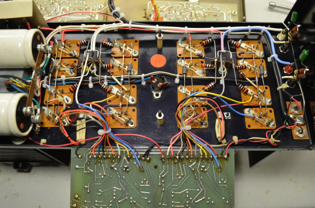

I'm working on a PL700b for a friend. As the title says, its completely original and currently working fine. My friend wants it gone through completely as well as having it converted from the original quasi complementary output stage to a full complementary output. Before getting started I've done a lot of research on this amp. I've found quite a bit of info on what to do in the way of upgrading it, but the conversion info is spotty.
My big concern is that I perform the quasi to full comp conversion properly. I've redrawn the original schematic for the PL20 control pcb to show the planned changes for the conversion. I'm hoping there is someone familiar with these amps that can tell me if I'm on the right track or if I've missed something.
I've attached the original and modified drawings. Any info would be appreciated.
Looking at your redrawn schematic, you are on the right path;
- Remove R23, R34, R35, D13 and C18.
- Remove R41, 0.33 collector resistor (Protection circuit)
- Install jumper where R23 was.
- Where you have indicated to "cut trace", this wire and can be rerouted and connected to B- for Q7 collector negative power supply.
- A new wire needs to be connected from the emitter of Q7 to the base of Q12. This is your negative base drive.
- "Base Stopper" resistors would be a good idea to insert between Q7/Q10 and Q11/Q12
To rewire the output stage transistor sockets, you can use solid copper 18 gauge wire from Home Depot/Lowes and strip off the insulation. This wire will bend and solder easily.
I'll upload some pictures of the 400II output stage I modified later (Not at home now).

Maybe Chamberman did. I don't know. He PM'd me and asked if I would give him some advice.
I've done a few full comp conversions with the original driver board. From what i can recall, I didn't cut any tracks on the board. Instead I installed Q7 backwards.
THD+N, Thanks for following up on the specifics of the conversion and looking over my doctored schematic. I looked at what you said about cutting the trace and I thought yeah that makes sense. Then I started wondering why I decided to cut the trace. I realized that when I started doctoring the schematic I started seeing it on my laptop as one big board, output stage and all. I completely forgot that it was a control pcb wired to a back plane when I was deleting components and modifying traces. Looking at what D3IMLAYsays about rotating Q7 looks like it might minimize the work, I'll be installing new transistors at Q7/Q10 anyway so I might as well install Q7 backwards. Then when I pull R34 I can run a wire from the emitter straight to B- using the vacant R34 hole in the board.
You are right, I will be bringing up some other topics about this to hash out with everyone. I have a few ideas already, but I'll save them for now.
To answer your question on where I'm at in the process. I'm still in parts gathering/planning mode right now. I have the wattsabundant relay protect board on order. I bought a set of 24k uF/110V main caps and a new 50A bridge for the power supply. I started working on the PL20 control pcb as well. As I said early in the thread I'm going to do a lot of the upgrade work to the control pcb to begin with while the amp is still a quasi. I am going to be buying a White Oak PL700 replacement chassis as the one this amplifier is in is bent pretty badly to one side. The WO chassis are currently out of stock but should be available later this week some time. Once I have the chassis I'll place one big parts order with Mouser for all of the remaining parts. Then the BIG work will begin.

I did a bit more work on this 700b control pcb this weekend. The Q1/Q2 TIS97 input diff pairs were replaced with some matched MPSA18's. The second diff pairs Q3 TIS93's & Q4 MPSA93's were replaced with matched pairs of MPSA92's. A couple of the Q1/Q2 TIS97's hfe had drifted badly, the 4 of them measured 610, 600, 520, 350 on my meter. I also installed the degeneration resistors on the Q1/Q2 diff pair and the back to back diodes across C6 to eliminate the possibility of latching up to one of the rails. I've replaced a number of the front end resistors with Dale RN's as well.
I took DC offset readings before changing the diff pairs out and the offset for both channels was close to zero or so I thought. I kept getting blips of higher voltage when I was measuring it from the speaker posts and then it would drop to zero. It finally seemed stable at near zero on both channels so I went with it. After I changed the Q1/Q2 and Q3/Q4 diff pairs I checked the DC offset again and it started out zero, but once again getting blips of higher voltage. I inspected the binding posts and they are nearly black from 40 years of oxidation. As it turns out I was getting basically no connection by putting my probes into the speaker posts. So I do not know for sure what the pre change out DC offset readings were. I started measuring offset from inside of the amp to get reliable readings. After changing the diff pairs I now have 39mV and 45mV on the two channels. Not horrible, but a little high.
I'm wondering what the reasoning was behind PL using the mixed pairing of TIS93(2N5401) and MPSA93 for the second diff pair Q3/Q4 for the PL20 control pcb. These two have quite different hfe readings, the TIS93's both measure about double the hfe of the MPSA93's. In addition PL had installed a heat sink only on Q4 the MPSA93's. It seems like this mixed pairing almost guarantees DC offset issues or were they trying to cure a nagging offset issue in production by using this mixed pair? Ideas?
Anyway, the amp is working great. No thump at turn on, or turn off and it is silent when powered on without a signal. No signs of oscillation either on the scope or heating of the output zoebel. In addition, it sounds great when playing music, so all is progressing well.
The second diff pair is more of a "level shifter" to reference the VAS to the negative supply rail. Q3 / 2N5401 does not need a heat sink because the power dissipation of it is much less than Q4 / MPSA93 because Q3's collector is referenced to ground and not the negative supply rail as is Q4.
I think you will find that Q1 / Q2 will have the most influence on DC off-set, while other circuit parameters will have less influence, but still contribute to it overall.
Other designs solve that problem by cascoding that transistor so the 2nd diff pair is more balanced. Even if the transistors are matched, the pair will only really remain in balance if the operating conditions for the pair are the same.
