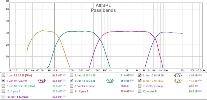

The measurement plot below is typical, for my active 4-way builds, using the xover method I've been describing.
Each of the passbands shown are acoustical measurements, not electrical.

May we see your plot without smoothing? A photo of the speaker would be good too!
TBH, it does look a bit TOO perfect:
789033d1571585058-phase-time-delay-rew2-passbands-jpg
But no criticism implied. Just a four way is totally beyond my experience. 😱

Yeah for sure. That was a old plot (when I needed smoothing 🙂 just to show 4 passbands to System7.
It was a PA setup that didn't need real low extension.
I've since built and use subs that are f-3 at 30Hz, which is good enough for me as I don't came about HT.
I quit making such passband plots, as tuning became too easy, and I felt silly in just showing pretty graphs.....
But I do have alot of full 4-way plots that I'll find and look thru, to illustrate the tuning method's efficiency...on several different designs.

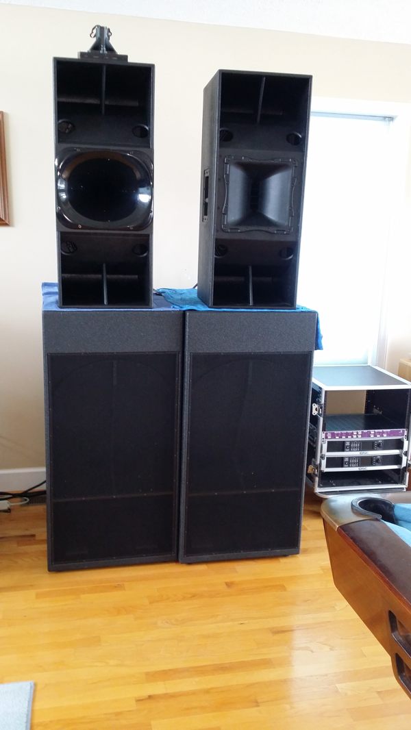

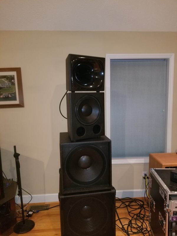

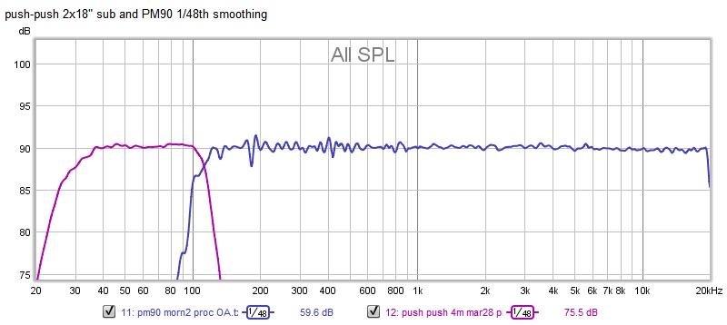

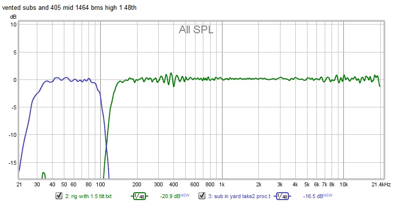

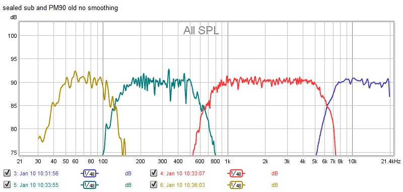

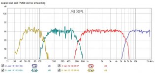

here's some plots all without smoothing, and some picts as requested.
First plot is same 4-way posted before, with smoothing removed.
It goes with the top right hand speaker on pict that follows, but with a smaller single 18" sealed sub, not the subs shown in pict. Top is the PM90, a 3-way box known on the forum.

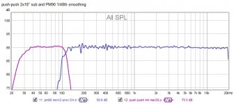

2nd plot is a recent redo of same speaker on a double 18" push-push reflex sub. But without separate plots of the top's three passbands.
Like said in previous post, I quit keeping individual sections after processing because I knew the drivers would work together.
As an aside, I was happy to see how me tuning on the same top has improved a bit over the years.
3rd plot is a modular system using a single 12" in its own box, and a coax CD in its own box, on top of as single 18" vented sub. It's what's in the second pict minus the smaller sealed sub sitting on the vented sub. I have a double 12" modular mid that plots the same.
A big part of the logic behind the crossover method I've been proposing is that it allows easy experimentation and interchange of different drivers, horns, boxes, and subs.
It's easily achievable because once all the drivers' flattening is accomplished, complementary crossovers can be moved around at will without any need to re-tune the drivers.

Very nice, thank you. What is is to be a single man!
How do you get the bass response plots? Do you drag all your gear outside for free field measurement?
Thx ! and Lol...I guess my room screams single 😉
But truth is, I have a wonderful girlfriend...who gets her own house space too, for her to muck up.
(After countless years of marriage, I learned what to look for in a partner, and what kind of deal to make 😀)
Yes re measurements... for subs I go out on the driveway in front yard.
For tops I measure off a deck off the back of house, unless it's a critical measurement, then out front too.
Subs are easy, done once, done forever. Tops will always be a pursuit i guess...
