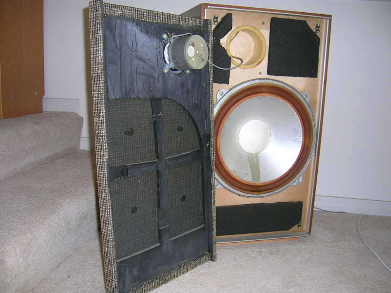

I always have liked a good loudspeaker, and listened to a few outstanding examples as a young man back around 1973.
This tune caught my ear, playing the lively drum and bass bottom section of Led Zeppelin's Black Dog.
Best speaker for that hideous but enjoyable racket was the Gale 401:
We call that great bottom end of a speaker "Slam" or "Projection". The Gale had it in spades. 😀

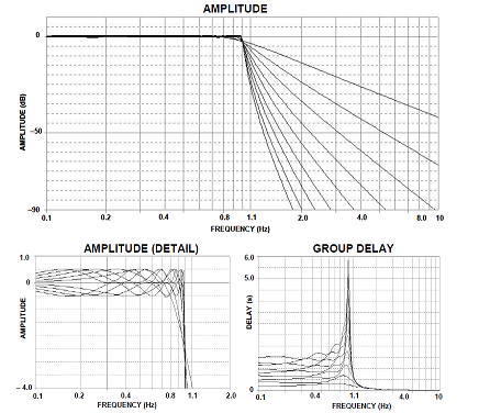

This is possibly not a great time to talk about how a steep filter introduces more phase shift and even more group delay than a shallow one.
It's built into the laws of physics, that steep slopes equal steep phase shifts equals more group delay. A differential relationship for those who know function of a complex variable. Phase is the first derivative of frequency "w" versus time "t". Group delay is the second derivative.

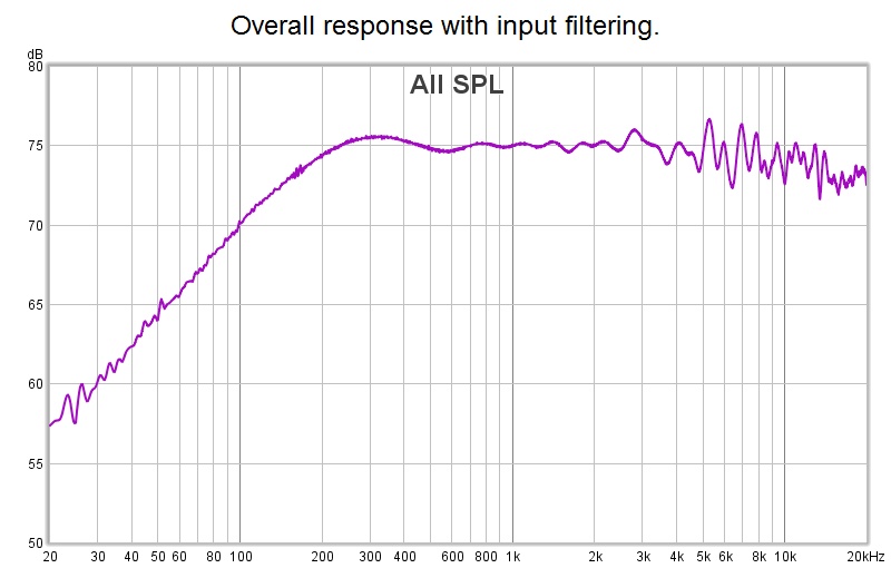

I took a shot at this today and found that it worked well. The only disadvantage to flattening each driver's response individually is that it uses lots of filters. I used a couple of input filters to flatten the overall response somewhat from around 200 Hz to 3 kHz, so there's not much left for room EQ. I might try dialing down the WM gains a little tomorrow instead. Here's where I'd got to by the end of the day:
Nice graphs indeed. Of course nothing comes for free, everything has a price. There are other filter saving methods. You can combine the driver's natural roll-offs with the filter without flattening, similar like with passive crossovers.
For example: if you have a BW2 roll-off naturally, you need to apply a BW2 filter to the same frequency and you get a LR4 response for that frequency, because LR4 is comes from two cascaded BW2 response.
Or simply check where the frequency response is flat in a relative wide range and apply a LR4 (or whatever slope you want) to that region.

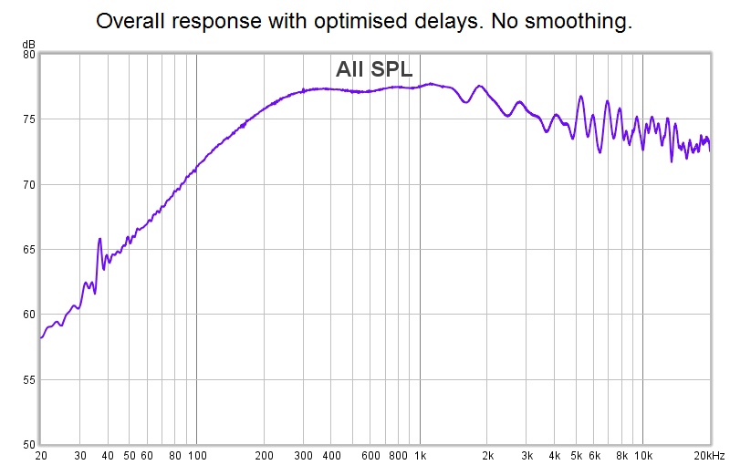

Ok, the starting question was hypothetical, but check the the opener's result in the last graphs, i think he is now more understand the situation.
Again, if you want to eliminate the low frequency driver delay (e.g. 1 period delay for LR4) caused by the crossing with physical movement, it does more harm than good to the sound at least in the phase domain.

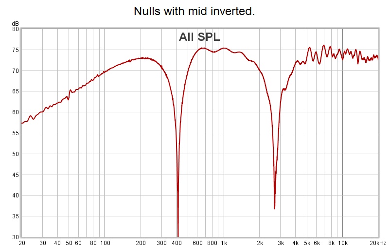

However, these produce only shallow nulls with the mid inverted, and tweaking them by a few hundredths of a millisecond either side makes the nulls even shallower.
