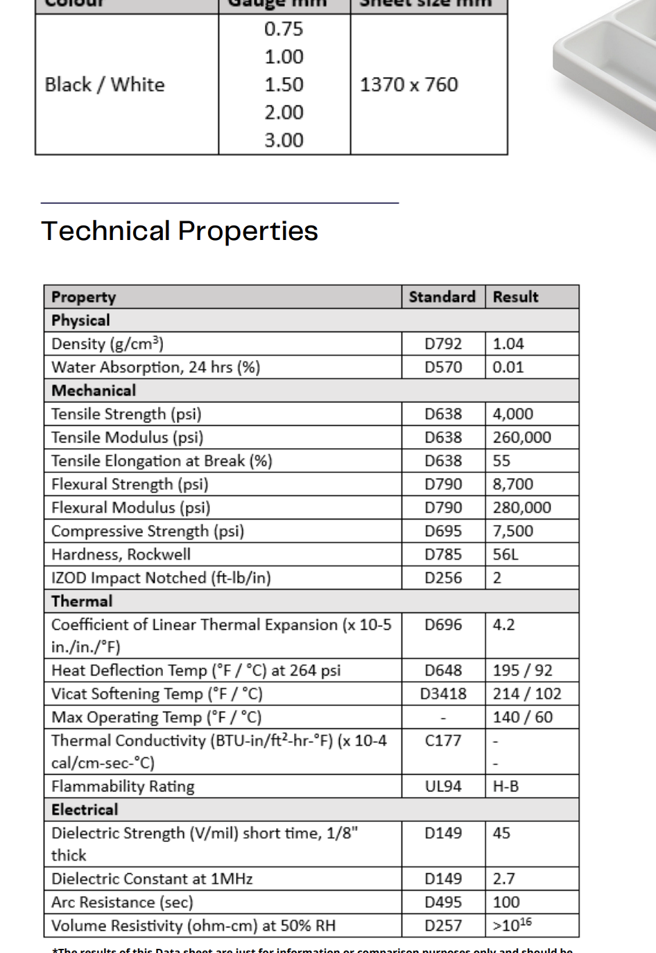

Do you know what is this transparent variant of PS used as protective glass for frames
In my experience..acrylic Christian
acrylic
Picture frame glass and acrylic both come in clear finishes. This choice is common for most artwork and photography, especially for pieces with vibrant colors. It offers full, window-like clarity, allowing all the detail to pop right out of the frame.
acrylic
I also thought so, until I read what Wiki says:
"Polystyrene (PS) /ˌpɒliˈstaɪriːn/ is a synthetic polymer made from monomers of the aromatic hydrocarbon styrene.[5] Polystyrene can be solid or foamed. General-purpose polystyrene is clear, hard, and brittle. It is an inexpensive resin per unit weight. It is a poor barrier to air and water vapor and has a relatively low melting point.[6] Polystyrene is one of the most widely used plastics, with the scale of its production being several million tonnes per year.[7] Polystyrene is naturally transparent, but can be colored with colorants."
I have never seen transparent polystyrene myself. This is all new to me.

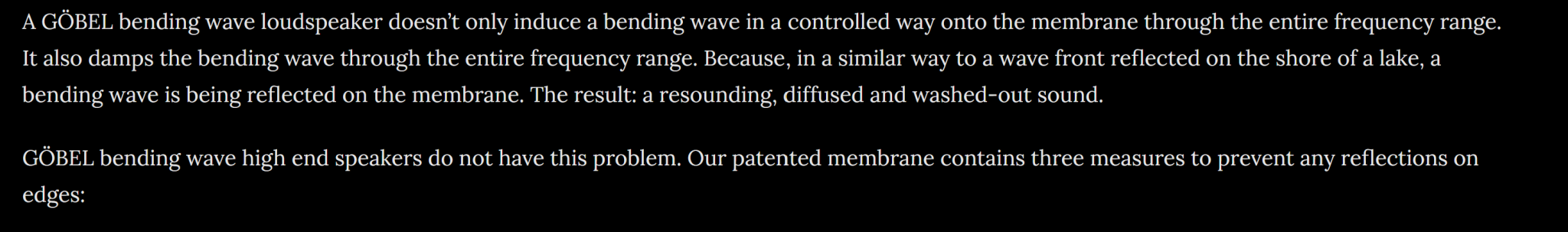

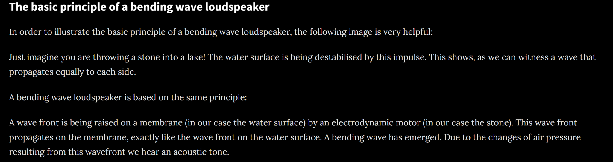

In flat panel speaker "lore" there is a lot of idealization of the "pebble in pond" wave, as in these snips from the Goebel site:
I've always thought that the Goebel site was at least a little "hyperbolized" (like most audio lit), but now I'm more convinced that there is really no great advantage of the PIP pattern over the simply "localized" pattern. Both excite a sufficient number of modes to produce a very wide and even radiation pattern. So I'm a a lot less inclined to target the "PIP" response over a wide frequency range, if the "localized" response provides similar directivity without the need for extreme damping measures.
Does this make sense, or am I missing something?

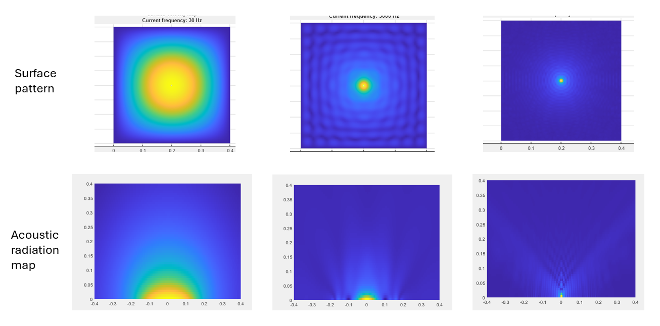

Eric -
I've been thinking more about the high-frequency schemes, and I think there's more to be said that's difficult to quantify...
One of the perceptually interesting things about sound coming from a panel is that the source really is "distributed" over space, as opposed to a traditional loudspeaker where the size of the driver is normally meant to be much smaller than the wavelength of the reproduced frequency, so that the sound appears to emanate from a single point. The picture below is one example of how modal patterns produce a really distributed acoustic source, the "localized" pattern is somewhat in between, and the PIP pattern is a very localized source. The bottom row of graphs is a nearfield SPL map with the speaker at the bottom center.
The PIP pattern is probably almost always above coincidence, though, which muddies the results a bit.
