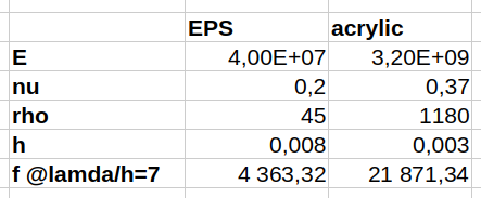

Hello Eric,So here it is: Please check my math!
The math seem ok to me. Nice finding.
From your graph, PETTaLS overestimates the mode frequencies for about 10% for a ratio lambda/thickness = about 7.
For the plates you tested :
Which is in fact already in your first graph!
This error being on the modes and as they have a high density in those ranges, I wonder what is the effect of this error. Other errors in the model like the damping behavior are also possible with a high impact on the SPL.
For now, I am more in the opinion of a use of a simulator in the low to mid frequencies where there are design choices to make. In HF (above some kHz?), the material leads the SPL. There is then almost no more choice than an other material if needed.

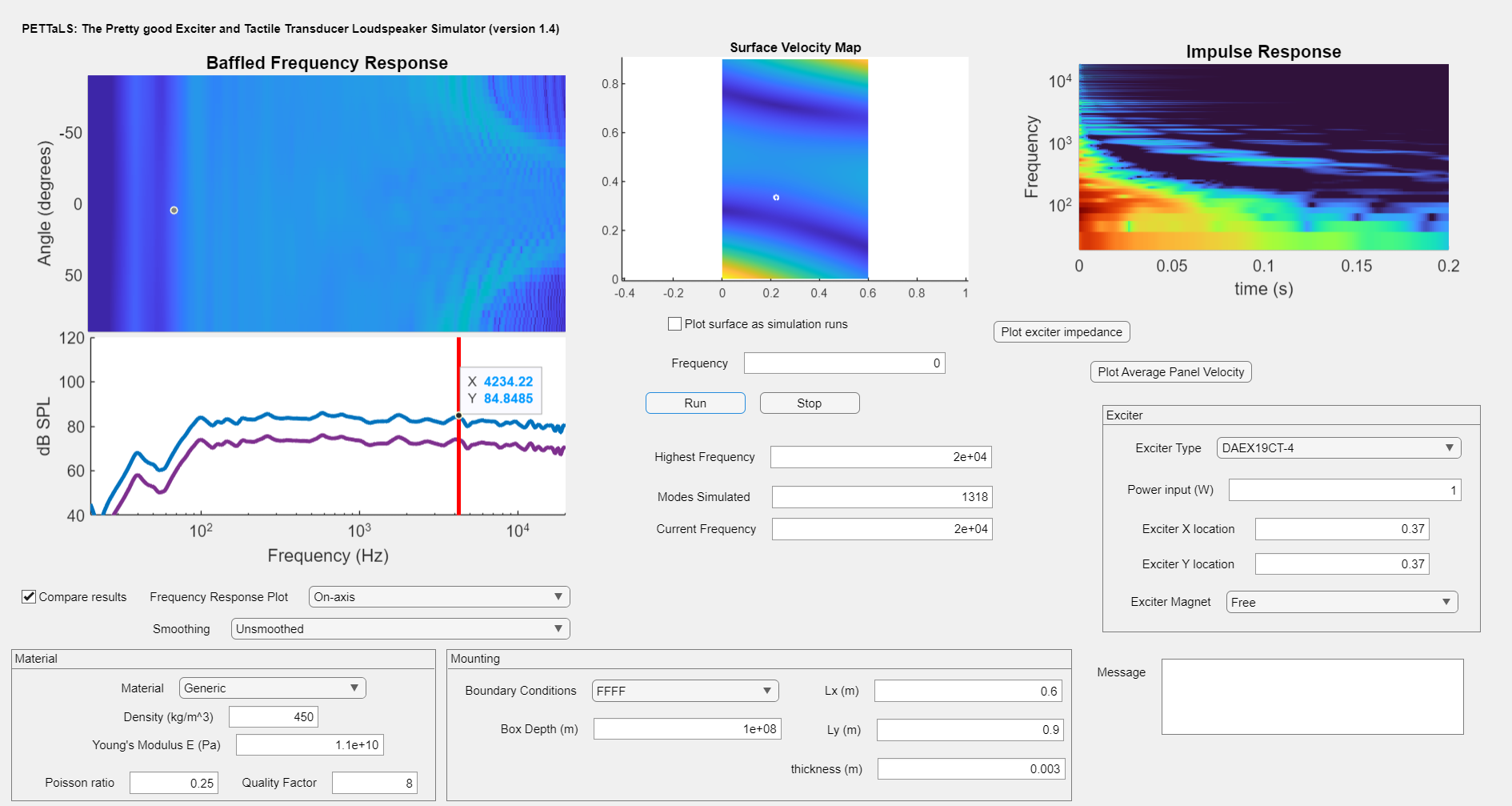

In your post #13765 in the main thread, you show the simulation of a 900x600x3mm plywood.
Is the plot an export of PETTaLS? The frequency range seems linear not log?
Which E, rho, Q for this simulation? In my experience, at least with poplar, the coincidence frequency is higher (13kHz across the grain and maybe 10 to 11k in the other direction).
This is curiosity. It doesn't change what you wanted to show.

Hi Christian
Yep..I need to check the properties...I thought the same thing but didn't go back to check it.
It was supposed to be rho 450 kg/m3, E of 6.6e9, (can't model anisotropy yet), and Q of 8 which is probably low but only affects the spikes anyway.
Yes... It's a direct save from the Sim.
Eucy

I can't explain or repeat how I managed to get a linear plot - a mystery only Dave can maybe solve.
I was using too low a value for E - should be about 10e9 or 1e10 for the longitudinal direction. However, the coincident freq plots at around 4.2k for the amended E value.
And yes - it doesn't alter the outcome of the fixed vs free SPL level comparison

I'm not sure why it reverted to a linear frequency scale. Has anyone else ever seen this?The frequency range seems linear not log?

I don't think so, but perhaps this is an issue with agreeing upon the correct material parameters for each type of wood? It seems like woods have a broad range of possible densities, Young's Moduli (moduluses?), etc. This is obviously true because the quality and density of wood varies depending on rainfall, temperature, old growth vs. farmed, etc.So is there an error in the coincidence freq calc??
Poplar seems like it's fairly stiff but not very dense - closer, actually, to something like gatorboard than to acrylic. I had to reduce the thickness of poplar to 1mm before I got a coincidence frequency above 10 kHz. Maybe a poplar plywood is more dense, or less stiff, and therefore has a higher coincidence frequency?
Not me.I'm not sure why it reverted to a linear frequency scale. Has anyone else ever seen this?

That is a pretty nice frequency and directivity plot, I think. But I'm inclined to believe that the real Q for a free plywood panel would be over 20. In an early post on this thread I showed an estimate of Q=20 for a free PMMA panel based on impedance measurements. Christian reanalyzed my data with probably a better method, and got 15. I also have measurements of plywood panels (see below) that show considerably less damping than PMMA. I have not yet tried to tease out the Q from those measurements, but inspection of the impedance curves suggests a significantly higher Q for the plywood than for the PMMA. I would guess FFFF plywood to be somewhere between about Q=20 to 50. The only caveat I would add is that for such a large panel maybe there would be some damping from the "acoustic loading".
