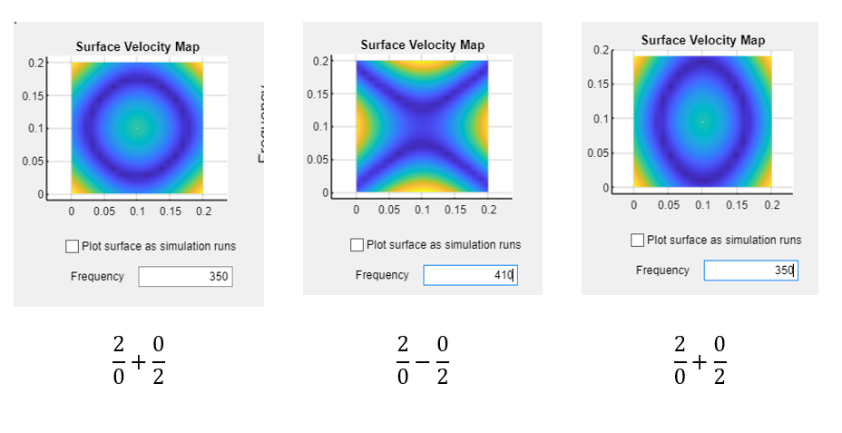

Hello Dave,it could just be that the analytical expressions are less accurate for the free edges than for the clamped or simply supported edges, but I'll keep looking into it.
My understanding is PETTaLS is based on GB Warburton's paper for the modes and mode shapes calculation. Is that correct?
Only the simply supported case has an analytical solution which includes in the paper. For the other boundary conditions, it is approximations.
In the paper square plates and some other proportions seem to need specific solutions.
Is all of that part of PETTaLs?

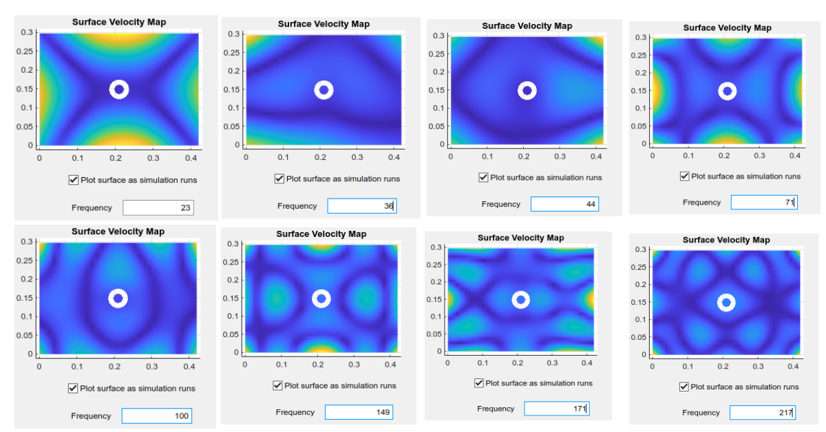

Hello Dave
I just downloaded 1.3.
One remark about your web page : the link to PETTaLs at the beginning of the page goes directly to the .exe (so Windows) when the link below goes to Github with the 2 versions Linux and Windows. Both on the page are "Download PETTaLS free".
This is not my main point.

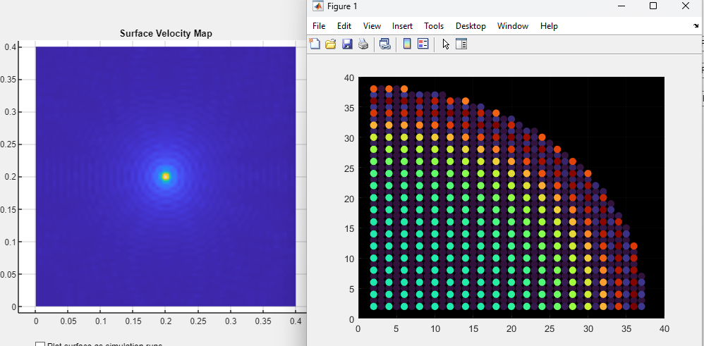

I am trying to make impedance measurements to get some material parameters like the quality factor. I tested an exciter DAEX25FHE and a piece of Depron (XPS), 6mm thick in A3 format.
In order to try to understand which mode is behind the impedance peaks, I ran a simulation.
The exciter is at 0,5 / 0,5. The strange point is PETTaLS shows asymmetric mode plots. Not sure it is important but I don't see physical reasons to that.
The simulation :
Some frequencies I picked from the peaks in the impedance plot : see the asymmetry 23 (at 0,0), 34, 44, 100Hz (at 0,2 horizontal) for example

Yes, I switched over to all equations from this paper for consistency. They seem to work very well. My reading of the 'extra modes' section for square and nearly square plates is that this is descriptive rather than prescriptive, e.g. the square plates have interesting modal patterns that emerge from the overlap of multiple actual modes which have node lines that are not parallel to the panel edges.Hello Dave,
Christian
For example, here are some of those FFFF special modes in pettals with different aspect ratios and driving points:

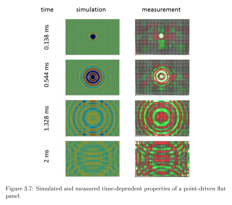

Dave,
I would like to get back to the question of "pebble in pond" or PIP waves, because I still am not sure that I understand how, or even if, they are considered in Pettals. I don't love the PIP analogy, but at least I think you know the conversation I am referring to. To be clear, I'm not looking for a quick response. I just want to keep it "on the table" for discussion. I don't mind at all if you focus on Pettals first. Reply at your leisure!
I want to try to rephrase the question, because I'm not sure I have done a good job of that so far. Let me try this way, sorry if I am repeating myself:
Considering generally high frequencies, we know that the surface velocity profile in Pettals becomes concentrated around the exciter. If I understand correctly, this happens mainly (or entirely?) because at high frequencies all the driven modes have an antinode at or very near the exciter, and those antinodes move in phase with the exciter. Hence the net velocity there is high. Further, at any significant distance from the exciter, those same modes may be in-phase, or out-of-phase, with the exciter. Hence, as you move away from the exciter the net average velocity tends to fall. Is it correct so far?
But now consider separately the situation where the damping in the panel or the perimeter is strong enough that the reflections from the perimeters are so weak that modes don't really develop. The only bending waves in the panel propagate radially from the exciter and decay as they move away from the exciter. (This is what I mean by PIP waves). The waves in this case would have a crest that starts at the exciter and travels out radially and loses amplitude as it does so. These are clearly waves of a different sort than the former waves. However, even these latter waves would have a similar average velocity profile as the former ones. That is, both types would be centered on the exciter and decay in magnitude as they get farther away from the exciter.
All that said, I guess my questions are:
Thanks,
- Is this a reasonable description of the possibilities for bending waves of significance?
- Does Pettals consider both those types of waves, or only the first?
- Would the radiation pattern (i.e. beaming/diffusion pattern) of the two wave types be different?
- If there are waves only of the latter type, would the sensitivity be so low as to be impractical?
Eric
Eric - everything you have discussed is all the same type of wave (propagating waves). All of these waves can be described either in the time domain or the mode domain. As you point out, though, there are really 3 regimes, and I've plotted an example of each along with its k-space transform (showing the magnitude of each mode that makes up the pattern):Hello Eric

- Modal: where the excitation point is not apparent, vibrational pattern is dominated by a single mode or very few modes.
- Localized (maybe): Vibrational pattern is distributed across the panel but is highest in amplitude around the excitation point.
- Pebble in Pond: Vibrational pattern is not distributed across the panel, is only localized around the exciter and decays quickly.
This textbook is a great reference on relating the time domain waveforms, k-space representations, and acoustic radiation. Unfortunately to answer all of your questions fully would essentially take up an entire course that covers this textbook!
The one difference where the two representations may not be equivalent is when there's some kind of nonlinearity or spatial dependence to the wave propagation.
Oh, I didn't even realize that there was a link at the top of the page. I took that out. Thanks!One remark about your web page : the link to PETTaLs at the beginning of the page goes directly to the .exe (so Windows) when the link below goes to Github with the 2 versions Linux and Windows. Both on the page are "Download PETTaLS free".
This effect comes from the discretization of the exciter shape (even the point force), which is almost always coming out to be a little bit lopsided based on whether or not certain points in the grid are counted as being part of the exciter shape or not. I'm still going to play around with finding a solution to this, but it shouldn't impact the results much.The exciter is at 0,5 / 0,5. The strange point is PETTaLS shows asymmetric mode plots. Not sure it is important but I don't see physical reasons to that.

Thank you Dave for the confirmation of the use of the Warburton's formula.Yes, I switched over to all equations from this paper for consistency.
How to explain the asymmetry I got? Note it happened on rather low frequencies.
Christian
PS : Ignore the question above... Sorry I have seen after your post 51.
What is the grid step?

I'm doing 250x250 for discretizing the exciter shape. This is scaled to the size of the panel, so larger panels have a more coarse spacing (only for exciter shape, not for mode shape). Now that you mention it, I should play around with this grid spacing and see how impactful it is...What is the grid step?

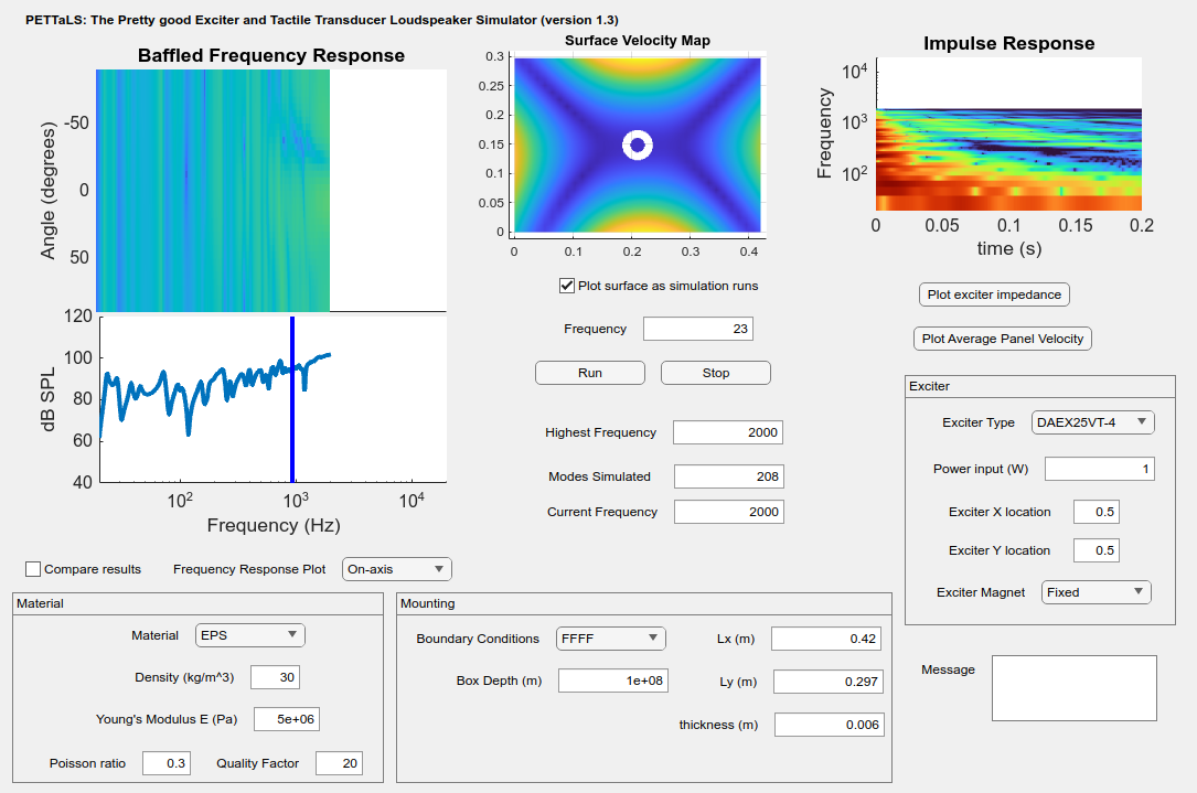

Just uploaded v1.4 to github with these changes:
- Added a smoothing option (unsmoothed, 1/6 octave, 1/3 octave, 1 octave). Smoothing is only applied to the SPL graph, not to the polar plot or the impulse response. The "compare results" checkbox allows you to keep previous results when plotting new smoothed results.
- The "compare results" checkbox now affects the new SPL graph, so you can compare on-axis to off-axis, etc.
- Fixed a bug in the code to implement the equations for FF mode shapes with odd indices.
