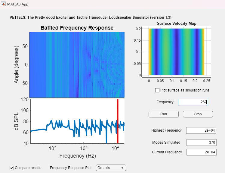

In the meantime I'm wondering about smoothing... If all these Q figures are so high then the fr graphs will look horrendous, and it makes the task of getting an acceptable panel response look rather hopeless.

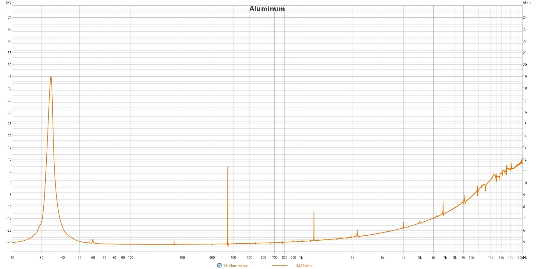

So that was really 9.5mm thick aluminum? I can imagine that having very high Q values.The aluminum peaks are so sharp. Are those numbers any good?

1. Yep, no smoothing applied.1/Are the fr graphs in PETTaLS raw, ie no smoothing?
2/ If so, can we get a smoothed response ?
3/ If not, can we get a text output to better fiddle with?
2. I can add in a dropdown for smoothing eventually. I've always been a little bit skeptical of smoothing in DMLs - most of the old NXT/Tectonic speaker datasheets always had a significant amount of smoothing applied which totally obfuscated the fact that there were significant peaks and ringing. But yes, I can always add it in, haha.
3. Yes, I can certainly do this too. Eventually!

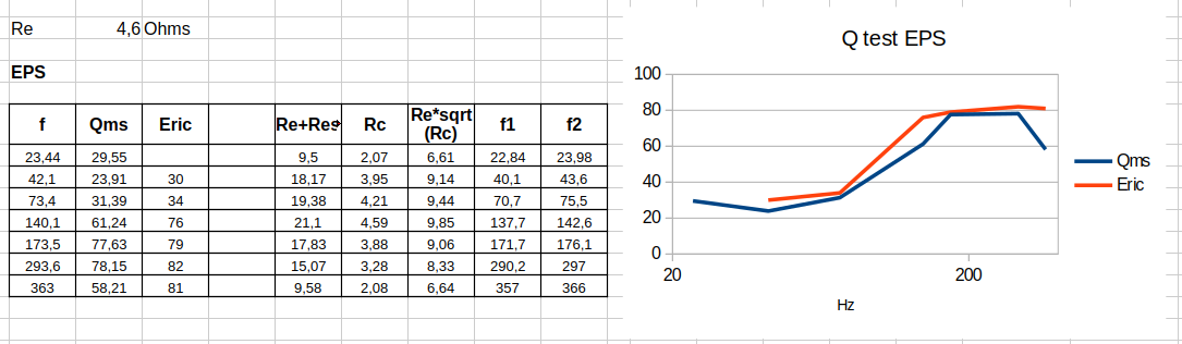

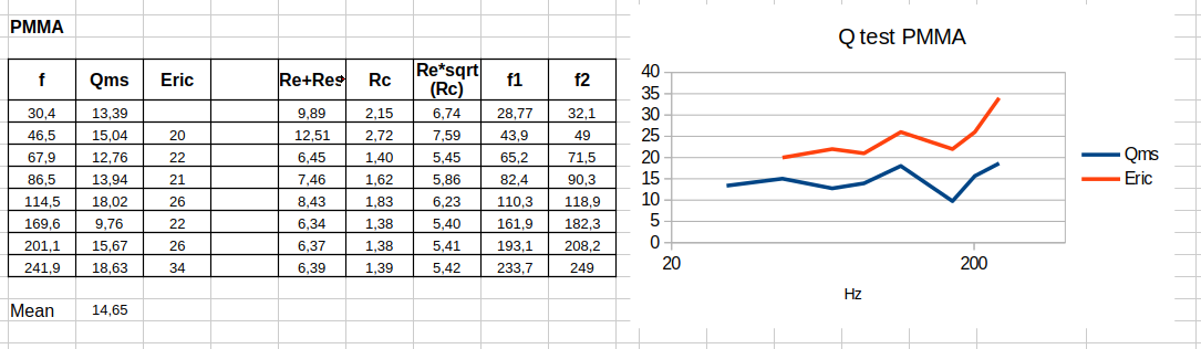

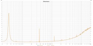

Hello Eric,I made some attempts to quantify Q for three different panel materials, using both the impedance test and tap test methods. The overall results look something like this:
PMMA (Acrylic) : ~20
EPS: ~70
Aluminum: ~1000
Are these correct? Not sure, but they were pretty consistent.

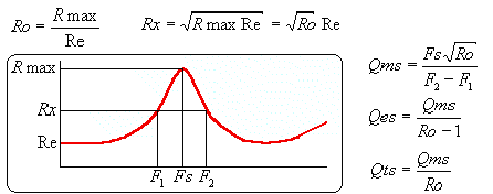

Here is a link Measuring speaker element parameters about the classical method to get the parameters of a loudspeaker from the impedance measurement. A single measurement is enough to evaluate the quality factor Qms of the mechanical system (the Q we are looking for).
The added mass technique is necessary to go further to get the mass and the stiffness.
Here is the Qms evaluation on a graphical form:
I don't know the math behind but this is standard for classical cone speakers. It is what I used long time ago, before REW.
I applied it on your measurements and compared to your evaluations. See below
The PMMA seems quite constant in Q in this frequency range.
The EPS seems of an other kind.
Christian
PS: Rc is from the link, same as R0 above.
PS2: Re+Res is Rmax

One minor point, regarding the lowest peaks (at 23 and 30 Hz for EPS and PMMA), I avoided those in my calculations because they are so close to the exciter's magnet resonance. But I suppose those are "valid" or not, depending on whether you are trying to measure Q of the system, or of the panel itself. I was looking at it from the perspective of the panel alone, so I was avoiding peaks that I suspected to be most strongly influenced by the Q of the exciter itself.
The aluminum result is an extreme example, but shows clearly my meaning. It would make no sense to calculate Q for the lowest peak here (34 Hz) and suggest that it reflects the Q of aluminum.
Eric
Yep. It is and it sure does. I'm not sure if 1000 is close to the true Q or not, but I think I could tap it before I went to bed and it would still be ringing in the morning!So that was really 9.5mm thick aluminum? I can imagine that having very high Q values.

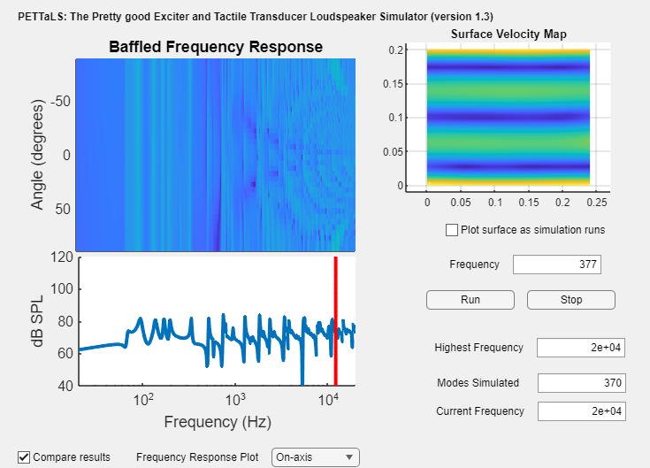

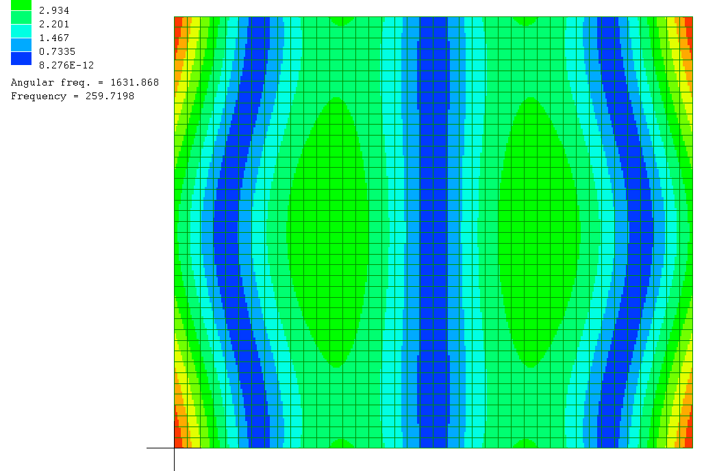

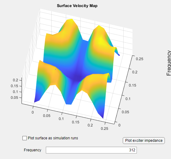

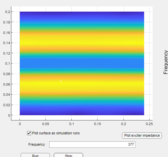

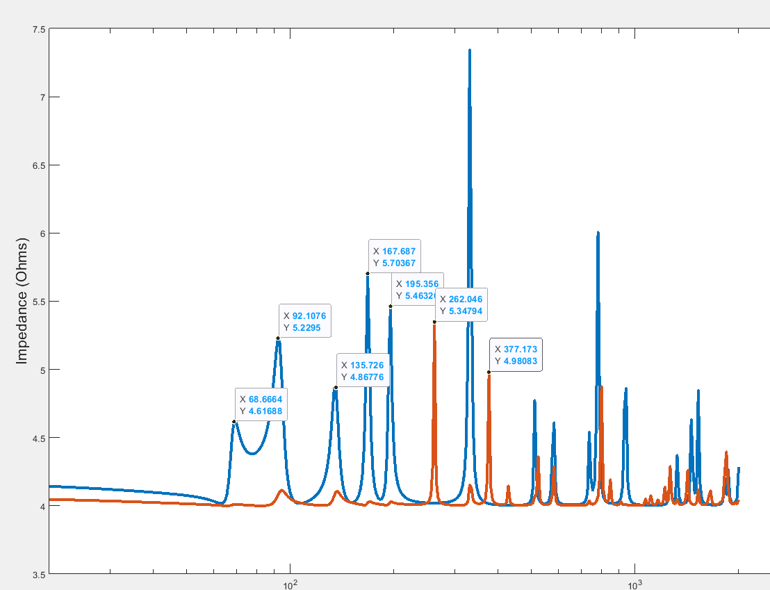

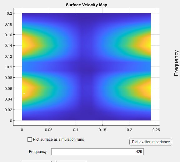

Meanwhile, I think there may be something amiss in the FFFF model. I was doing another test to compare the natural frequencies in the your simulation to those predicted by my FEA, but using the FFFF case. This time, in order to excite all (or nearly all) of the modes, I used a point force very near the corner (0.02,0.02). There was a little more difference between the two sets of predicted resonances for the FFFF case than for the SSSS case. But more importantly, some modes that should have been driven were completely missing in the Pettals simulation. There may be others missing, but the most obvious missing modes are the two below. Similar higher order modes (i.e. with five nodal lines instead of three) were also "missing" from the Pettals sim.
By moving the driving point to 0.33/0.33, I was able to "find" those missing modes, but they were not quite the correct mode shape. That is, the nodal lines closest to the edge are actually on the edge, rather than just inside it. So it's clear now why theses modes were not driven by the corner placement: the simulation thinks that the corner is a node for those modes, though it should not be.
See also the impedance plots. Note that the corner placement (blue) doesn't drive the modes at 262 Hz and 377 Hz at all, though it should (if the mode shape was correct).

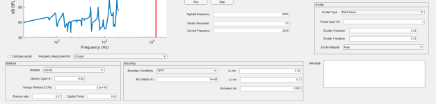

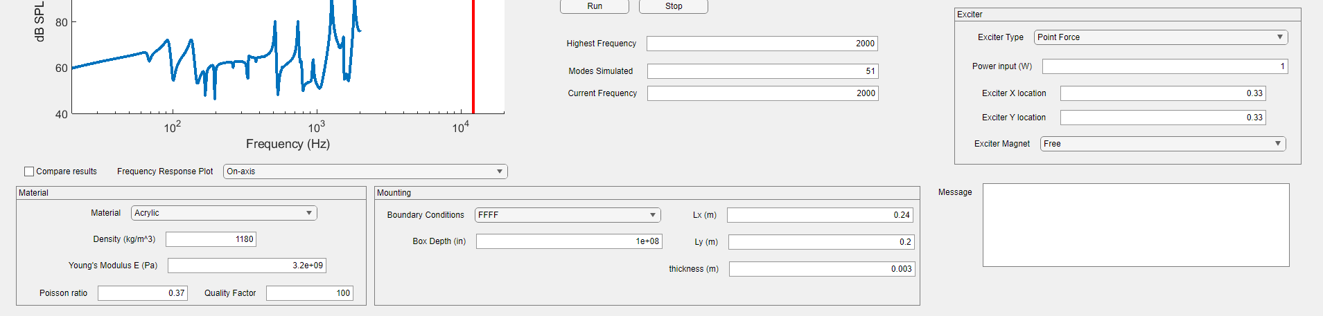

If you want to reproduce this test exactly, I used:
Acrylic properties, but Q=100.
0.24 x 0.20 x 0.003 panel dims.
Eric

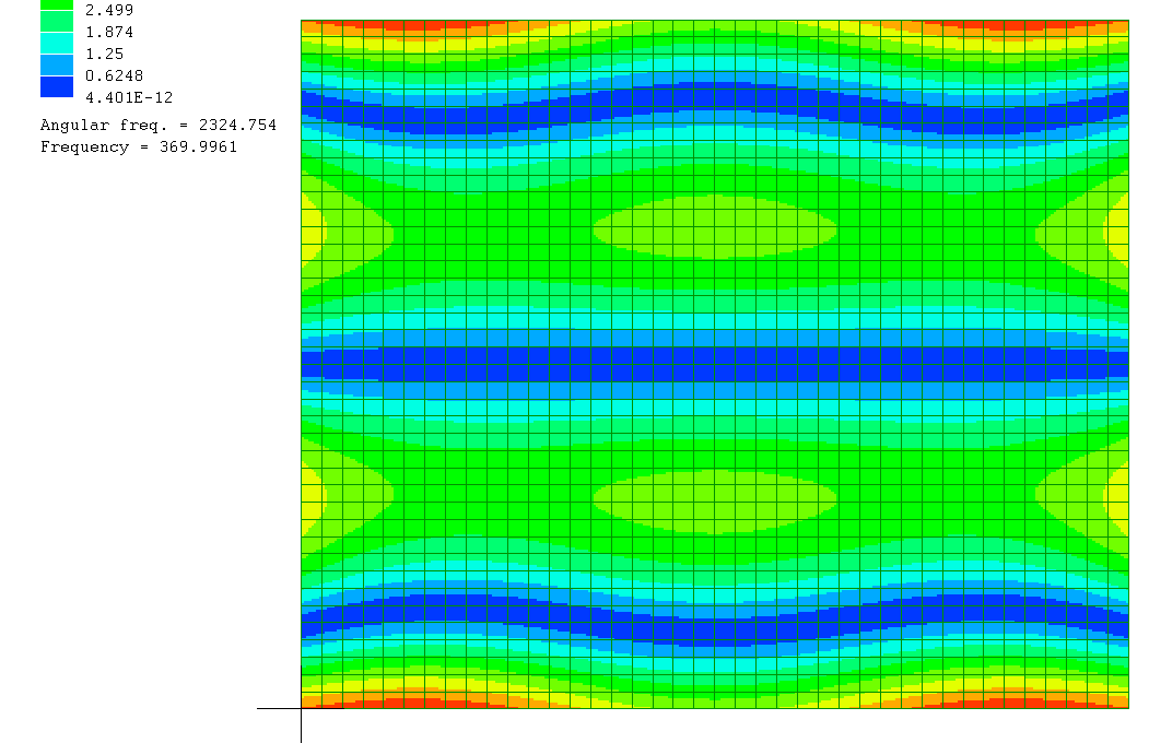

As you probably suspected would be the case, I found the same issue with version 1.3 regarding the funky FFFF mode shapes. Here's another one (same model parameters).

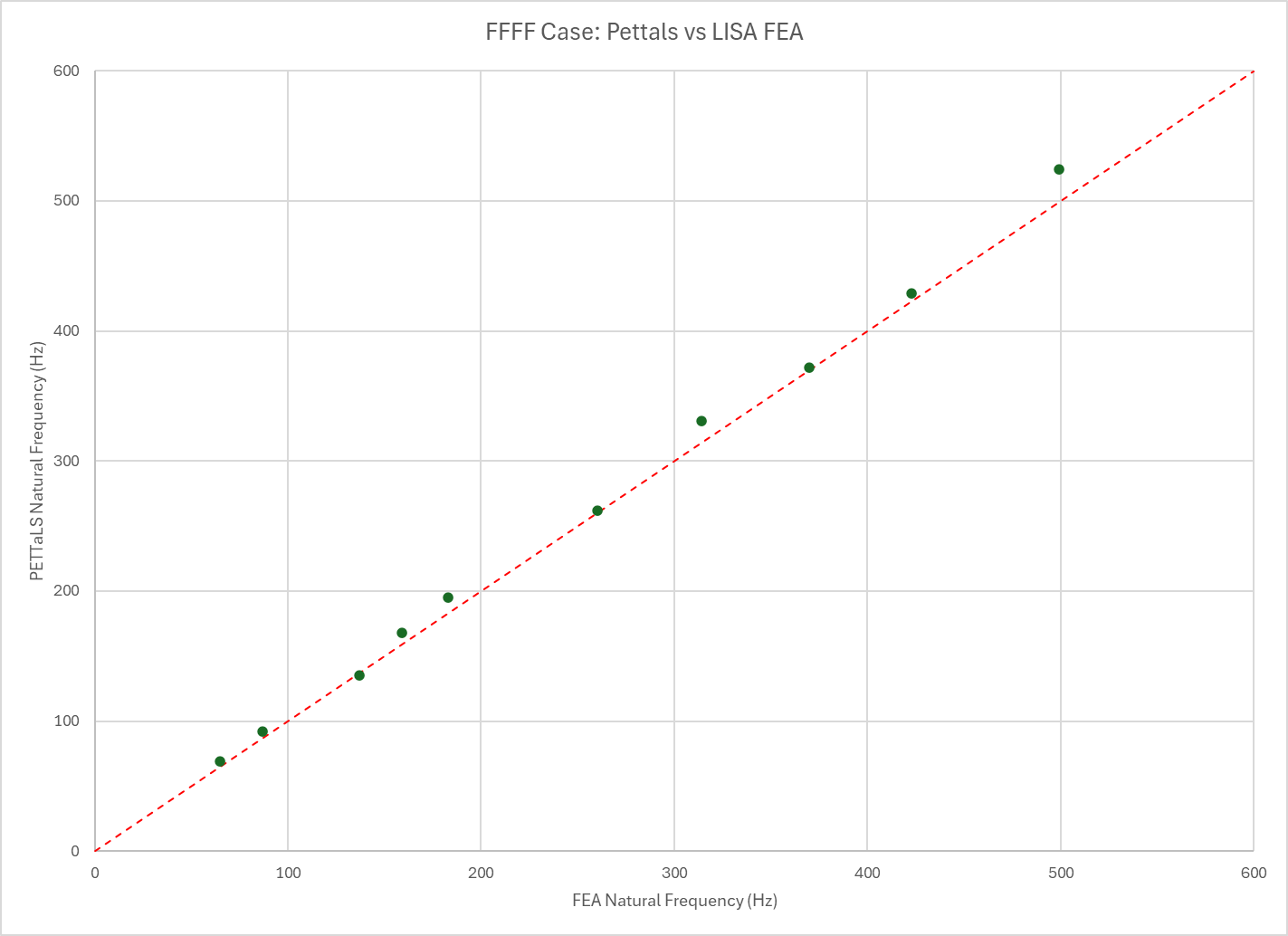

Here also is the comparison of the FFFF modal frequencies for FEA compared to Pettals. They are not as close as in the case of SSSS. For SSSS the greatest disparity I saw was under 2%. For FFFF it is as much as about 6%. The greatest disparity is in the lowest modes, where 5 of the 7 lowest modes are about 5 to 7% higher frequency in Pettals compared to the FEA. I don't have a guess as to the reason for that. I think it is independent of the mode shape issue, since the two lowest "funky" modes occur at 262 and 272 Hz, where the agreement between the two models is actually very close.

Free square plates have some fun mode shapes that are sensitive to the Poisson's ratio, so I ws going to look at that too. But before I really got to that, I found this other funky mode shape (using the same panel as before but 0.24 x 0.24 m size). But I'm pretty sure this shape violates conservation of momentum,
I think I'll stop disparaging your FFFF model now (sorry).

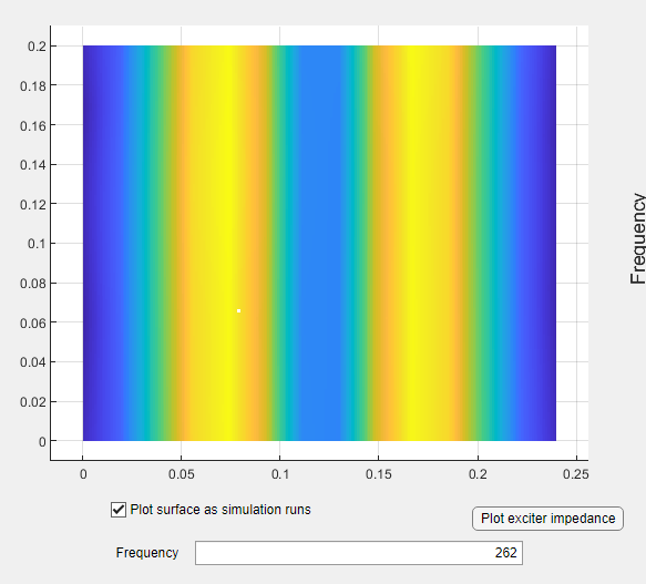

Oh good lord - I think the issue was just an errant minus sign in the code. (There's a lot of code, in my defense!)@EarthTonesElectronics
Dave,
Eric
Using your simulation parameters, here's a new 262 Hz shape:
Here's 377 Hz:
Here's the new impedance:
You're right that this issue was totally independent of the resonant frequencies. It's unlikely that this issue will have any effect on the coupled resonances since it was done with a point force, but there could be a tiny effect.
I don't see any issues with the frequency calculations - it could just be that the analytical expressions are less accurate for the free edges than for the clamped or simply supported edges, but I'll keep looking into it.
