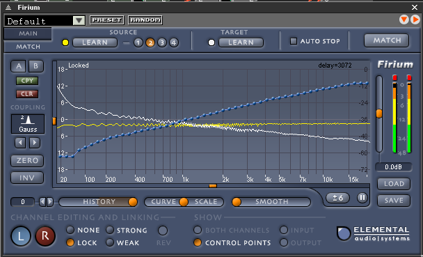

Damn these FIR filters are addictive, started looking at prices for the Antelope Isochrone OCX - methinks I'll have to save for that one.

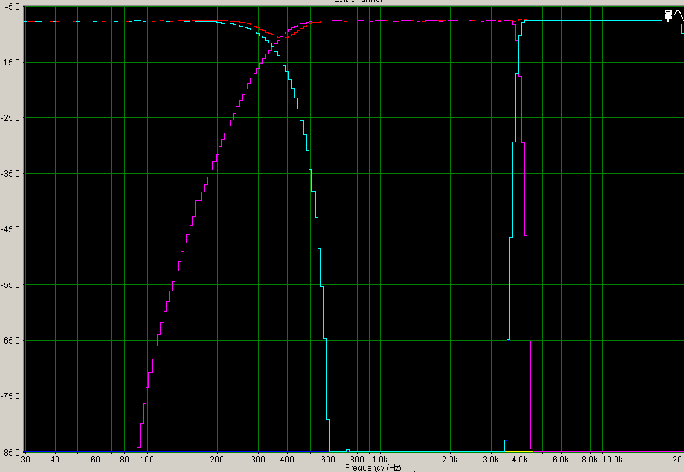

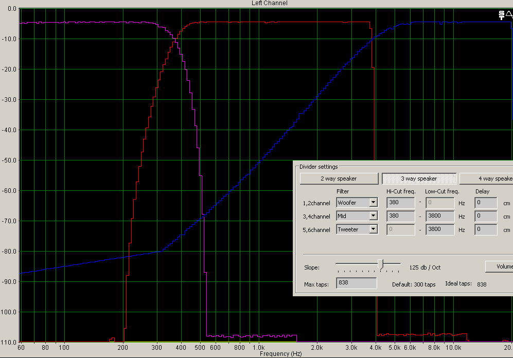

So what is your final solution for your crossover?
Did you get a satisfactory solution to work with TV and DVD-video? If so could you highlight your solution.

mbutzkies said:So what is your final solution for your crossover?
Yes TV, DVD and gaming all work very nicely. The only problems encountered were CPU usage. With all the option such as FIR filters time alignment and DRC it floats at around 20% which doesn't sound like much but I use heavy post processing of the video in Theatertek and with these options enabled I get some dropped frames on occasion.
Gaming again runs slower than without the XO, not hugely but I like it to be as fast as possible.
This will all be solved soon enough when I move out the XO tasks to a dedicated high powered machine for low latency <20ms.
The software setup I use is very similar to Vil's: Console as the plugin host with Waves Linear Phase EQ for FIR crossovers, Voxengo Curve EQ for the DRC and Voxengo Delay for the time/phase alignment.
On the hardware side I use an RME HDSP 9632 sound card and ASIO 2.0.
In the future when I have finished these I'm looking at upgrading my master clock to the Antelope Isochrone OCX. But at the moment I'm very happy.

I do have measurement software and I will post some graphs etc. after I get all the drivers back in the finished cabinets.

Vil & Ryan,
Voxengo curveEQ is giving me hassle in console.
CPU usage is around 20% and I'm getting 2-3second dropout in audio every 30 second or so.
I've tried removing Waves LineEQ's to lower the CPU usage to around 5% but it still does this!
This is with just plain old audio routed from the RME using internal loopback, everything works fine if I remove the CurveEQ plugin.
Any thoughts?
